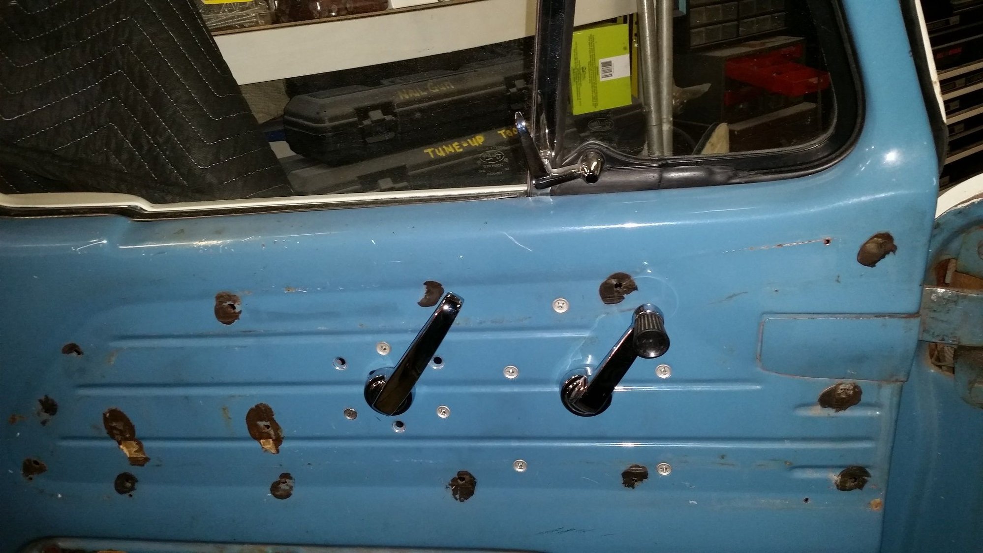

I'm about to install my door handles on my '66 and see, I assume, from the factory pictures and other images the handle pointing down. My '67 had it at about the 3 or 9 position (depending on the side you looked at) and my '56 had them at the 2 or 10 position. It's been a while since they were on, but is there some logic behind it being at 6 o-clock as opposed to maybe the 2 o-clock or 12 noon - or some other position? I just think they look odd facing down. Were people falling out of the truck so they moved it to where you had less chance of bumping it? I am a bit different (or at least that's what I'm told) so I may do it my own way unless others can tell me why I shouldn't.

Played with it all some last night. Have not installed all the arm rest and panel bits yet, but it does seem odd facing downward - though I guess anything can be gotten used to.
I drove my '56 for almost 30 years and that's hard memory to get around. It seems they would have been the same and that's when I started looking at pictures. If I mounted the 66 like my 56 I'd always be doing it backwards, which is why I was so interested in the reasoning aspect of the change.
I guess I shouldn't have expected anyone to really know why Ford did what they did, though I agree the pull to open and push to lock makes sense. Because I'm an odd duck I might flip the door mechanism. If I made new holes in the door (- and I might -) to have the handle face upward and pull open and push lock.

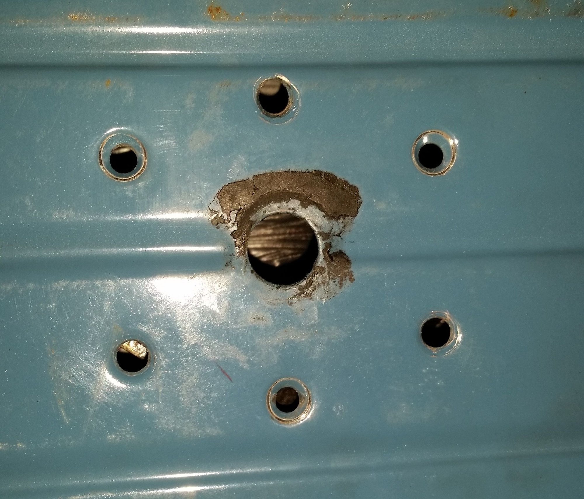

After putting in new weatherstripping on the doors today I decided - ah what the heck, let's see what it takes to flip these things.
25 minutes or there abouts.
I already replaced the door latch controls on both sides so I loosened them, used one of the old ones to mark upside down holes, drilled to 1/4", used a 1/4" countersunk screw, 1/2" tube and 1/4" nut to make new countersunk door holes - and wah-lah.
Feels far more "normal" to me now. Didn't make me more normal though.
