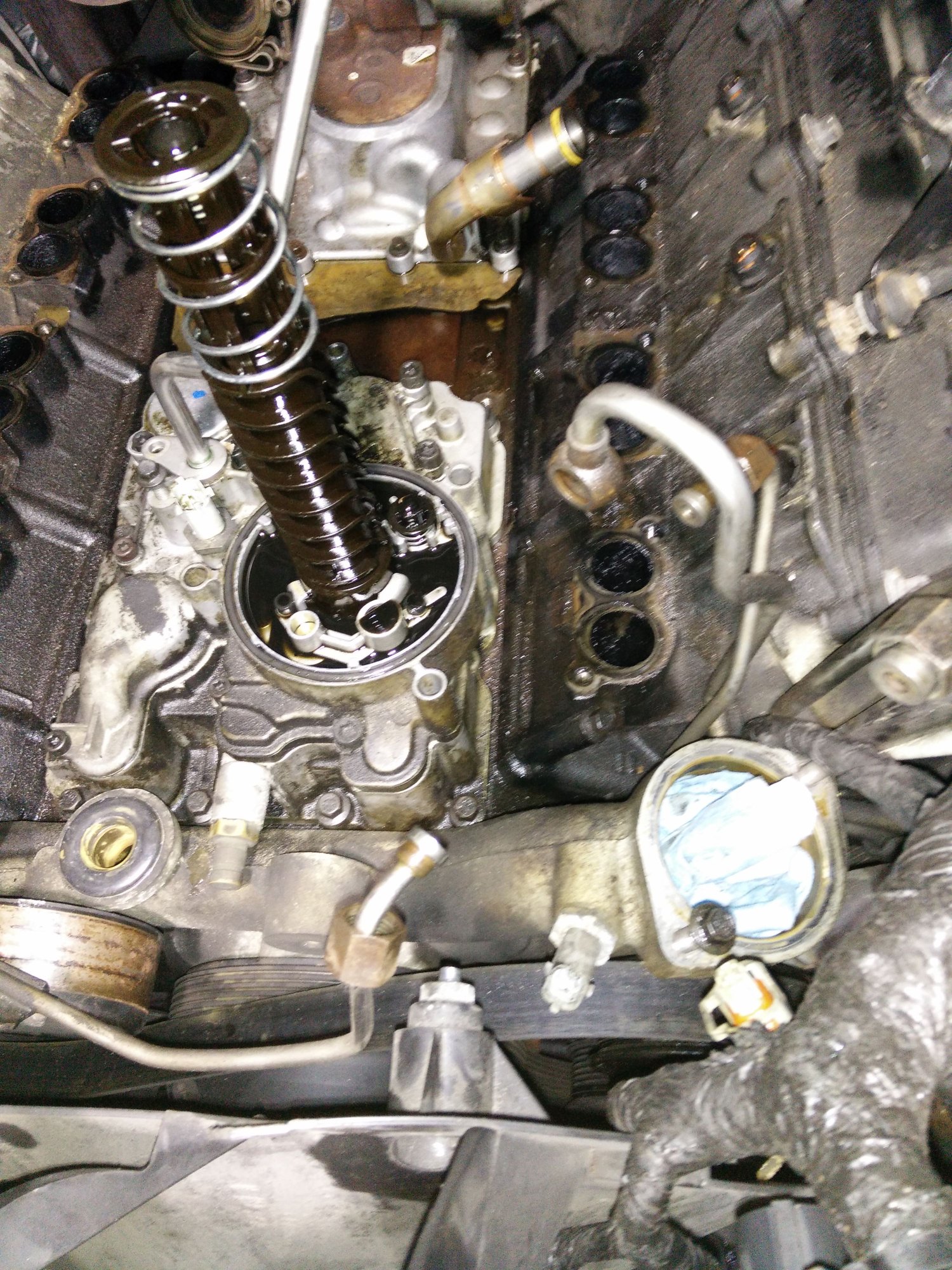

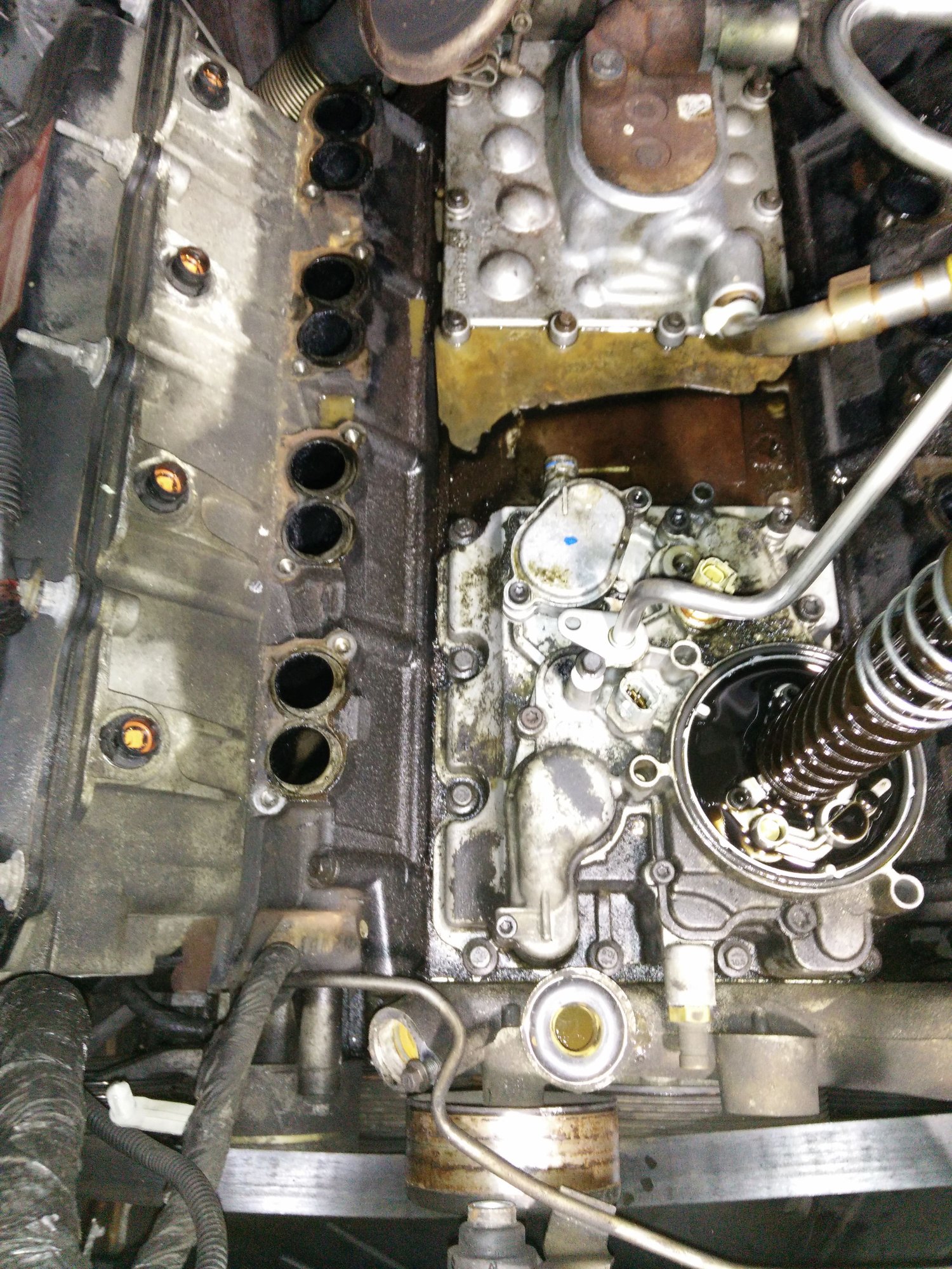

As far as the oil leak goes; work took me overseas for most of the summer so the truck sat untouched since my last update until late August. I ended up pulling the intake and then oil cooler cover. The o-ring was pretty hard so I got a new OEM oil cooler seal kit and installed it. While the intake was off I scraped about 1/2 cup of black goo out of it then ended up pressure washing it out, then decided I really didn't want to put the EGR cooler back in so I got a delete kit from Alpha Dog through Amazon. Doing it over again I'd have gotten one that doesn't replace the up-pipe and instead puts a plug/plate in the EGR cooler port on the up pipe. Put everything back together and no more oil leak, however the new up pipe was leaking at the manifold connection. Through this process I realized that the last person to wok on the truck had left the up pipe bolts loose at both manifolds, so I've been leaking exhaust from day 1. After a few iterations of removing the up pipe bolts and the v-band clamp on the turbo (lots of fun), I was able to clean up the face of the exhaust connections and with a little bit of exhaust sealer no more exhaust leaks.
Now for some pics...
The o-ring I believe was leaking (new vs old):
O-ring against the block:
Finally got to drive it 5 miles today, the brakes where quite rusty, but they should clean up fairly quick. Thanks everyone for the help!
