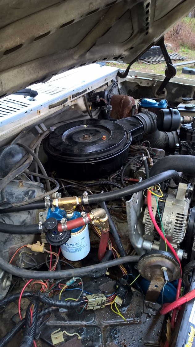

Hehe, yeah i figured it out, don't quite remember the details, but found a picture of it back in with fresh blue paint later that year (bottom right, behind horn).
