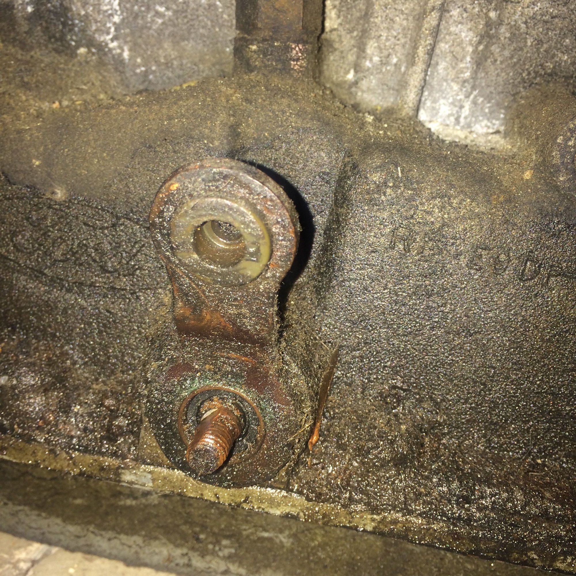

I would say go get the parts you need from a salvage yard.
But be careful the nut can brake off the TV shaft and then you have to drop the pan to replace it.
Do not ask how I know that.

The arm that connects to the bottom of this <br/>Sorry not good at explaining it

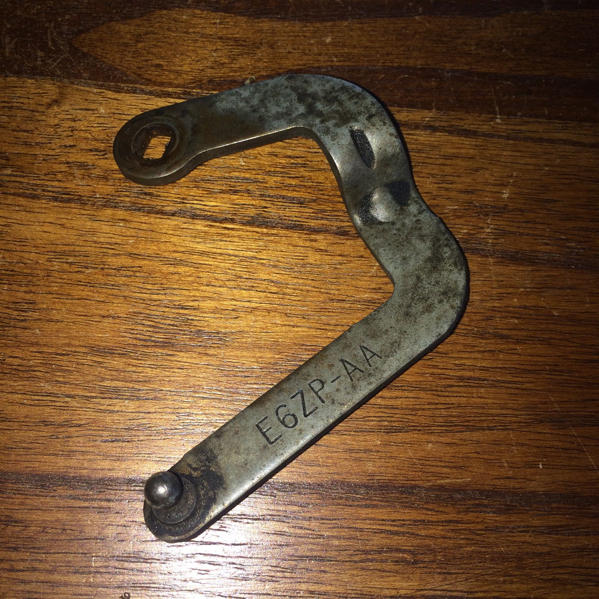

This is the part I need but I don't know what it's called

The photo says it is called a Transmission TV Control Lever.

Are the levers all the same weather it's for a car or a truck ?
Or would I need to get one for a truck only . I see they have lots for sale for mustangs . So just wondering

I know they are different between the E-series and the F-series.

TV=Throttle Valve.......Lever
See http://www.ebay.com/itm/like/321638509249?item=321638509249&lgeo=1&vectorid=229466&rmvSB=true
