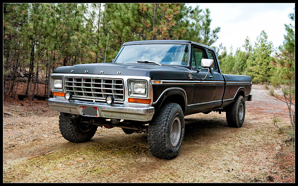

Hey everyone this is my first real post to this fourm since I bought the truck (Black Betty) you see below. It's titled at a '75 but upon further inspection I think it's a '76 with a '75 cab. It has an open universal front axle, the support rod on the transfer case and obviously the '76 front grille inserts. It has a 400 and a 4 speed. When I first bought the truck in December it was almost undrivable. It would pop and bag out of nowhere and had little to no power. I immediately assumed the carb was at least in need of rebuilding. .since it had the original 2 barrel carb I oped to get a new Edelbrock performer 400 intake managed and a Holley 670 Street Avenger. Once I received all of my new parts I immediately started tearing Tito the truck methodically removing parts until I got to the intake. Once I removed the stock intake I found three push rods and two lifters laying in the bottom the valley. A trip to my local Napa ford that they only had one pushrods and three lifters. A roll check down the hood of the truck reviled that I only bent one pushrod. I put it all back together it fired up on the fist hit and idled like a brand new car. I can't complain. Sometime inbetween ordering my new parts and receiving them I was taking the truck out for a ride when I was down shifting for a red light when my reared locked up out of nowhere. I had it sent to my local 4x4 shop where they found that one of my pinion nuts had backed off and broke a couple of teeth on my ring gear. While they had it open I had them install a limited slip because I do plan on doing some light wheeling with this truck. My next project it going to be to rewire the whole truck because I'm truly afraid that I'm going to start the truck and it's going to erupt into a ball of flames. I Plan on buying a painless kit with switches. If anyone has installed this kit please share your experience. This is the first post of May with my long journey with Black Betty. Thanks for your time.
