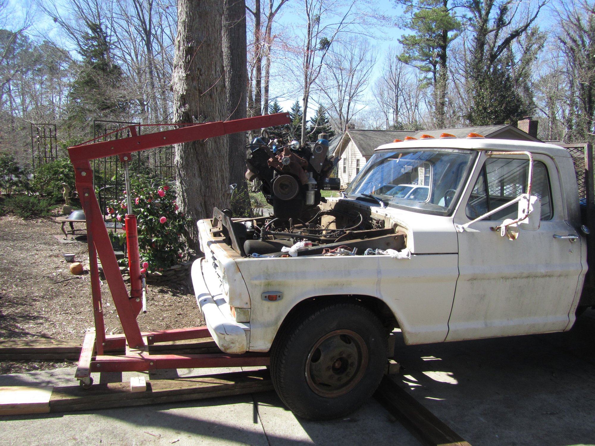

I need to get creative to get my engine hoist to clear the bay so I can pull my 360 out. I'm thinking about getting an Engine Lift Plate so I can get the crane as close to the block as possible. Anyone try this with an FE? I've done it with small blocks but not an FE.

Chains across the intake bolts won't work?

No I have not but I'd prolly pull the whole front dog house off. That way you can lift the engine just a little and pull it forward. Remember Hio's idea of 1/8" locator holes in the hood hinges etc so you can mount it all right back in the same spot afterwards. And Jackson did a good job in his thread showing where all the bolts are to be taken out. Don't forget to suspend the front of the tranny when you separate it and the engine. New clutch time?

I've used an engine plate multiple times with no issues

I just removed my 360 and trans with a lift plate. No problem at all!

Engine lift plate on a 360 is no problem. Do yourself a favour and pull the whole front clip off. If you want I can post the picture of where the bolt locations are.

I removed the tranny bolts on the NP435 and hooked the cherry picker chains to the intake bolts and went nice and easy. Had to remove the hood. Someone stood by the windshield wipers and had to push the end away from the transmission with there legs (while the cherry picker was lifting) to unmount the engine from the transmission. Put a new clutch on the new 360 and dropped it in and married it to the NP435 the same way. Never pulling the trans. Pulling the hood was a must. Other than that, it was very smooth.

Mission accomplished like this:
Out with the tired.
The offending freeze plug, or lack thereof. Apparently I also need a new motor mount.
Plenty of dishes to wash. So that's where all the 50W went...

The motor about bent my HD engine stand in half, so I stripped it down to the short block. Cylinders look good. I'll get the rotating assembly out tonight and start mic'ing the holes to see what the next step is going to be. Also I could only get three of the four mounts to reach the bell mounts so I'll be modifying that thing while the block is out getting hot tanked. The whole lower part of the water jacket is filled with sludge. I texted my buddy Butch "The Eagle is unbolted" and the next day a bald eagle flew up my street about 12 foot off the ground. Another buddy, Quinn helped in the removal and tear down yesterday. Thanks guys! I'm trying to get this thing done quick because I have mulch to haul for the wife. It's pretty messy and I will be going through the tranny too.
