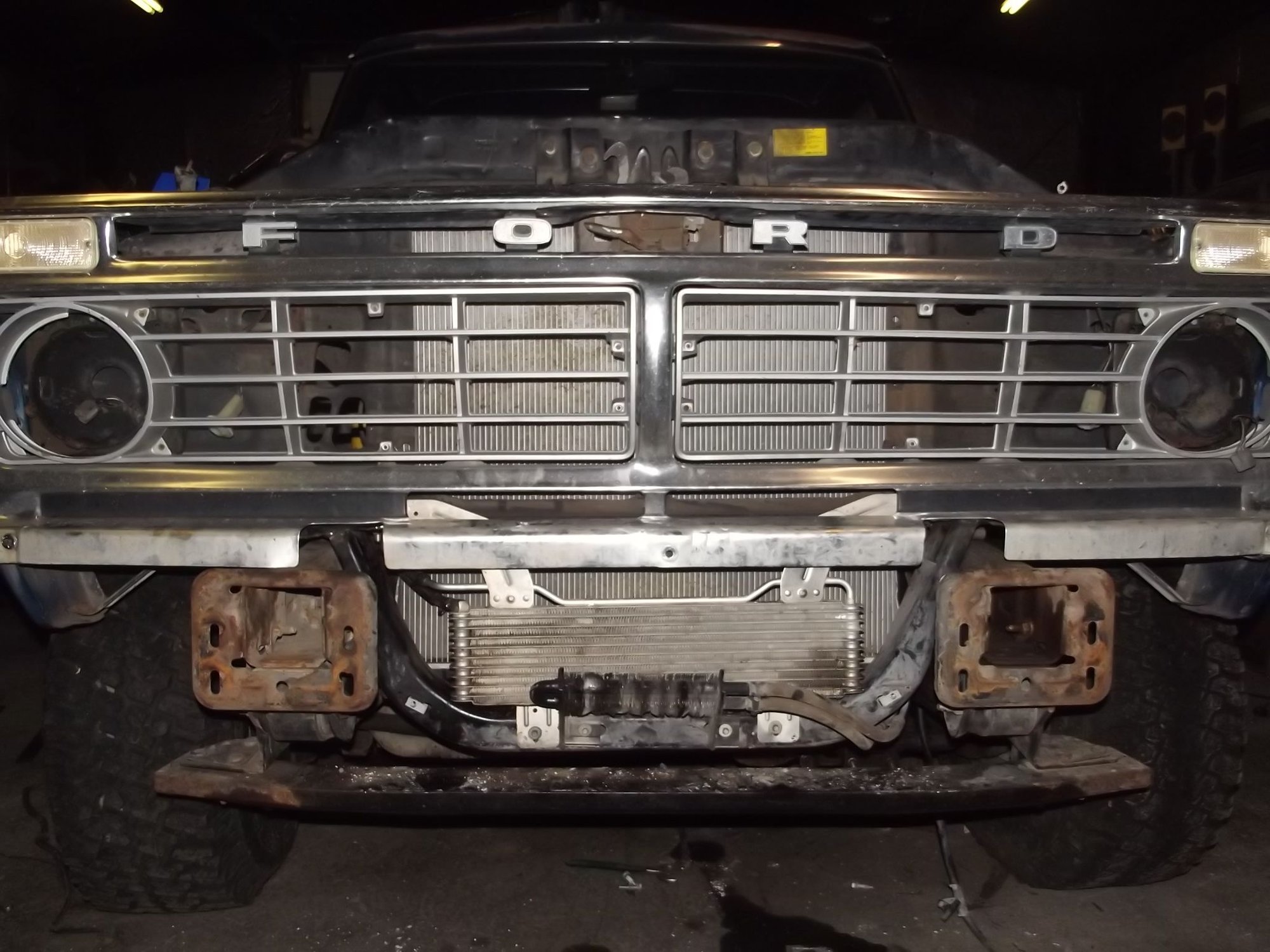

Just some more random stuff that I took before finishing things up under the hood. The underhood wiring has been done and the present project is intercooling. I have the custom intercooler mounted (Tugly mentioned a shoehorn) and believe it when I tell you that I don't have to modify the stock SuperDuty intercooler pipes AT ALL to make either one work.....
Firewall:
Hydroboost:
2002 lower core support attached to the 1973 core support and coolers installed:
Stock fan and shroud:
The ONLY reason I kept the ABS module was to supply a VSS signal to three other modules.....Stupid engineers.
