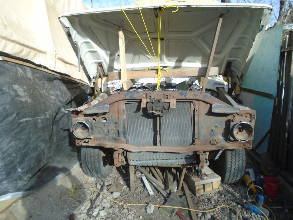

So, I get the front clip off and window out of Katy on a windy day. Up here we get this wild spring wind that changes directions, long story short is it almost drops the main shelter and I wind up spending 2 days fixing and reinforcing it and the 3rd day I made a new end wall for it. Had some stitching to do on a heavy duty truck tarp and hoisted it up. What a pita these truck tarps can be, especially when your working off a ladder with a tarp thats as heavy as I am, but it's up. My mods to the shelters are mostly done and all I need to do is make a walk through and end walls.
As some as you know, there was a drunk that ran into my truck as it was parked up front. All peril insurance apparently means that I have to be in the vehicle with it running or the vehicle has to be inside my lotlines if it is parked in order to be covered by my insurance in case of collision. Luckily the drunk has collision on his truck and his insurance has to pay out. I'm going to write off the truck and buy it back and hopefully it wont even get moved from the spot it's parked in. Cannot reinsure it if I do this so I guess I'm looking for another truck.
It would appear he hit me so hard it knocked the face off of it, good thing I had a spare truck face.
Before
During
After, I was getting hungry and figured that I would do the lights, grill panels and rewire the fenders tomorrow. I still need to break down the other clip and salvage the fenders plus I changed my mind on the rad support and use this one on Katy. The rad mount is different and I need to weld in the radiator brackets from Katy onto this one. So now all my striped down rusty parts are on the green truck where they were going wind up anyhow, just need to get the brand new tinted window out without breaking it. Good thing I have a cracked window in my 78 to practice on. The adventure continues Remo.

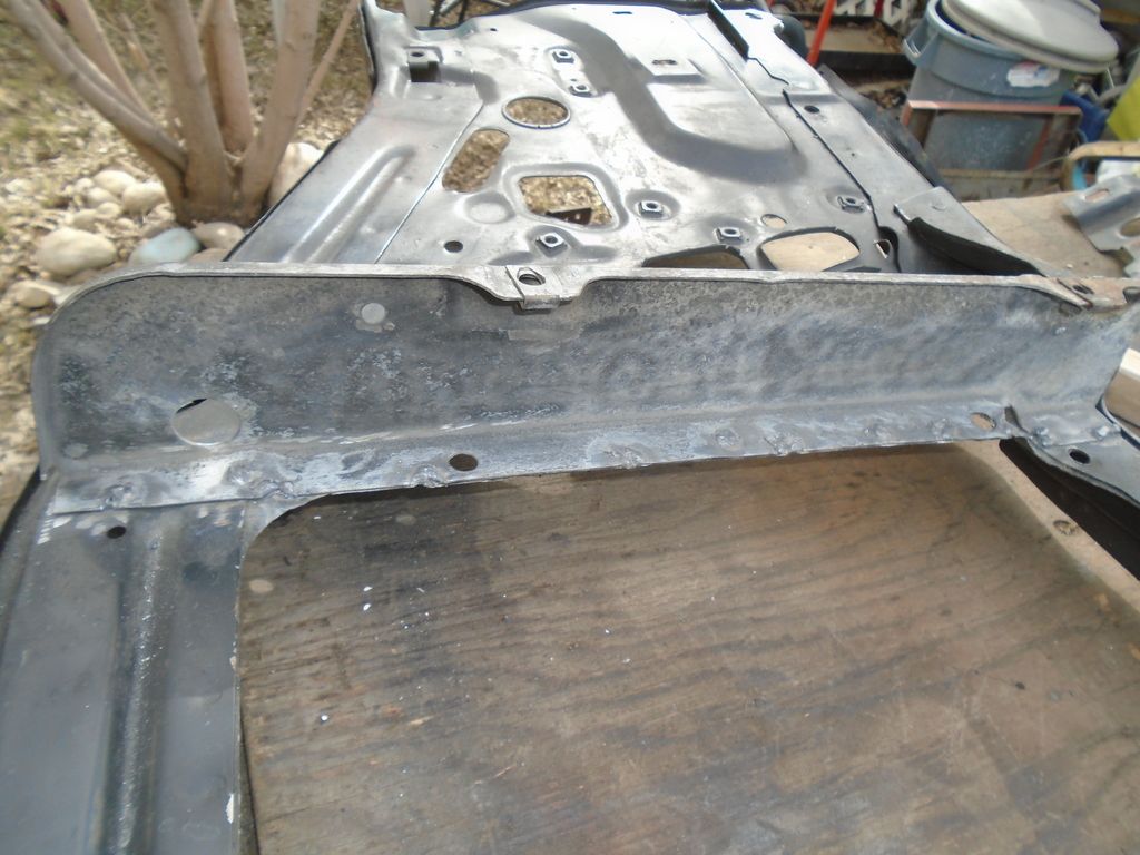

Heres something that might be of interest to the 4x4 crowd or those that bang their fenders up a lot. This support brace was on the driverside fender only, nifty idea.

That fender brace usually only comes on F-350s as far as I've seen and they are Very difficult to find. I've been looking for a pair f them for 2 years now.

I thought the brace was a PO idea as he had a couple of 4x4's, had 3 350 duallies and they had the hinge bar on the hood but no fender brace, makes sense as this is a 350 srw. I'll pop it off if your interested Odd, postal code is T2B-2K1 if you want to find out shipping costs, will trade. I'm a think on my feet capitalist 1995 and I could smell a benefit from this, although when I saw that it was a white gm with a ladder on it I thought it was my drunk nieghbour Ken, sure was p'od for a minute. Got a line on a 93 f150 with a burgandy bucket console combo, would look nice in Katy as it's going black with wide white bandaid strips and white race track. Can't wait to get a full day in doing the body work, I'd be able to see her getting back together again. No doors, fenders, rad support, bumper or box on it or a front window in it. Wait to you see how rusty the roof is yet no rust in window frame or rain gutter. Put a 4" gouge in front of lower leg lifting off clip, couldn't get pick of styrofoam on 2 wheel cart and 7' 2x3 through the hinge braces, its how I moved the clip 40', yes I cheat. LOL

So, the clip from the green truck is all apart and my side distractions are wrapped up for now and we got weather thats strong enough for me to do some mid day painting. Time to get something done on Katy and maybe get caught up a bit. Been doing the detail on the front end pieces and those areas you dont really see, the time wasters that have to be done. Tomorrow I get to do some assembly and start on the cab body work ie door jambs and fire wall transistion, with luck I'll get started on my rusty as all hell roof. When I popped out the window I was expecting the jamb to be rusted out but it's the only area thats rust free, blessings in disguise. The pics look like I haven't done squat but as you all know, rebuilding these trucks becomes a production line job at a certain point in time.
Had to change the rad support brackets over from the 79 support in order to remount the rad. Twas the reason I couldn't use the rad support from the 78.
put rust converter on to save me sanding time, use 2 types, brush on when I can and spray on for panels or to save time. This stuff comes in so handy and saves a lot of work if your not doing a full fledged rebuild but want to make it sellable in a years time.
shiny and loose bolted on so that I can star lining everything up tomorrow
Painted the hinges while off so that I could get all the blind areas covered so that when I paint the door jamb tomorrow I'm not chasing white spots. The doors take 4 days to get done when you take in drying time, rocker guard, black, white and clear coat plus the day of body work. I like my body work to sit for a day and harden up before I start coating it. Thats why I stage my jobs into a production line, should start seeing results by the weekend and if the weather holds I might have it in paint by next weekend, guess I should dig out the air compressor, paint gun and maybe buy 2 quarts of black and 1 of white soon and maybe even some clear coat so that the paint don't fall off. Time to start a pool as to how long after each color, and clearcoat, that it takes Sally to walk on the truck and leave a set of paw prints behind. before I forget, the adjuster was down today and it looks like he's going to buy me out and I keep the truck, problem though, the frame rail has a small buckle in the side at the end of the rail and that might take it off the road. It's in the last 2 inches of the frame rail at the point of impact, I may be able to cut off the last 2" and remount a bumper or maybe they'll let it slide, who knows. Won't find out for a week probably. The driver never got charged with drunk driving, nieghbour is shocked as both officers commented on how drunk he was and he reeked of beer, neighbours are from Ontario where you don't get away with that crap like you do here. Here killing a sober family of 5 in a minivan while driving a cement truck drunk gets you 5years out in 21 months. Killing 4 sober members of the front line of the local highschool football team gets you 3 years if you slowed down from 90mph to 75 before you hit them, oh yeah you gotta be drunk for that. Killing your drunk passenger buddy by hitting a parked vehicle while drunk gets you 11 years. your getting the gist, sorry about the rant but friends of mine have been killed by drunk drivers. Drink if you want but find someone sober to drive you home or walk.
