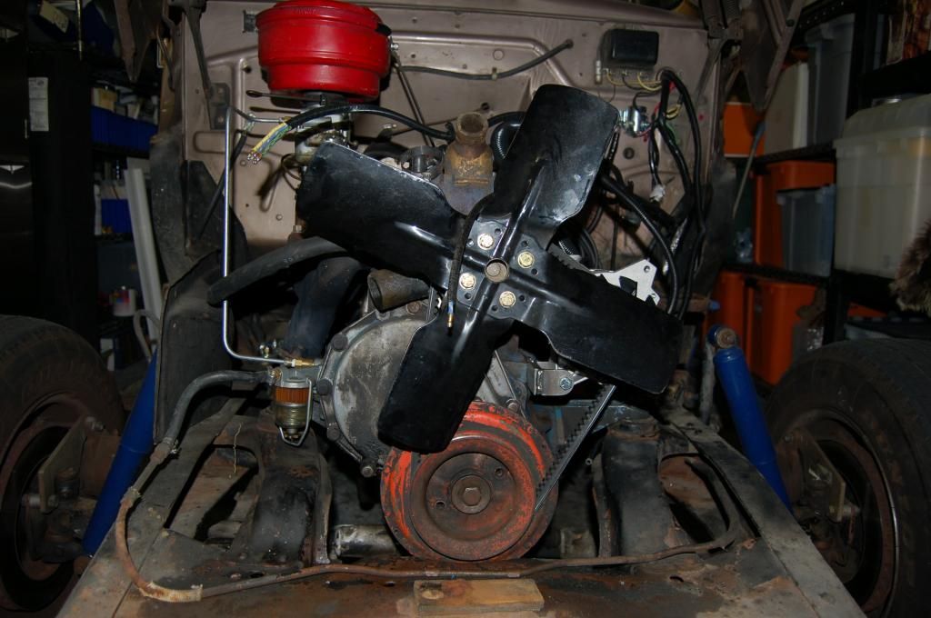

Just an update and a question. Since the truck has not been wanting to start since October I finally decide the best thing to do was to remove the front lip so I could take a good look at the timing gear. Since I have it off I also plan on replacing the fuel line and cleaning up the engine.
Anyways I am assuming of the time gear did jump or slip (I tried timing it 20 times and its a no go!) that the timing marks located on bot of the gears will not match up??
Am I correct??
I was told that many of these were made of Fiber and that they are know to go out!
Thoughts??
