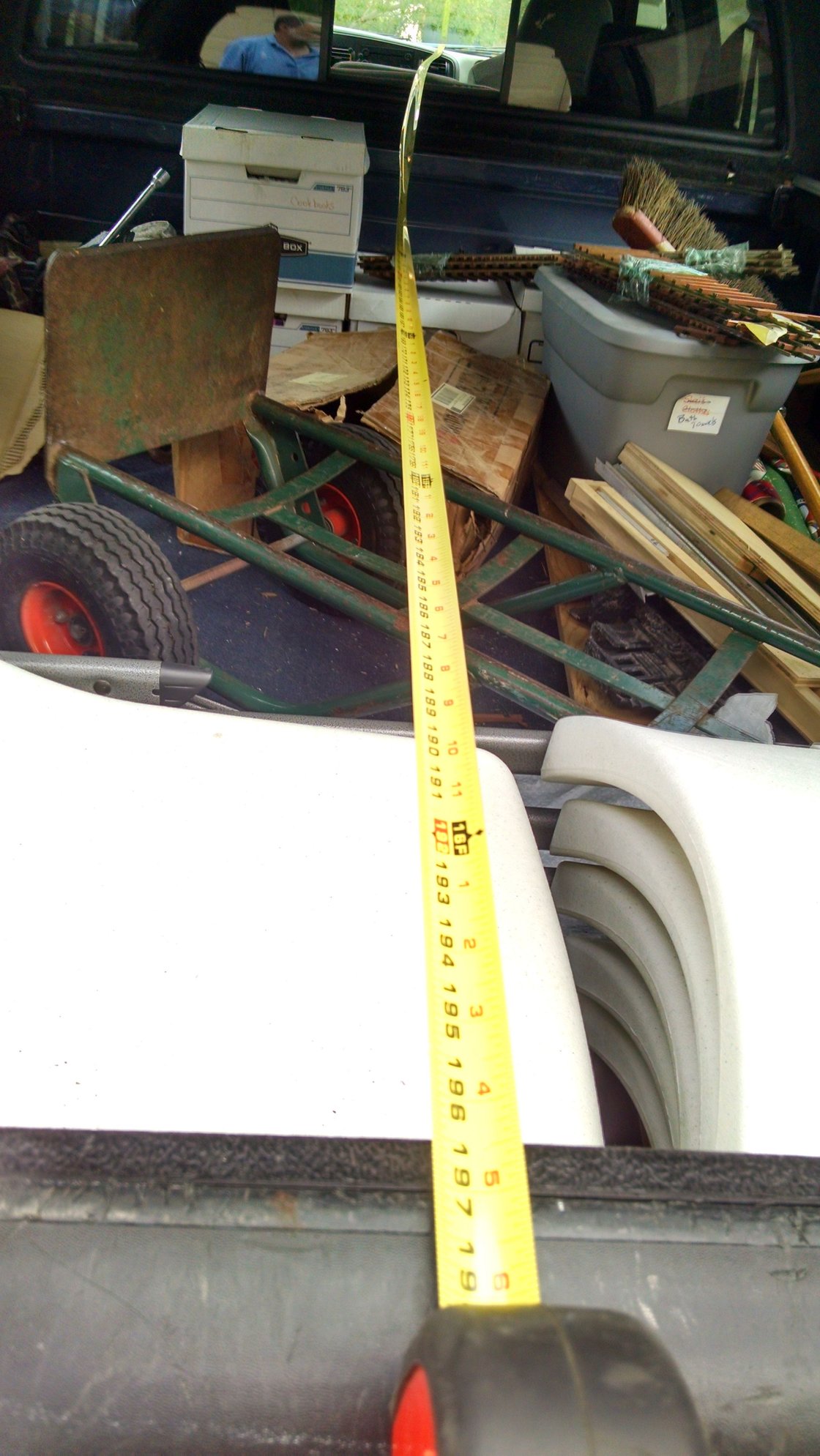

[QUOTE=jdadamsjr;14964639]Not being picky but you have a 16' bed ?!?
I would love a 16' bed, or even 10' but fyi If you open the sliding window on the cab you can put 16' lumber through it into the 8' long cab. 8' of bed + 8' of cab = 16' of cargo length as long as it fits through the window (196" in fact)
16+ feet from windshield to tailgate.
- excuse the mess in the back of my truck today, it's usually neater than this
