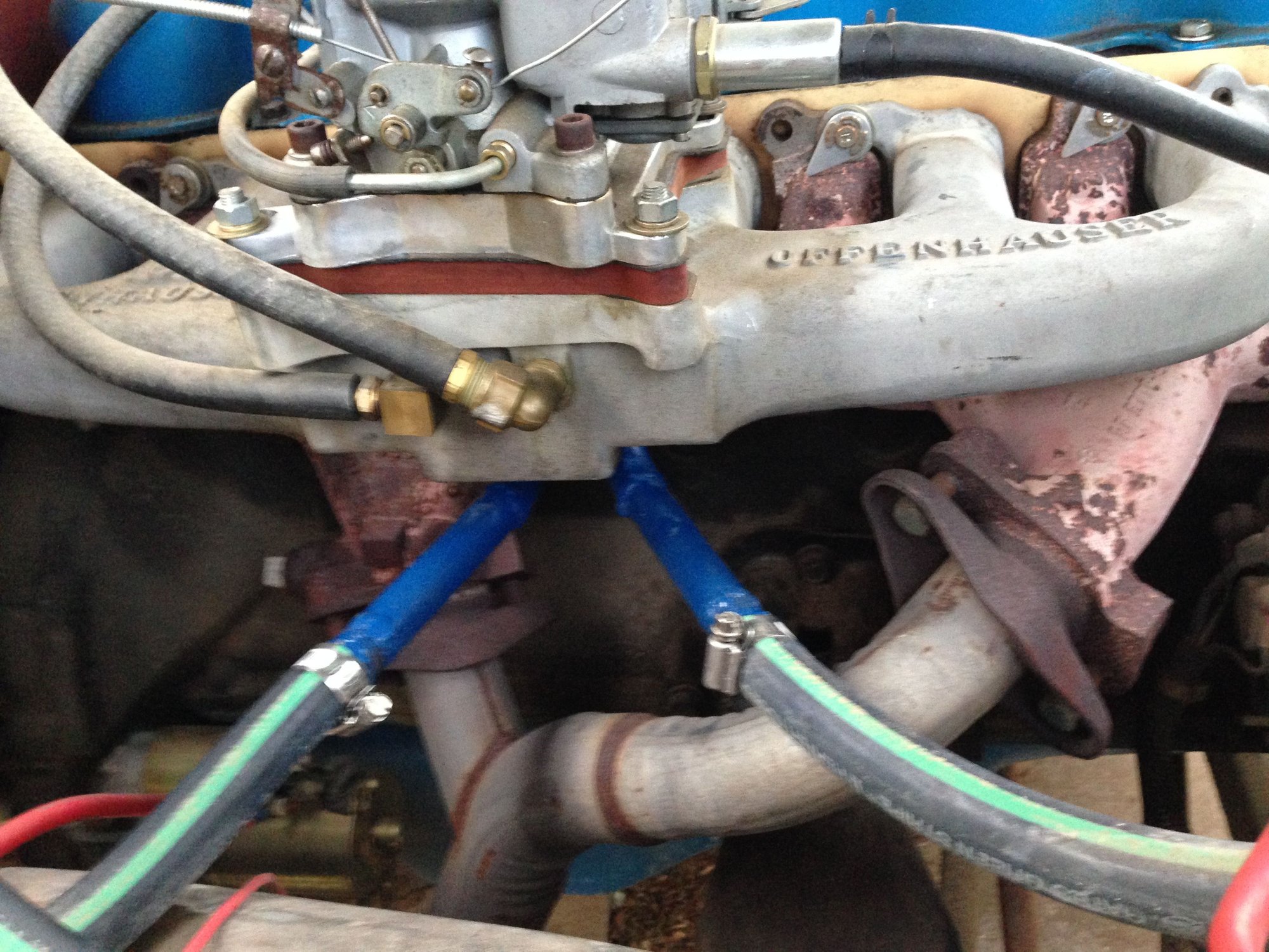

Originally Posted by philtug
I am planning on installing 4.9 injected exh manifolds with my offenhauser intake on my 77" I-6.Will this work. Also I would like to install a 94' 250 front end in my 77' . Will this fit my spring lay out ???
If I understand your first question correctly, you can install the efi manifolds on your I6. Here is is photo of my 78 I6 with this mod.
Old Dec 6, 2014 | 07:04 PM
HIO Silver's Avatar
HIO Silver
Joined: Dec 2009
Posts: 20,678
Likes: 82
From: NorCal
And make sure the outlet of each manifold actually merges to form a Y...
There was someone in here running EFI manifolds whose down pipe merged like a T which probably negated any gains by the swap. Remember, air flows like water so the less turbulence the better... air and water don't respond very well by having to make a 90° turn.
