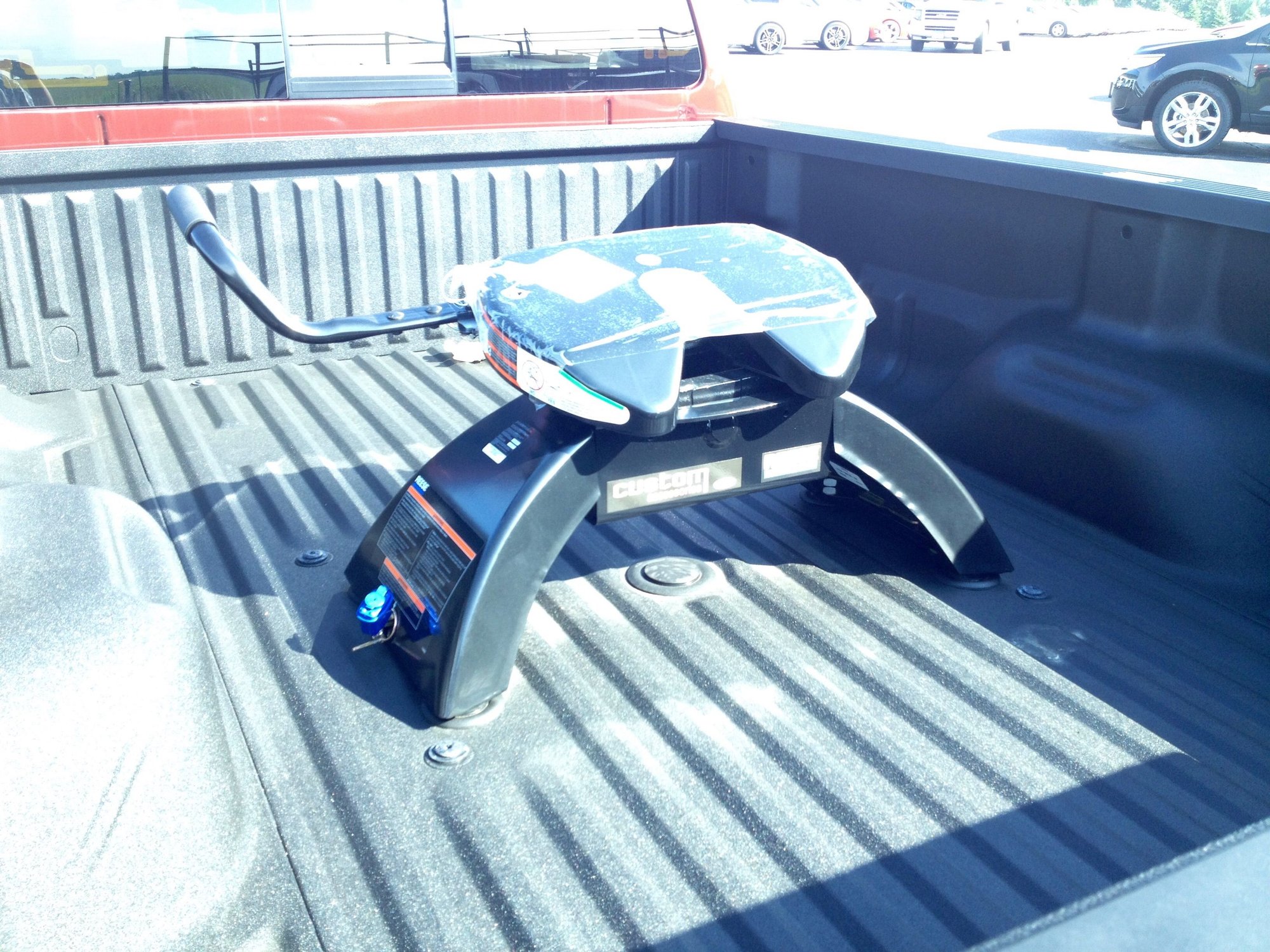

I bought the full meal deal from Ford on my rig... Probably paid too much for the hitch, but it is rated well over the 18k max weight of my trailer at 26.5k
Another positive on the Ford hitch is that they also wire in the plug in the side of the bed.
It was all plug and play for me..

I went with the same factory set up that Bigfoot (Randy) has pictured above. I've been towing fifth wheel trailers for about 12 years now, always had the rails mounted on the floor of the bed. My new truck is the first one I've ever had that will have a flat floor, 7-pin plug in bed, and a mounted hitch that I actually like. I always hated the set ups I had but just had to live with it. I actually like the new one so its a welcomed change for sure.
