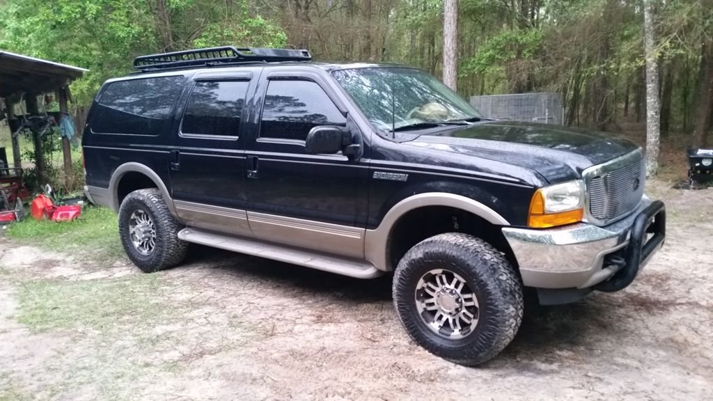

I got 25" all the way around with 3/4ths a mini spring pack in the front and RAS in the back. Still looks pretty good with 285's.
