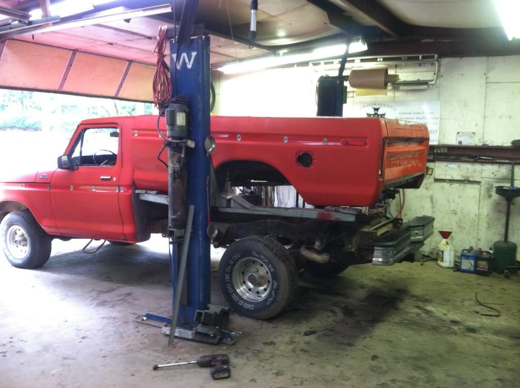

well finally been working on my old truck
guess first off a little history. My dad bought the truck new had 351m c6 3.50 gears and a track loc in the back the auto was pretty much the only option being as that he installed ac Later added the trim down the side of the dent when it got repainted in the early 80s. Then in 94 i got my license and got to drive this some when he didn't need it (was looking a little rough by then) Christmas of 95 we painted it red (was originally silver) so i had a nice truck to drive my senior year. jump to 04 he finally agreed to sell it to me and i used it as a work truck till bout 3 years ago when the engine got too tired to do much any more and parked it with un known plans
so now finally working on it will have prob 2" lift in front and a 4.6l 4vlave and a m5r2 5 speed just gonna be a fun truck now

few more pics

mock up stage of new motor

current plans are the m50d thats bolted to it now with the original 205 tcase if it gives trouble ill look for a zf5 but i like the gearing of the m5 better for a toy truck and it will have 4.10 gears when im done
and this prob will be a slow process took 2 months to get here with only bout 10 actual hours of work

tore completely down paint and refurb chassis. Then start on the body . I like the red but also like the original silver so undecided on that yet? but will have power windows and door locks maybe a newer cluster grafted in dash.
already has bucket seats from early 90s exporler with a 94 ish f series center console. They prob will be recovered before it goes back together.
and prob 17" rims with 285-70 tires think that covers most of it

haven't made very much progress lately. The engine mounts are built out of another set of 351m stands that I cut up. the new trans mount is almost done due to the trans being 4 1/2 " longer than the c6 . I ended up setting the engine bout 2" forward but since its so much shorter of an engine there still is alot of room between eng and radiator.
but unlucky for me without a body lift the brake booster hits the valve cover have a 3/4" spacer in body for now prob gonna try a different booster but also have a hydro boost from a mustang that may go on.
then its time to completely strip frame for blasting and paint then start the actual build
