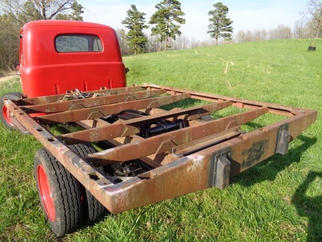

I worked on the bed today to get it ready to paint. I noticed that when I rebuilt it a few years ago, I was not aware that the subframe for the hoist was out of square. I worked on that today and test fitted it on the truck. I still have a little work to do, but here are some photos to prove that I did work on it.
Thanks, Mark

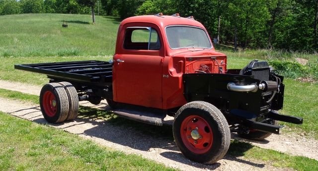

The bed, inner fenders, radiator frame, fan and fan shroud are back on. Hopefully for good. The bed is not very heavy, three of us picked it up off of the trailer and set it on the truck. It does ride better with the bed on. Adding the oak floor will help even more.
Thanks for looking, Mark
