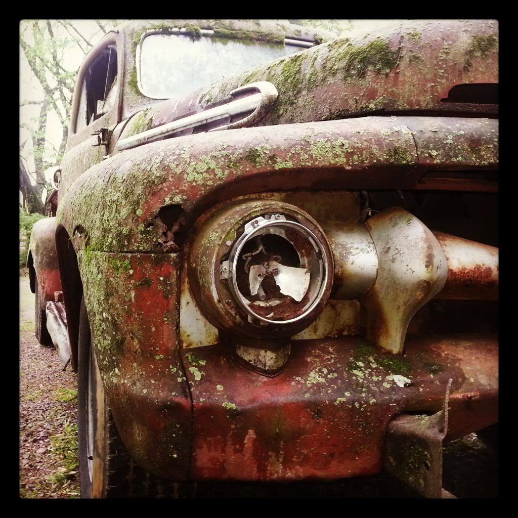

That picture of the passenger front fender is just plain GREAT !!
Greg M-47
Indeed it IS! Nice project and please keep us informed of your progress with many pics!

I see the mud on the '66 and on the tongue of the U-Haul. That F2 simply did not want a change of scenery.
The front bumper looks like it was pulled off by a force unknown to mankind. Like a UFO grabbed it from above. Gotta be a story behind that.

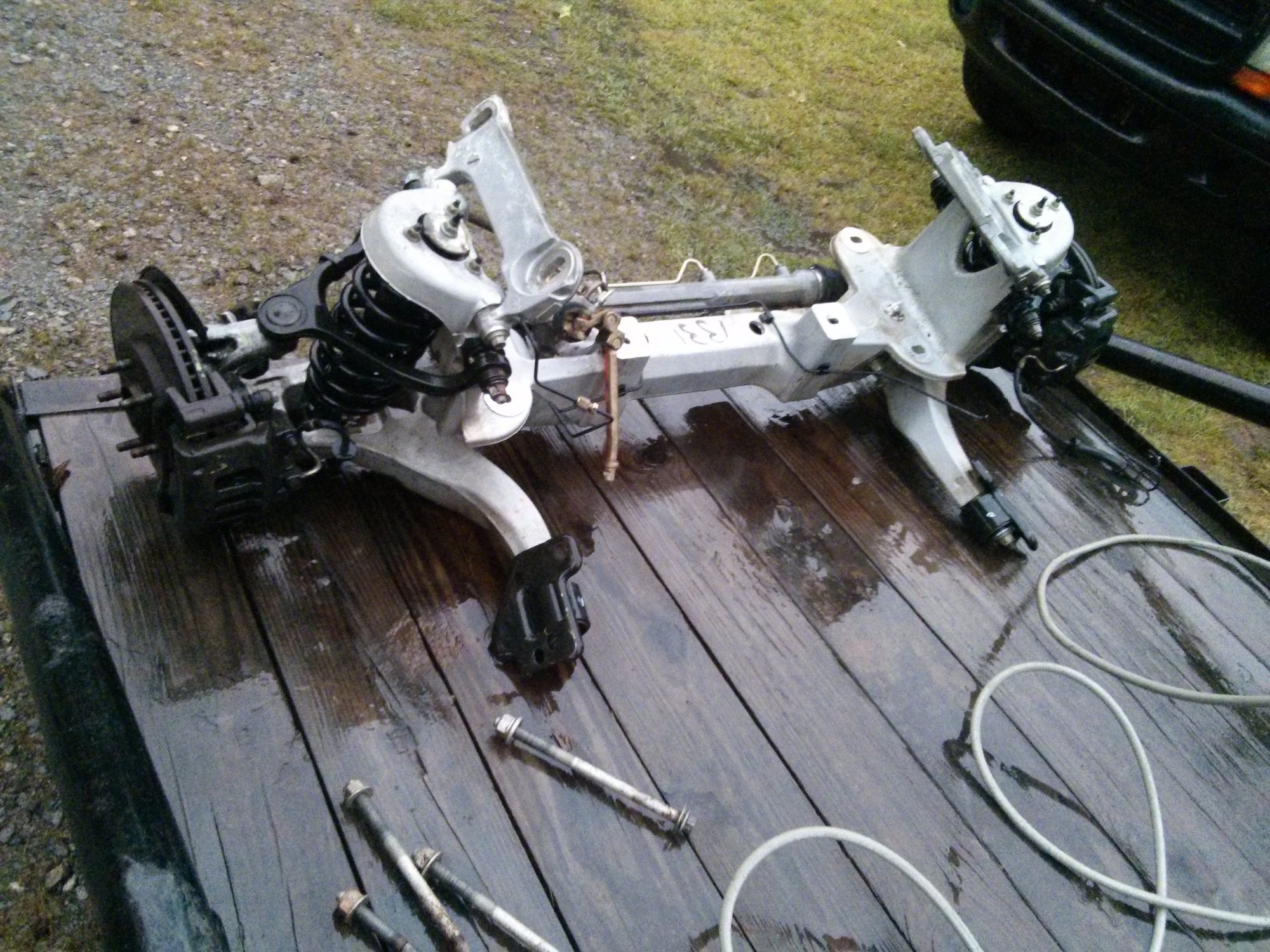

So after many weeks of no progress due to working too many hours, I put some effort the last few days into this.
Sold my old C10 for funds for this project.
I picked up a CV front suspension. $150 w/73k on it. Sadly the motor was already gone. I'd have put the 4.6 in the truck.
But my heart was set on either a big block Ford or a diesel. Due to people on CL being....well people on CL, I went to the local pick and pull. They were just about to lift a 91 F250 out and crush it, but the windshield had a note about the engine running but broken steering gear box. It had a 460. Missing most of the EFI crap. I figured swapping to a carb should be easy.
While at the yard I took an intake from 71 460, as it was for a 4bl. It fit kinda weird.
After reading up, it seems to make a carb intake work you need an adapter or something. Head shapes is slightly different. Can anyone clarify this? Likely wrong section of forum for that question.
As this is gonna be a Rat, I have no need for pretty or proper. Just functional. It looks like the adapter is just a set of spacer plates. I can make those myself for under the $350 they want.
On the CV front end, I can modify the front frame to fit the new sub frame or modify the sub-frame to fit the truck. My question is, will the wheels clear the fenders on the 3/4 ton as is? I can box out the frame very easily as the sub-frame would allow for at least 3 inches each side inwards, so the truck frame would not need to be cut. Just added to to make it wider. But as I want the truck stupid low, that may happen anyway.
I am still in search of a good 5 speed trans.
Also, I still need to locate a viable rear end. If I use the CV front end, I am debating on the simple 8.8 from the Mountaineer. $90 at local yard complete caliper to caliper. Many of those came with the LSD and I can pick the ratio I want for under $150. I'd like to have something rather high, for doing burnouts and ******tery on city streets, but not the stock 486..... which is going to be far too much. Besides, I have grown to like disk brakes and the thought of drums again..... but all this means I lose the 8 lug. I wanted a duelly rear.
If anyone in Tennessee happens to have a manual trans let me know. I live south of Nashville.
Greg M-47
Yes it is. It jumped right out at me. Awesome it is. Is what prize posters
and cover pic's are made from. If it was me I would seal the rights to it
because I think it will be used very often.
