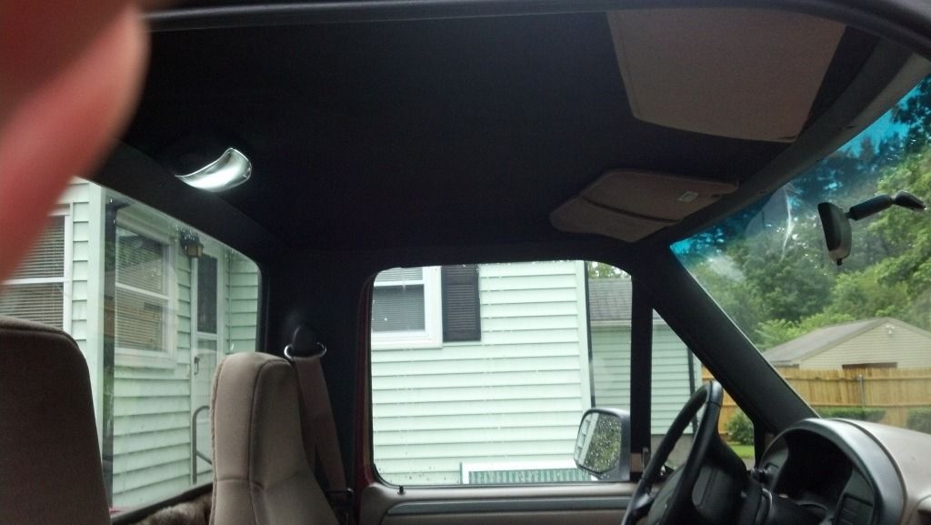

I don't have any pics of the inside but the headliner was ripped and all some of the parts were broken. like the pillar covers. I picked up a new set of covers from the junk yard and started to paint the interior black. I also wrapped the headliner in black suede which i go from a kit on Ebay for $60 at the time.
The header panel was broken as well as the headlights and blinker housings were leaking so i bought a new header panel, black lightning headlight bezels, smoked headlights and blinker housings, and a black billet grille.
