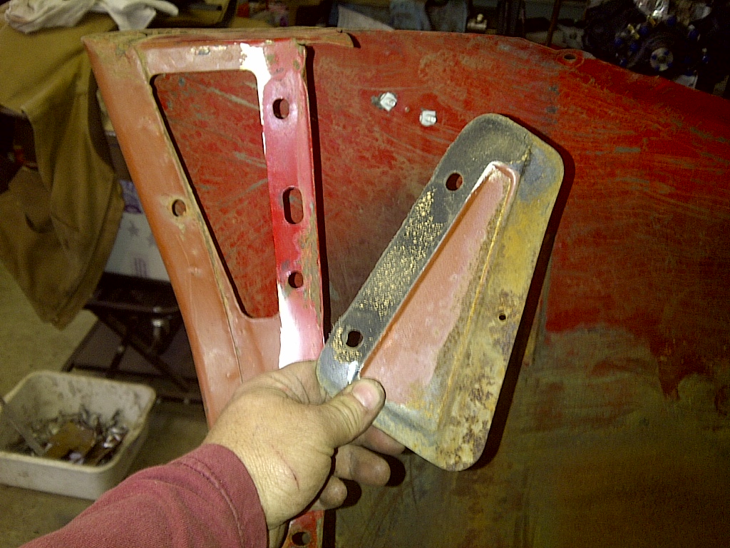

Can anyone tell me the purpose of this piece. Its on the front fender of the f1. I found it when I was getting ready to do some rust repair.
I think that Ray is right. If you had a heater part #8708 would bolt to there instead of the plate. In Canada you may want to take Denny (firstrider) up on his offer.
Is that bracket part of the fender itself? Since my cab is a 1950 but the front end is 1952 I'm going to have to fabricate a bracket. Can you take a longer picture to show location on the fender?
Pete - not exactly sure of your question. To which bracket are you referring? The air duct snorkel connects to the fender opening just above the passenger side headlight. There isn't any bracing or brackets on the 48-50 versions.
This cover plate is the same and in the same location of any 48-52 right upper fender. Pete, look under the front edge of the right fender, above the right headlight. That's where this plate is located. If your's is missing, I may have one.
That cover plate isn't anything special. Just a piece of metal cut to fit the hole and block it off. Mine was still sealed with the original cork gasket. Right in the top corner of the fender like 51PanelMan stated. The only other brace is the fender brace that mounts to the inner fender. I plan on using the Vintage Air Mini AC, heat and defrost unit but I dont see where it uses a fresh air supply to it. If it does maybe someone will chime in that has used it and in that case I could use that hole. Otherwise I am just going to reinstall the cover.
Thanks for the location, Ilya. I don't need the plate I need the part that it mounts onto. As my fenders are from a 1952 I don't think that the RF has that piece on it. I'll have to go out to the barn and check after it warms up a bit. It is 2 deg F with wind feel like -15.
