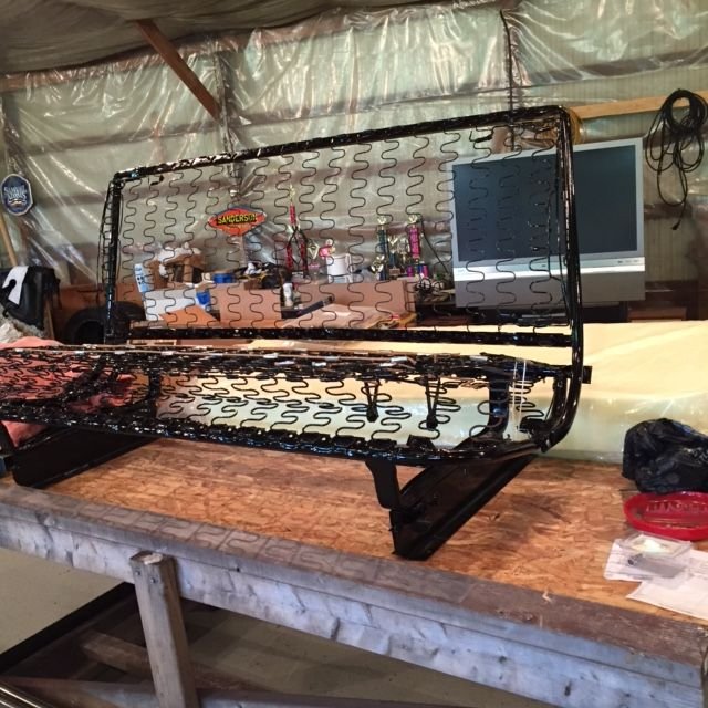

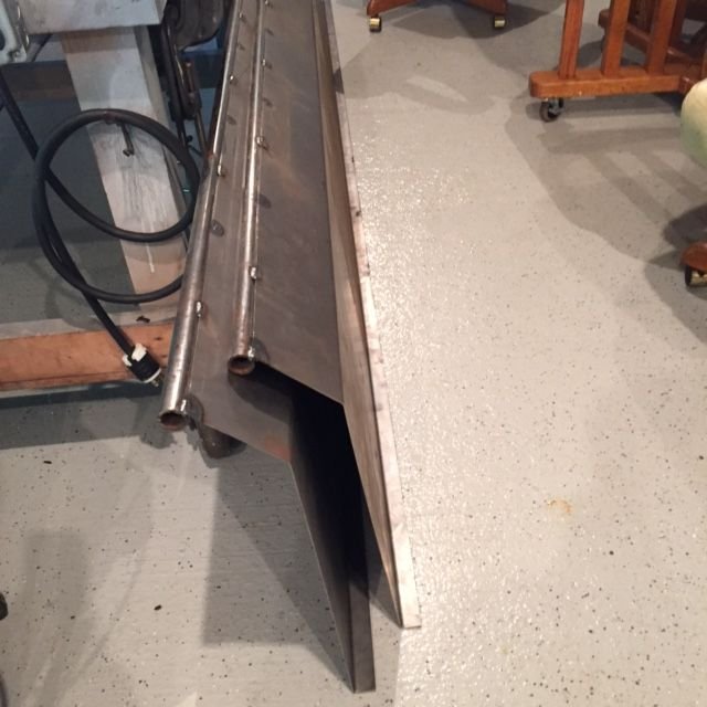

Badmoonreizen's Avatar
Badmoonreizen
Badmoonreizen is offline
Join Date: Jan 2014
Location: Howell, Michigan
Posts: 415
Badmoonreizen has a good reputation on FTE.Badmoonreizen has a good reputation on FTE.
Had the 9' box sides bent up, and stitch welded the pipe roll. Now I have to order the long bed front and tail gate so I can weld up the frame and fit it to the new chassis.
Did all the seat frame repairs with 3 prong pliers and clips, blasted and painted it.
I ordered a seat cover kit from Raybuck, foam from Mid-Fifty. I think I'll have a local upholstery shop install everything, rather than have bulges everywhere, although many others have done it on here themselves.
Regards, Mark.
