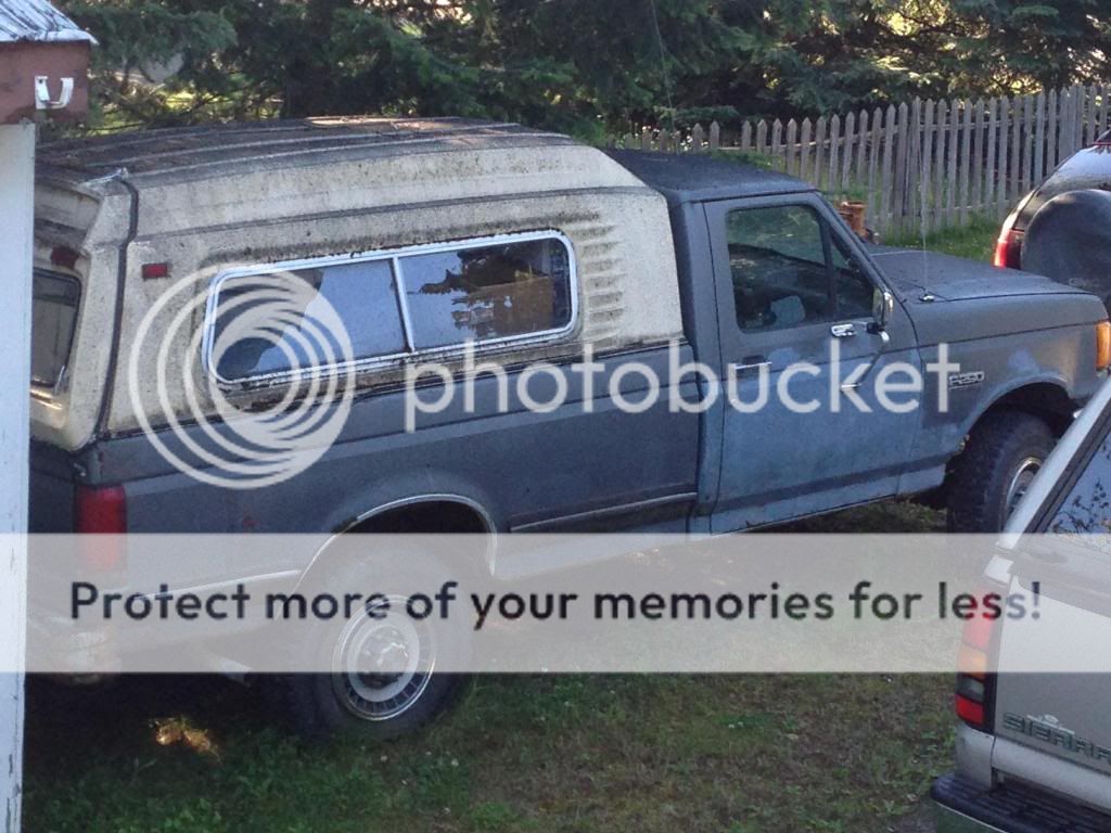

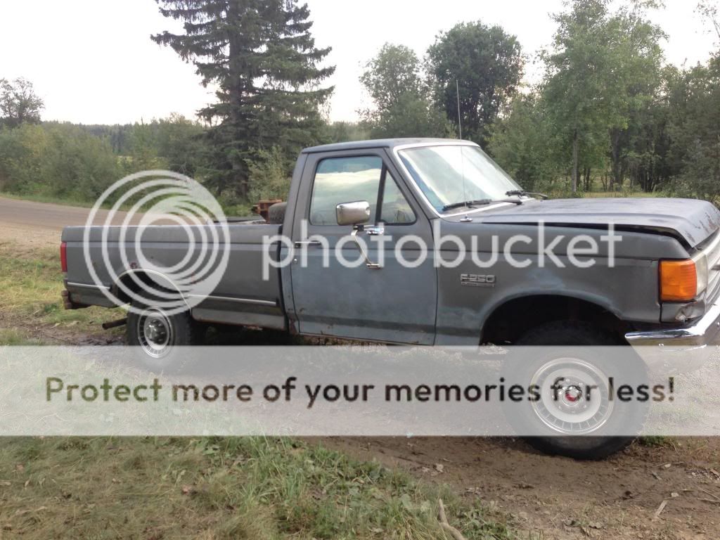

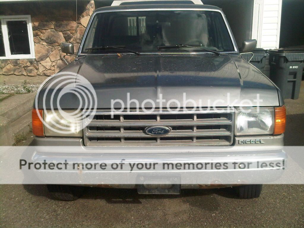

I picked up this 1989 F-250 from my grandfather this past weekend and plan on doing a mild restoration on it including rebuilding the 300 i6. It was his work truck for many years and has seen many miles of dirty logging roads and many hours idling on landings (355000 km/220500 miles on the odo). It's since been sitting for at best guess 12 years. I haven't been able to fire it up yet as the fuel in the tanks are probably beyond rotted and the fuel pump needs to be changed out. Dropping the tanks and assessing them and changing the pump is the plan this weekend. Followed by trying to get it to run and drive before tearing too far into it.

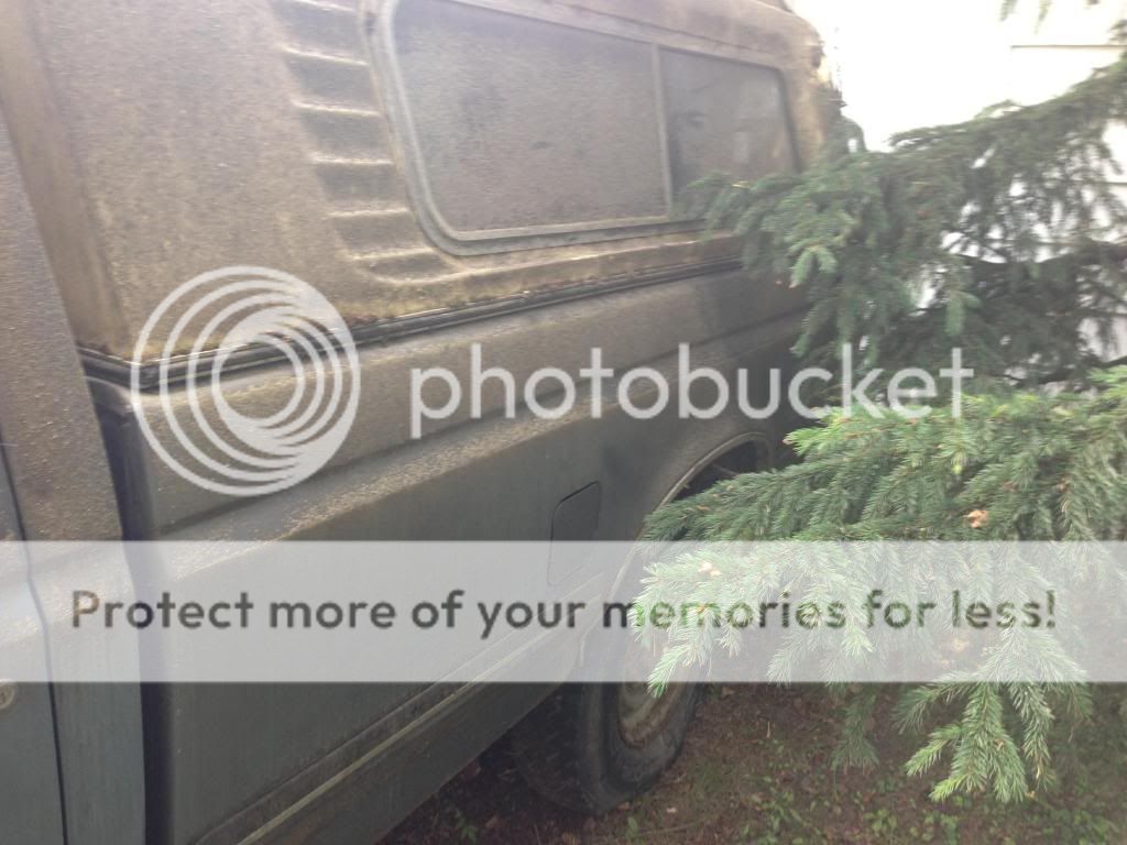

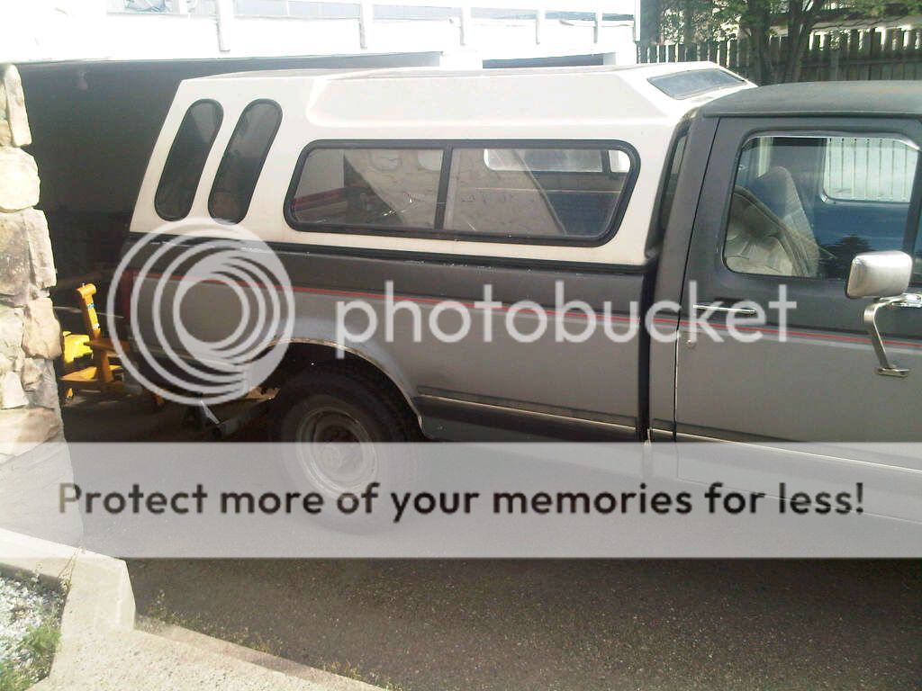

How it sat when I picked it up:

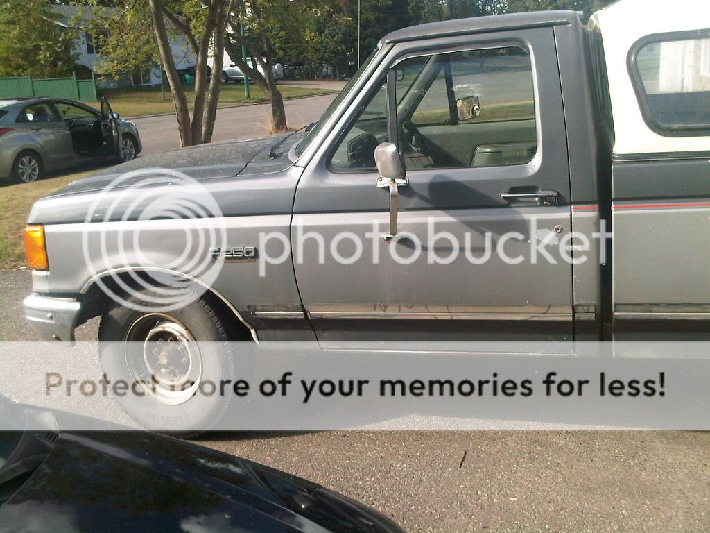

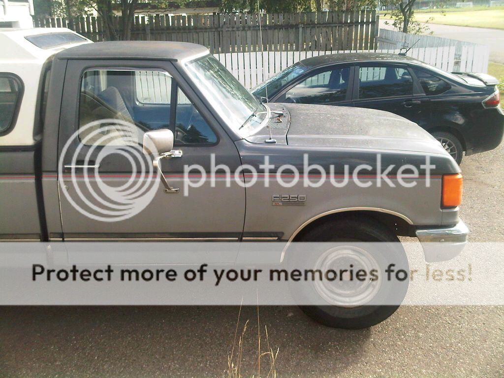

How it sits after a much needed pressure wash:

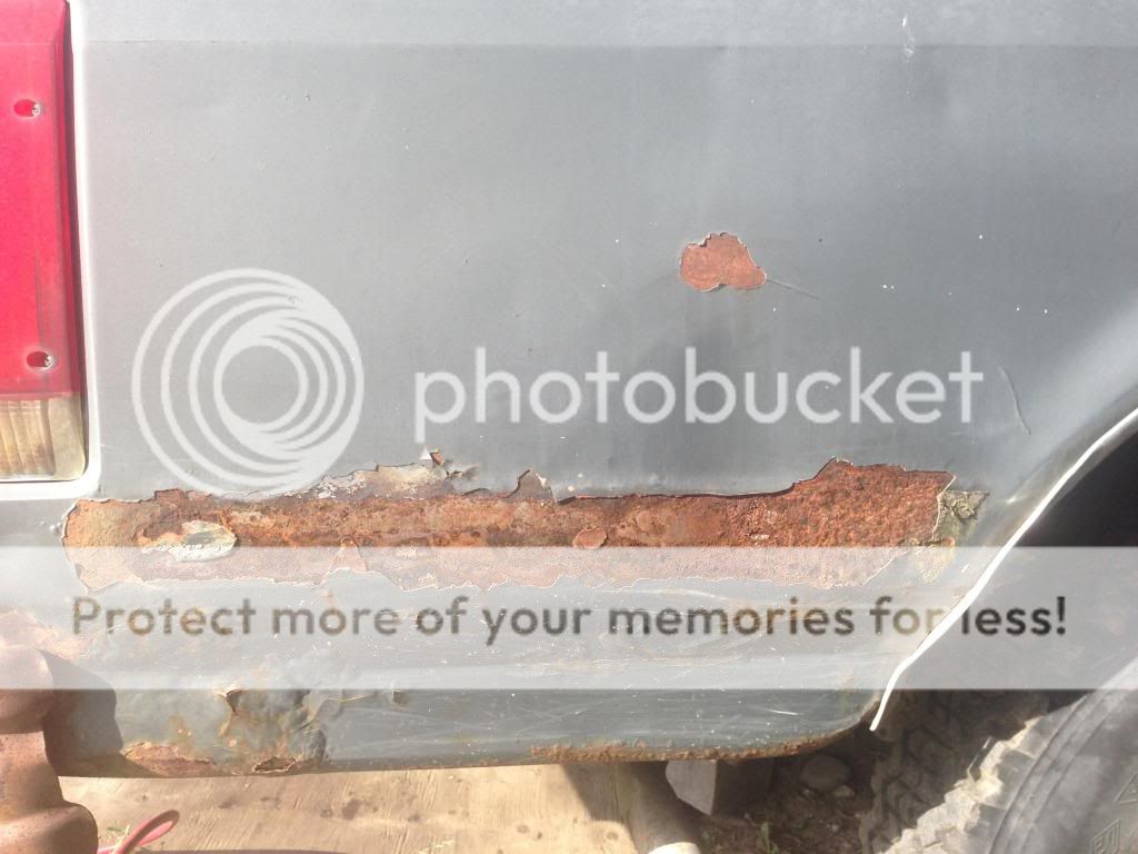

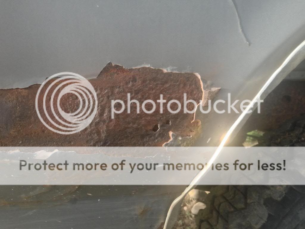

As you can see in the final picture my grandfather had started some rust prevention years ago on the door/fender. I plan for some patching, mainly the doors and cabs. I picked up a 1991 F150 a few months back for it's 351w for my '79 project and I plan on using the front clip from the '91 on the '89 to save me some patching.
The underside is in pretty good shape (no pics at this time), just surface rust but I do plan on Rustoleum the frame and underside of the cab/box to help with the salt on the roads in winter.

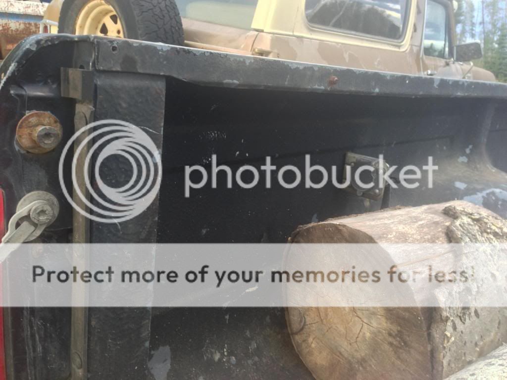

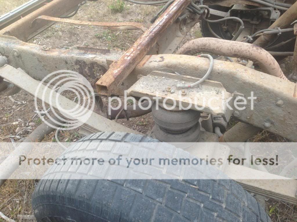

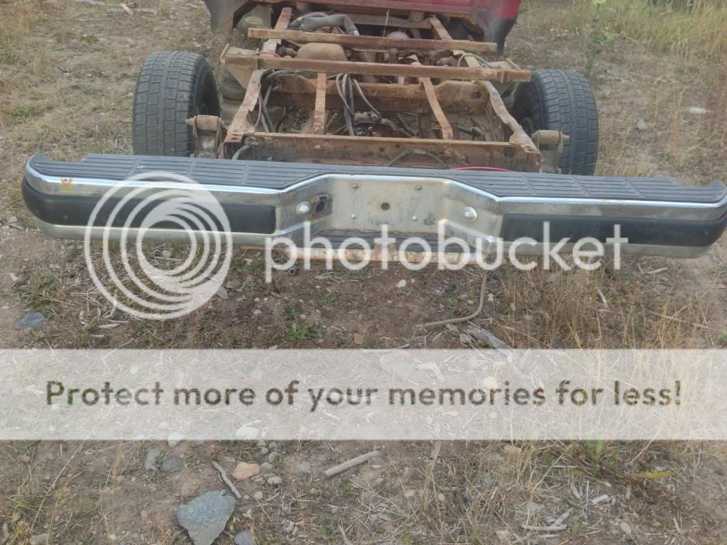

Hopefully I should be getting the 2 fuel tanks dropped and drained and the donor box cleaned out and all of that assessed tomorrow at the very least. Getting the box removal started if all that goes good and the donor box is better then the current box.

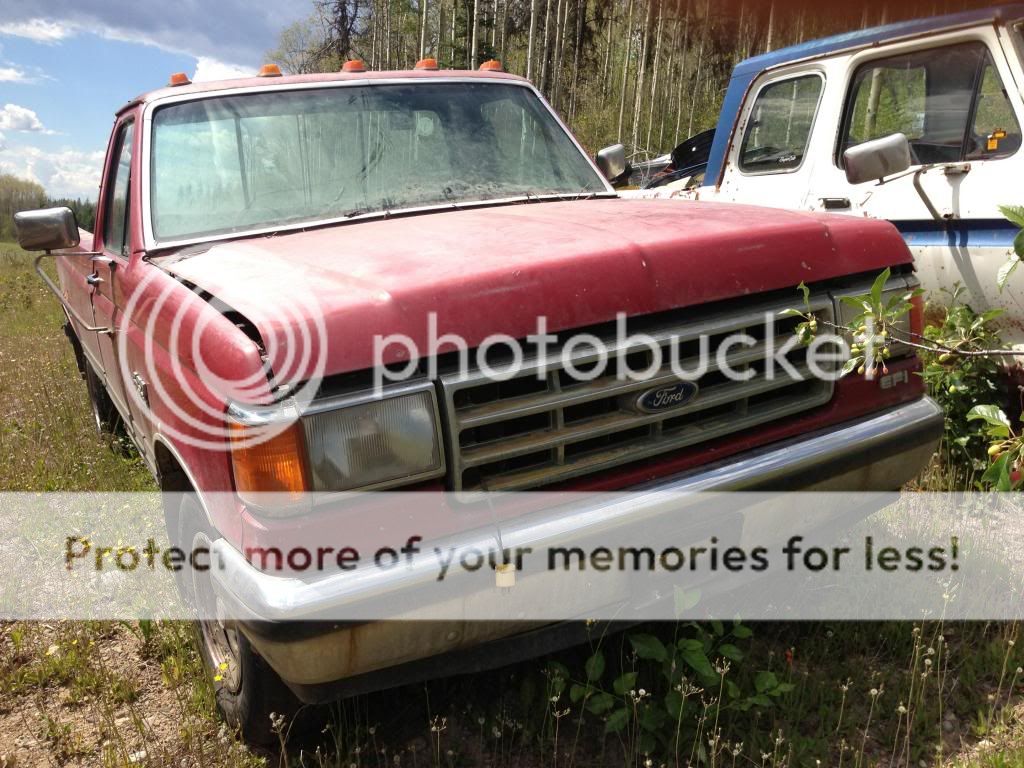

The donor box has some 5th wheel brackets on the bed that might be just as much work as patching the rust spots on the current box. I'll get some better pictures tomorrow hopefully.

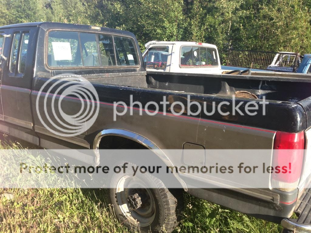

Donor box:

I'd honestly rather patch intended holes than rust that ate entirely through a body panel. Your existing bed looks a little less beaten in, around the rails, but it looks to me as it was swapped years ago, seeing as it has the trim on it.

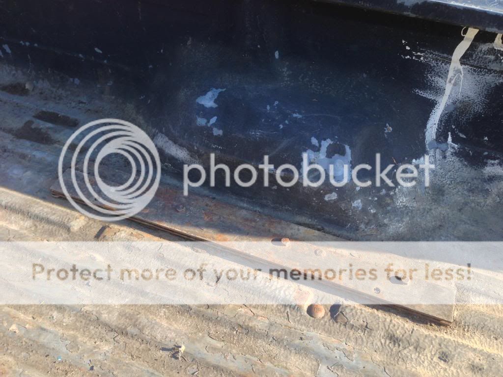

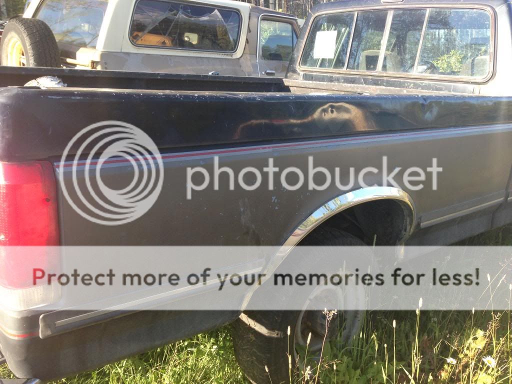

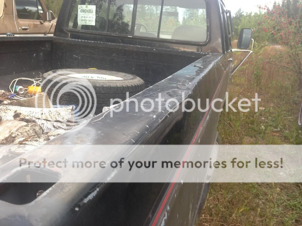

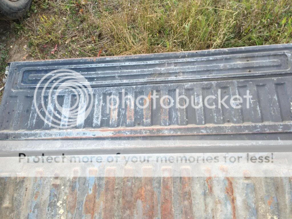

Well I didn't get as much as I wanted to get done yesterday Basically got my work place cleared out and pulled/pushed my truck in. Assessed the 2 boxes as best I could as I didn't get the donor box cleaned up to see condition of the bed. I still think the donor box will be less work as it isn't nearly as rusted and there's some bed liner in it already. I tried to snap some better pictures of the bed rails. I don't think they're as bad as the pics before show them to be.
The bed liner

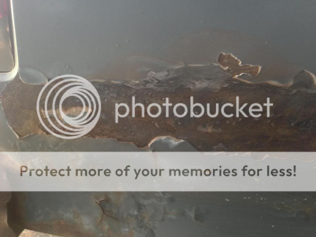

I discovered some more on the original box that is also making me lean towards the donor. This is what's under one of the trim panels and the aftermath of a few seconds with the wire wheel.
After wire wheel

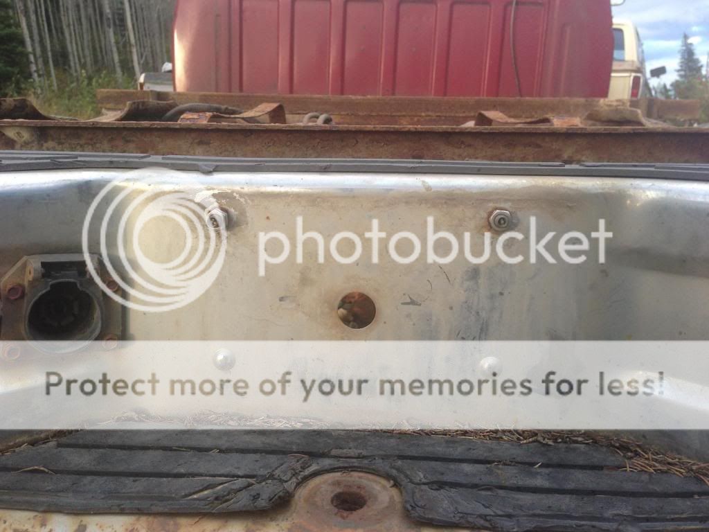

It's a lot of rust repair but it's not completely discouraging if the donor box's 5th wheel brackets ruined the bed. The underside of the box and the bed is in stellar shape. The latter because of the canopy my grandfather left on it all the time.
The underside

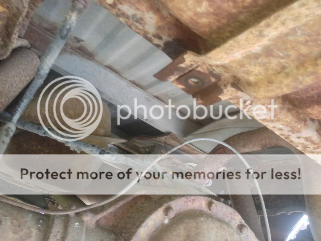

The fuel tanks are still on the truck. I had started on the rear tank but only managed to get the rusty 2 forward most bolts out of the straps before rain, dinner and social aspects called (working on the truck at my In-Law's place).
I did find out the gas in the front tank came out clear and not a horrible rusty orange color like some in old tanks left sitting with gas for years does. So that's was some good news. Might not need new tanks after all.
The rear tank seemed empty as both the gauge on the dash said "E" and the hose encountered no fuel when we went to siphon the tanks.

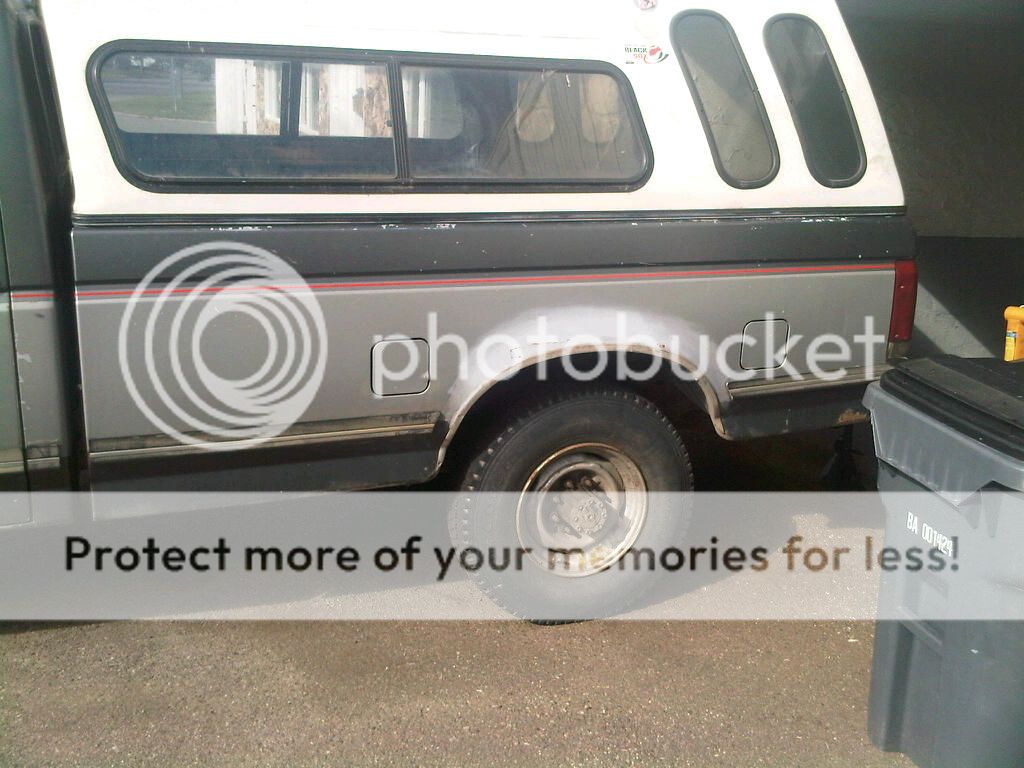

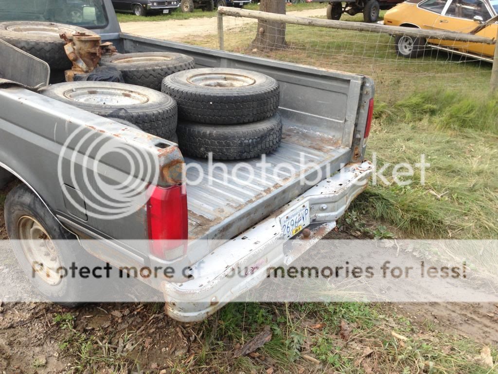

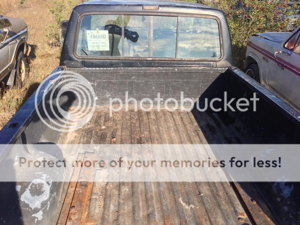

Well we picked up the donor truck for $500 and it came with a couple extra tailgates, extra set of doors and an extra hood. It's an '87 F-250 4x2 Lariat 6.9. It's got a near mint cab and front clip that I'll use on my grandfather's frame instead of the red 91's front clip and his slightly worn cab. Even though his would be a good base this one requires less work.
The box on this truck doesn't seem bad but the rust has crept in behind the wheel wells so I think the black ext cab's is still winning out out of the 3.

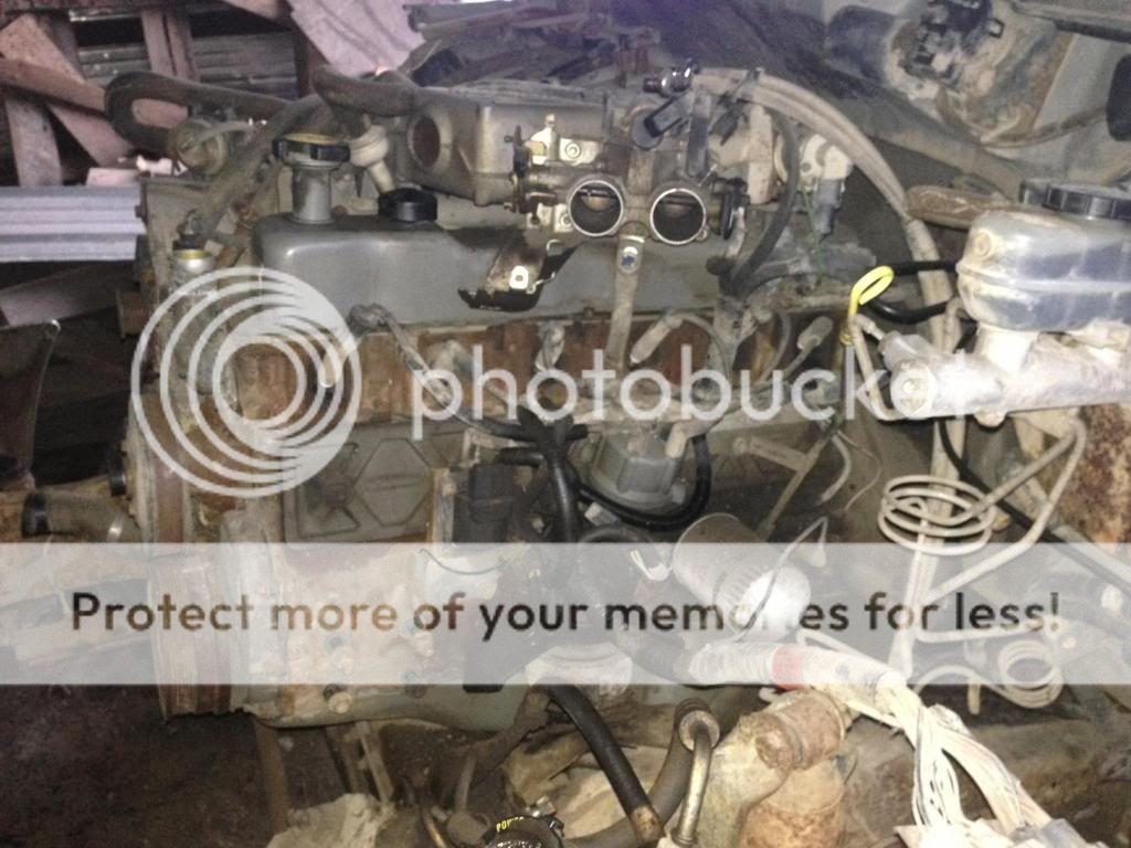

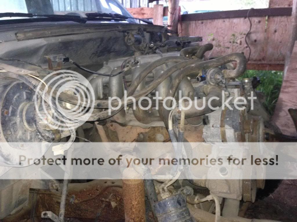

So a slight change of plans. Spent half the day with my brother tearing into the front clip and engine.
Going to pull the 300 i6, zf and transfer case next weekend and pull apart the motor so I can start bring pieces into work and machining them over the next little while.
We also took a few minutes to get the ext. cab donor truck's box cleaned out and I'm 99% sure this will be the box I'm using. The brackets for the 5th wheel weren't nearly as bad I thought they were and I believe the previous spray in bed liner really helped keep the bed half decent. Should get the brackets removed next weekend after pressure washing the bed.
