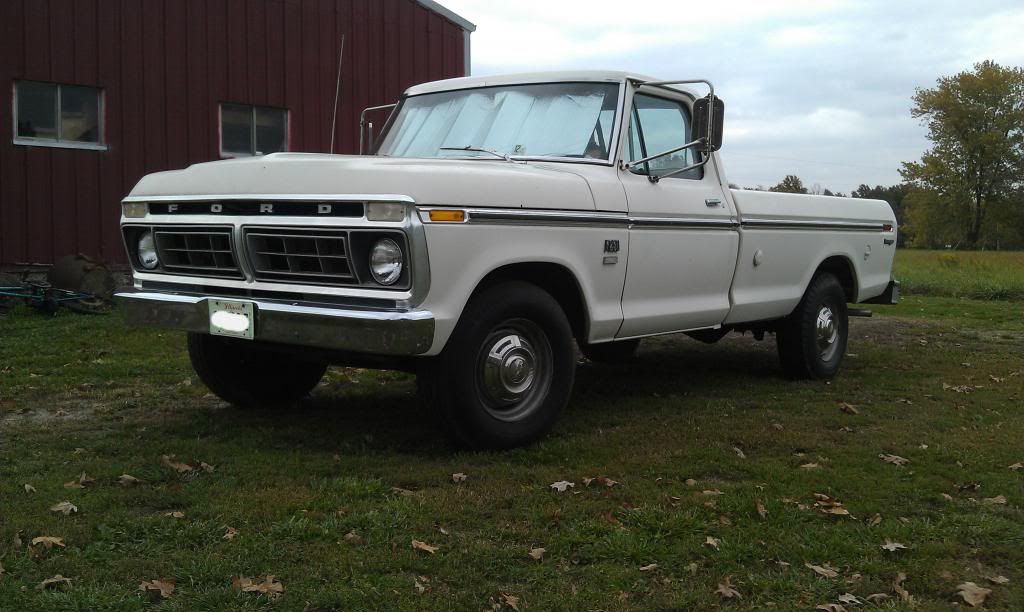

Hey everyone, I have been lurking here on this forum for a while and never really introduced myself, or my truck. I am a 21 year old college student majoring in Industrial technology, and have always had a passion for these old dentsides, especially the 78 and 79s. I have always loved how tough they look (and how tough they were built). My uncle had a 1979 F-250 4x4 that I admired my entire life and I always wanted him to sell it to me. He always drove compact pickups (for gas mileage) and kept his 79 F-250 for heavier jobs, but he got a sweet deal on this 1976 F-250 Camper Special with a 460 and C6 (46,000 original miles)
