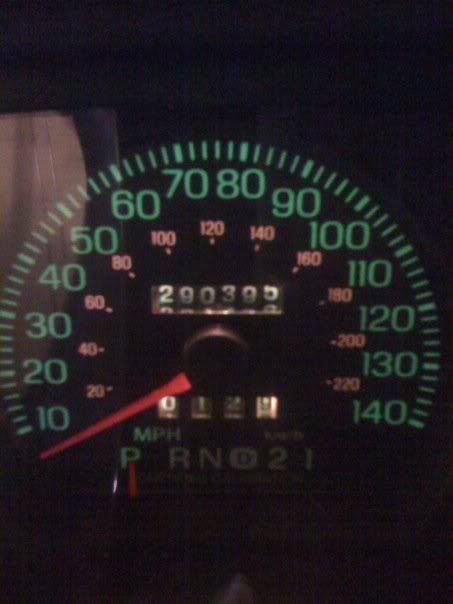

I dont think you have to worry about the motor wearing out on 5-20. I used to service Crown Victoria Police cars, they ran 24/7 mostly idle time. In the hot 100* summer months with AC running and more idle time. Usually Those units would avg about 3,500 idle hours + about 80k miles. Ford justifies one hour of idle time equal to 35 miles of driving. If you factor in 3,500 idle hours x 35 miles = 122,500 equivalent to normal driving wear and tear. So add the 80k of actual mileage is 202,500 miles worth of wear and tear on the moving parts. Those units always got the FL820s and regular old Motorcraft syn blend 5-20 for years. Usually those cars then become taxis with more idling, less maintenance and go until 300k on the odometer, We used to delete the idle our meter out of the PCM on the 05+ cars for that very reason that idle time destroys any value that is left. I had one that I picked up to derby with 290,000 miles on it and just over 7,000 idle hours! Thats 245,000 miles just in idle time! Now plus that 290k is just over 535,000 miles worth of wear and tear on the moving parts. So now that my little almost pointless post is over, you should be just fine with any high quality 5-20 you choose

I've seen quite a few of those CVPIs that were first squad cars, then taxis, with 400K on the odometer, and even a few over 500K. Who knows how much idle time they had in addition to those miles. These cars weren't being scrapped either, they still ran great and were being retired from taxi duty and sold to the public.

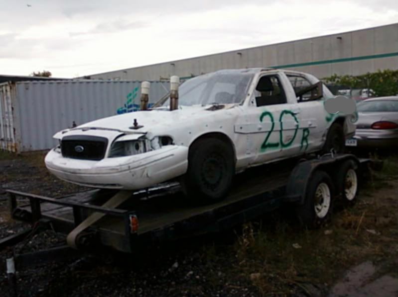

I know most people love pics its a litte OT but this is it.
