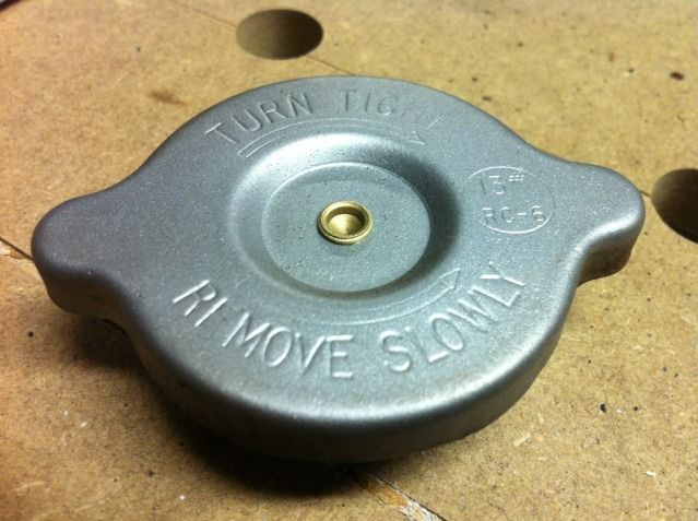

I bought the CD from HipoParts.com but it won't arrive for a few days. I need to change out the radiator hoses as they are some CarQuest hoses that are bigger than 1.5" diameter and don't fit well at all, buldging severely at the clamps.
Trying to keep the beast as stock as possible.

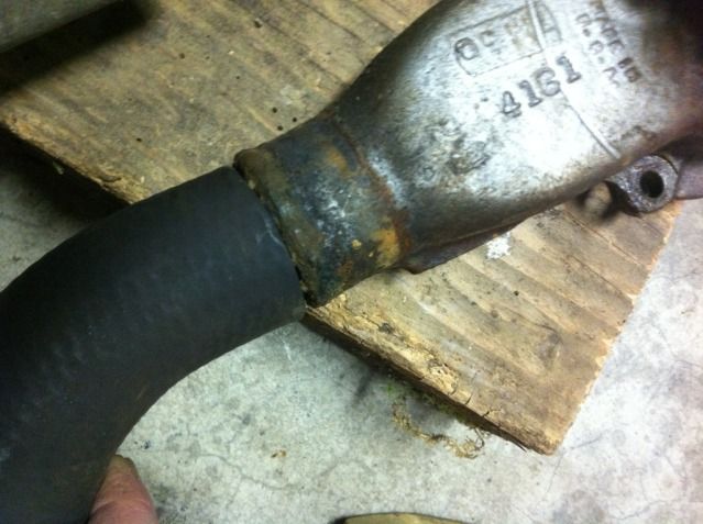

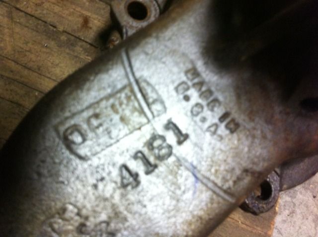

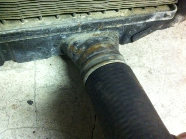

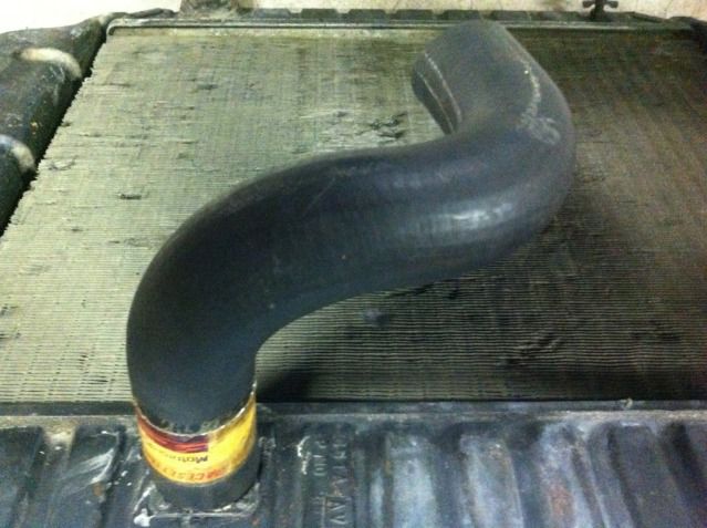

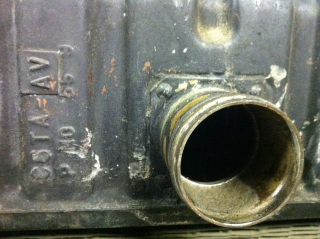

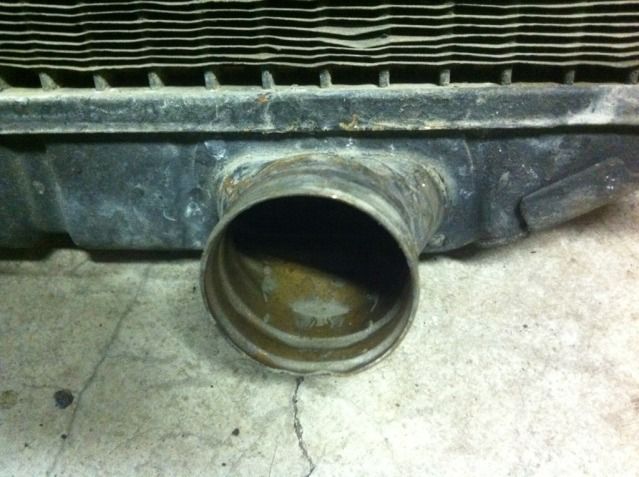

I've run into a bit of a stumper that I'm hoping someone might have run into before.
I'm replacing the upper and lower radiator hoses. CS65 has seen my truck and as soon as he looked at the radiator he said it was original. The upper main tube is about 1 1/2" outside diameter. The lower main tube is about 1 3/4" outside diameter. Here's some pics of the radiator tag and tubes.
That last one is the upper hose C5TZ-8260-V on the radiator looking down. The other end fits the thermostat housing perfectly. All good there.

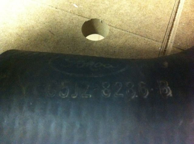

Today I get two, what *should be*, C5TZ-8286-B lower hoses but both ends on them are 1 1/2" inside diameter. They don't fit the outlet or the water pump. You can see the part number and the FoMoCo logo in these pics as well as fitment.
The hose seems like it has the wrong part number, isn't that saying C5JZ-8286-B? Their pick tag even says C5TZ. I'm sure they pulled the wrong part, no?
Is there anything there to identify a water pump? It's made in the U.S.A., but is that a date code? Surely it's been replaced?
J = Wrong hoses, where did you get them from?
If the waterpump has a FoMoCo ID number cast on it: Yes / If it's an autoparts store replacement: No.
J = 3rd digit in part number prefix: Industrial engine related. I don't have an industrial catalog, so have no clue what C5JZ-8286-B is for. Doesn't really matter, cuz they're the wrong fracatta hoses.
btw: Next time you have a parts related problem like this, please type a new thread. I usually don't read thru members project threads that go on .. and on .. and on .. for gawd only knows how many pages.

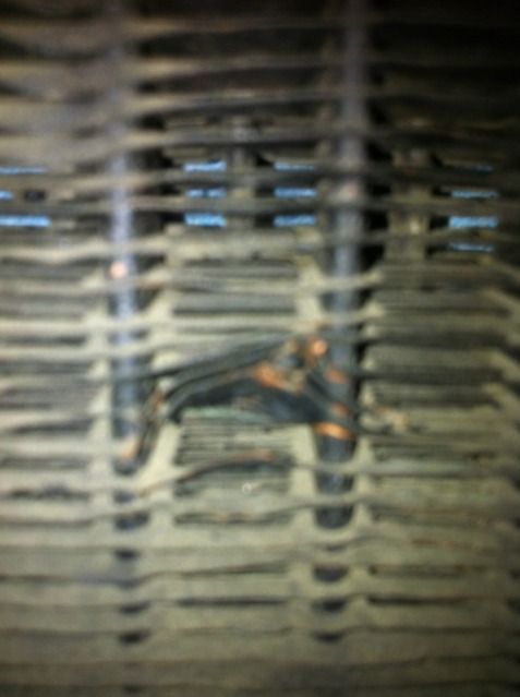

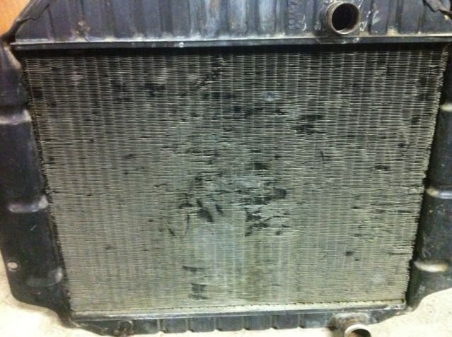

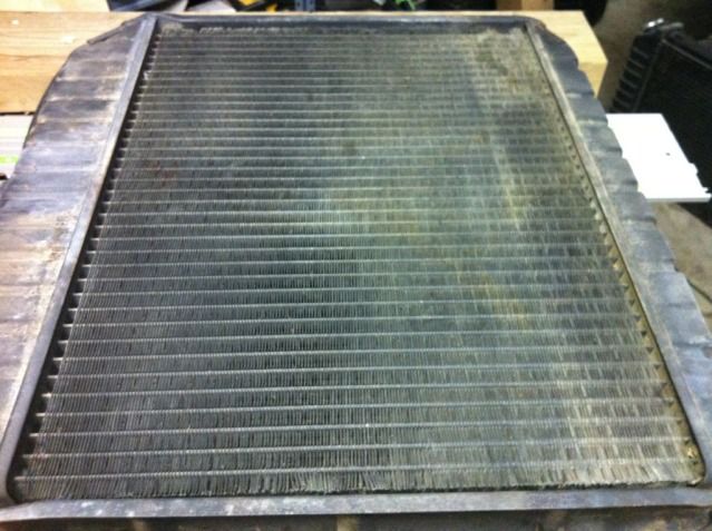

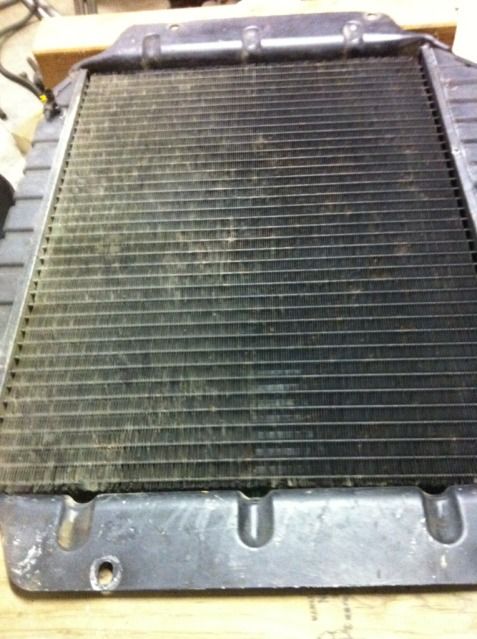

Under the category of "What did you do to your truck today"...

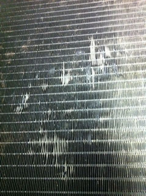

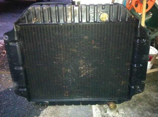

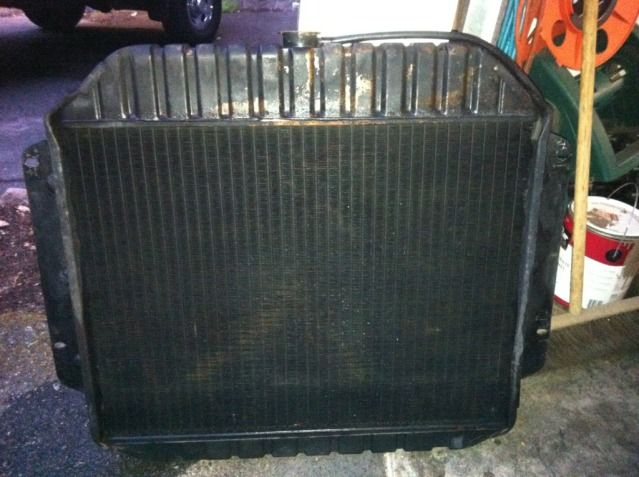

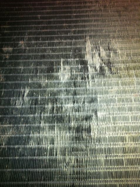

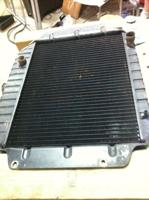

The radiator was a bit whamied on the backside from...I don't know what. Tools, most likely. The front side had a screen in front of it so it only had a couple of bugs in it and almost no bent portions. First I straightened it and then I cleaned it. I still intend to paint it with some radiator paint. The 13 lbs RC-6 radiator cap cleaned up real nice, too. CS65 said that it is an original cap, too.

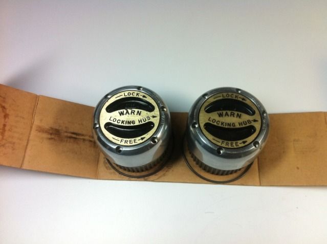

I had just mentioned to shano63 and cs65 that I'd found the old hubs I was after. It took a bit of digging. Limited market for these, but I had a particular interest in them. Here's some pictures.
