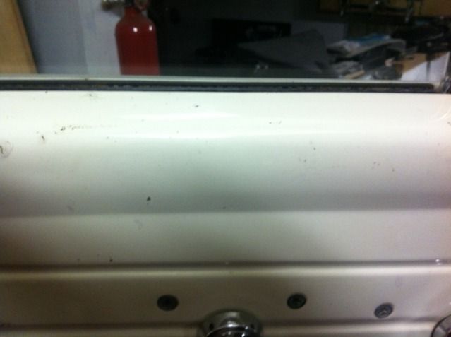

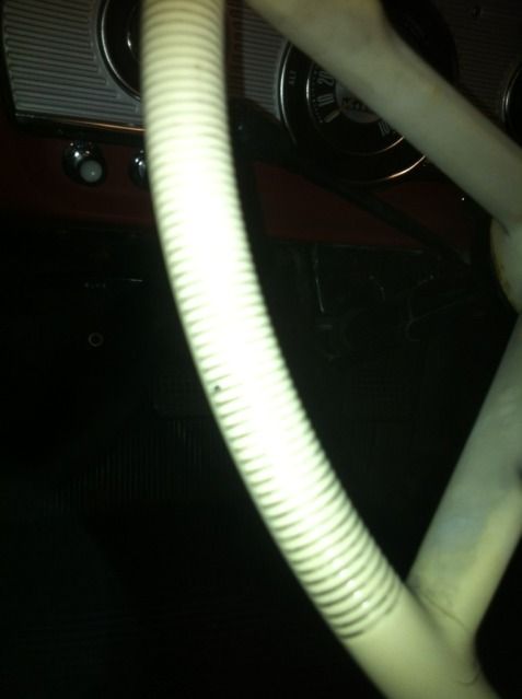

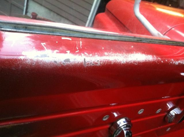

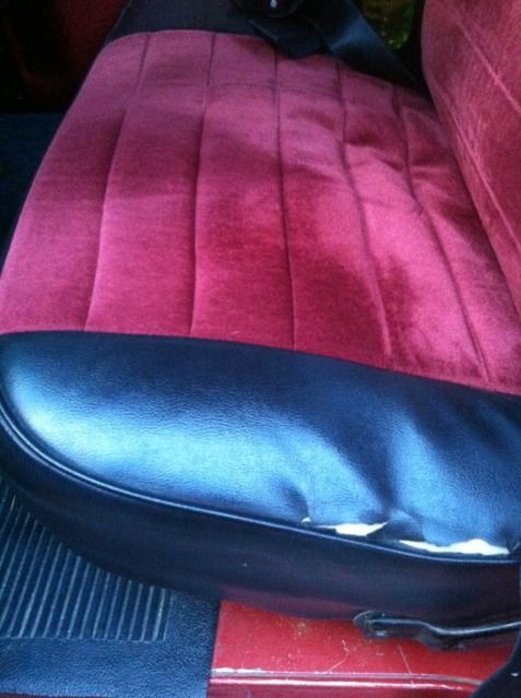

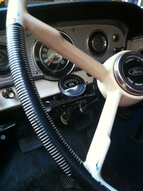

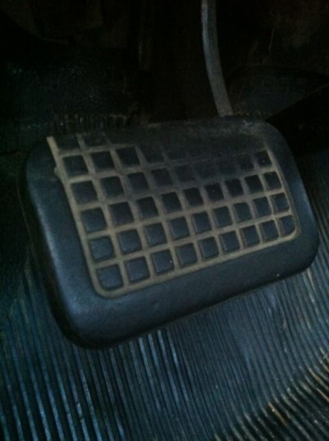

Since I have the two trucks I can compare them side-by-side and I begin to see what TripleFrame was talking about. The red truck has 179,000 miles. The white truck is the one in question.
Clutch pedal on the red truck.
Clutch pedal on the white truck.
Steering wheel on the red truck.
Steering wheel on the white truck. Ribs are perfect. Paint mostly intact.
Seat on the red truck. Recovered. That's cracking and the springs on the drivers side are shot.
Seat on the white truck. It's out while I clean underneath it.
Drivers armrest on the red truck.
Armrest on the white truck.
Upper inner door panel on the red truck.
Upper inner door panel on the white truck.
Both are original paint. Tell me if you want to see more pictures.
