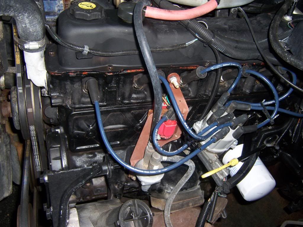

Hi all,
My '84 f150 4.9L six is in need of a carb kit and some other carb parts. The problem is, someone has been in there before me, and removed the carb ID tag and didn't put it back! Is there a way to determine the numbers that were on the tag from the VIN or other information? It is an electronic feedback 1 bbl that looks to be a Carter.

Without the tag, you will have to use the Carter and/or Weber stamping number.
You should be able to find the number stamped to the lip of throttle body on the driver side of the carb, right where it bolts to the intake.
It will have a four digit number and/or with a letter, something like 7329 or 7843S.
Post that number and I'll see what I can find.

First off, let me welcome you to the forum.
Someone will come along with more information soon.
I should also ask if you could post some pictures so we can better identify your issue.
But first, let me ask you a couple of questions, so that we can narrow it down a little further.
Does your carburetor look like this;
And do you have a gray module on your distributor like this one does;
Reply With Quote

Thanks for the quick response! The number you pointed me to is 7596S.

My carb is just like that one, and the TFI module is gray. Thanks for the quick response!

Original Carb tag number is E4TE-FA.
I found you a few kits... The Motorcraft kit is obsolete...
Borg/Warner: BWD: Part #: 10712B
Walker: Part #: 15789C
Napa: Part #: MPF 31220C

Carb ID tag number: E4TE-FA = Ford part number: E4TZ-9510-F .. Carter 1V Carburetor (Motorcraft CA-3291) / Obsolete
E5PZ-9A586-E .. Carburetor Kit (Motorcraft CT-1302-C) / Obsolete
Closest sources with carb kit to OP's IL residencia:
EVANS FORD in Carrollton IL has 1 = 217-942-3636.
GREEN SALES CO. in Cincinnati OH has 4 = 800-543-4959.
VINTAGE PARTS INC. in Beaver Dam WI has 7 = 877-846-8243.
