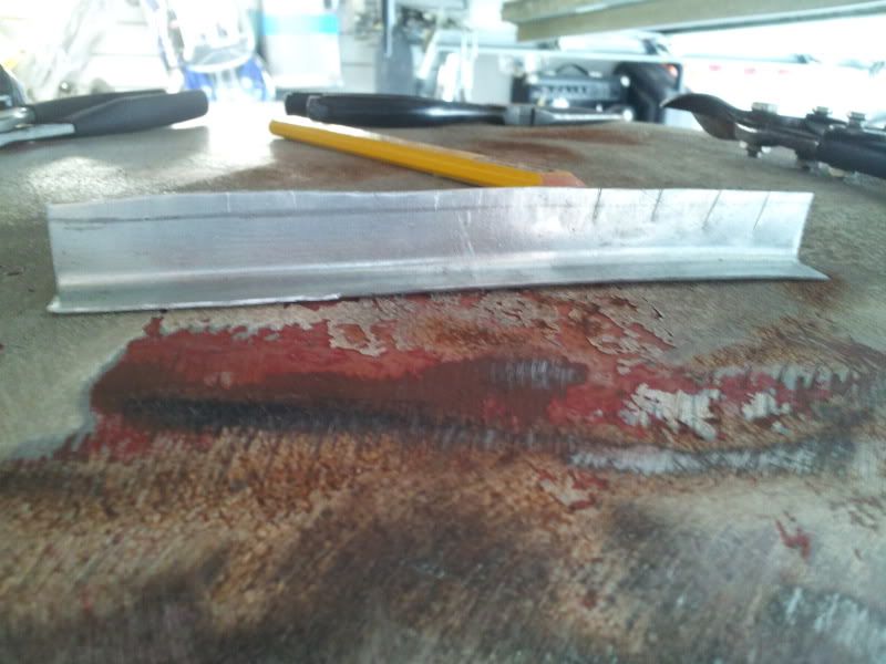

Well, I've got about half of it done. Well... that's misleading...hahaha
I actually have several lengths of this angle steel already.. it's zinc coated, which makes it a pain to weld to... have to grind all the areas that I wanted to tack down.
Fitting a section in..
Some more trimming, holes punch to weld through, and a lip bent to somewhat recreate the bead.
I just realized that I conveniently left out a shot that shows the corner. That corner was a real pain in the butt. Looks like butt too.
Tomorrow I'll continue and get the passenger side. Then go back, grind down the boogers, weld up a little more in between, place some sheetmetal plates behind the roof skin to weld to (like a fishplate).
After that, time for some rust proofing and filler.
Not my best work... and I aint proud... but it is what it is...

I feel real bad that you decided to go that route with those materials. I can't help but feel like you're going to be really sorry later that you didn't do it right. Galvanized steel should never be used for body work, zinc fumes are dangerous and paint doesn't stick, and most is too thin. and never patch from the outside in. There is a reason all the understructure is/was there, Ford didn't put an extra square inch of material in that wasn't necessary. I would have encouraged you to find another cab with a rusted out bottom and solid roof. Cut both at the roof pillars at the top of the doors and windshield and cut the spot welds across the seam at the back and graft the new roof panel back on like chopping a top without removing any metal. The posts would not warp or shrink and the weld seams would have been short and easy to conceal. Plug weld the rear seam back together and seal with seam sealer as was done originally.

Mike, good job using what u could to close up the bad spots.
Best material for the repair.... Maybe not, will it work.... Absolutely.
Lots of of use what we can to fix up our trucks. Hell ive used everything from a bed frame to tin from a washing machine on different trucks over the years. Use what u got, and prep it the best u can. After all we are enthusiasts, not experts.
As for the front piece get a nice flat piece of 18 guage,(homedepot?) And start shaping with tin snips until ur satisfied and weld it in. Mud her up, and move on.
A donor piece for the front is an option too if u can find a good section else where.
