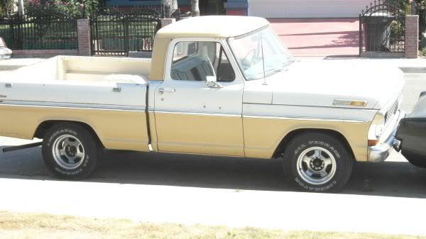

Hey guys, i saw this add on craigslist of a 67 f100
It has a 250 6 inline and a 4 speed
The owner claims that the body is in good shape
Hes asking 2900 for it
If i got it, i was wondering if the tranny would bolt on onto a 390?
  #28
It can with a FE bell, as it is different from the sm blk bell.
John
Either the year is wrong, or it has had some parts swapped already. The grill is from a 70, best I can tell... looks like it also has the rear side markers that didn't come along till about 70, as well as front side reflectors from 68+ on the hood.
That, and the 250 inline 6 was not used in pickups.
Still, if the body is in good shape, and it meets your desires and budget, it should be worth having a go.
