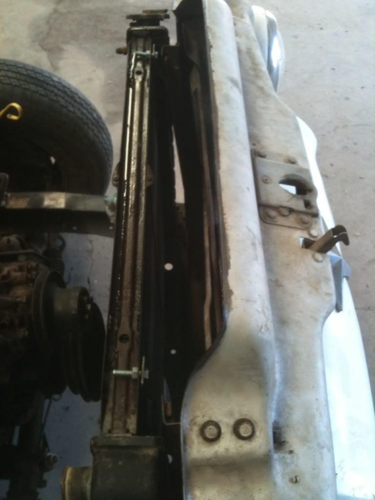

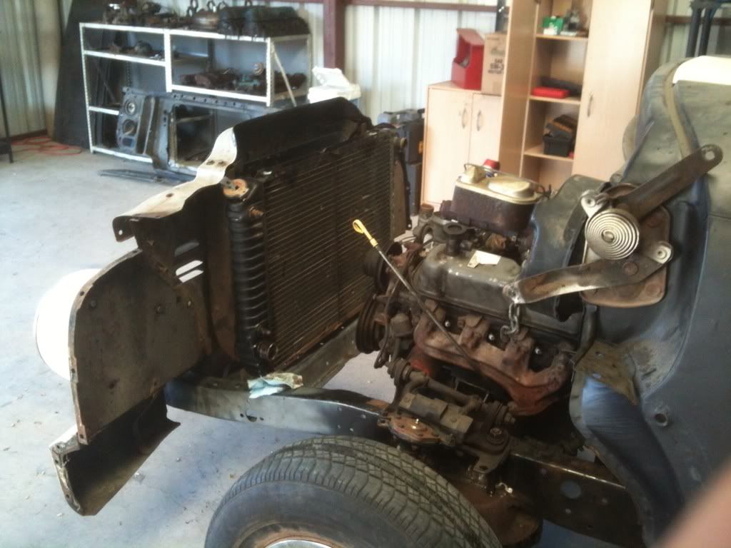

Radiator Mockup: I have been trying to use as much of my donor truck parts as possible. I realize that some of these parts may not work in the end so in my mockups I look for way not to alter orginal design. I may decide to buy orginal looking aluminum style but the price tag scares me at the moment. Electric fan (slim fit) in in the future.
For mounting, I made 4 "L" shapped brackets to support the radiator. It is not resting on the forward crossmember. May or maynot be the best way in the end but I am having fun.

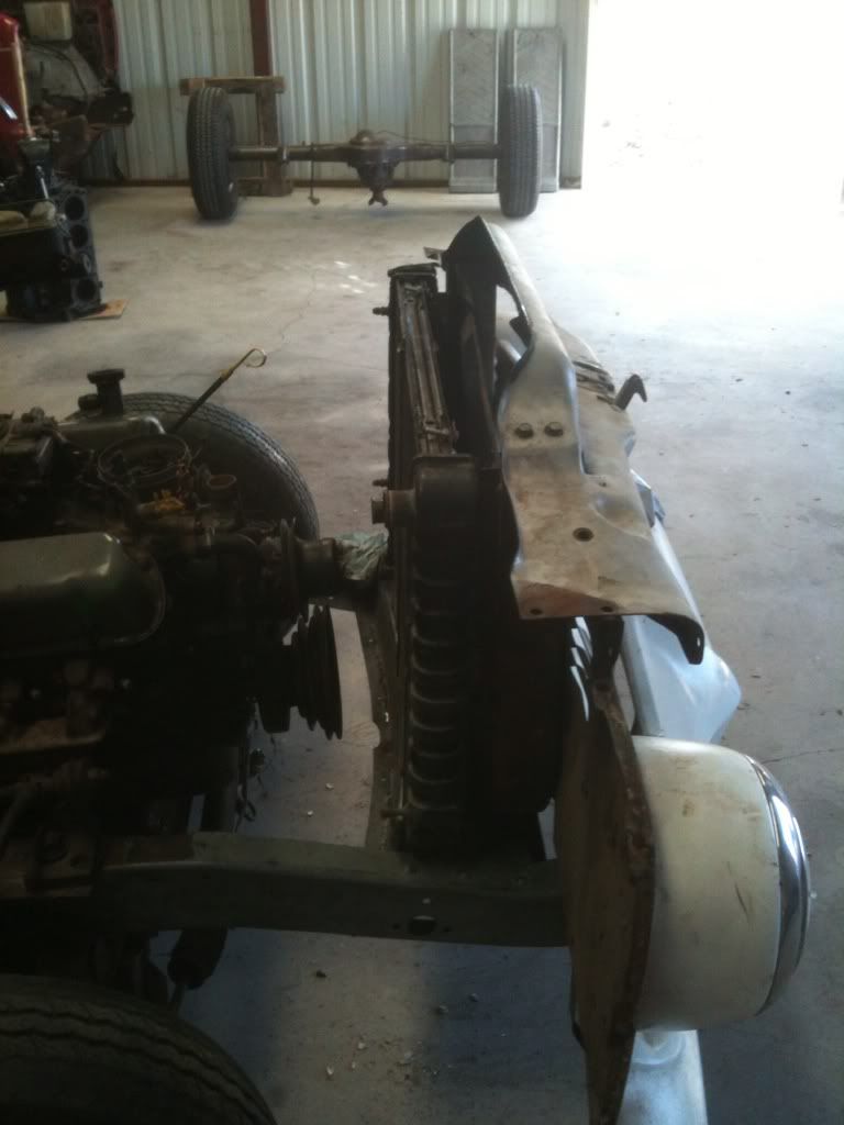

Anticipated Ride Height: With Aerostar and engine installed.
Note: The front wheels are 14" and the rear are 15" with large (31"s) and the rear axle is flipped. I did not cut the coils. I do not plan to flip the axle but would like the rear to be a touch higher than the front so I don't know what I will do but stay tuned. The level bubble showed the rear a tiny bit lower.

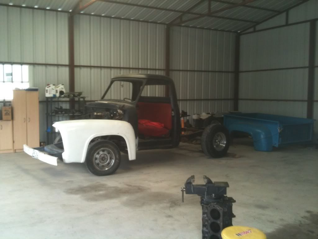

Everything so far has been major milestones perfromed since 2004 (most in the last year since I moved to a location with lots more room to work. My shop does not have electricity so that is the location for major component mockup. Welding and paint have been in my home's garage (finally a 3 car).

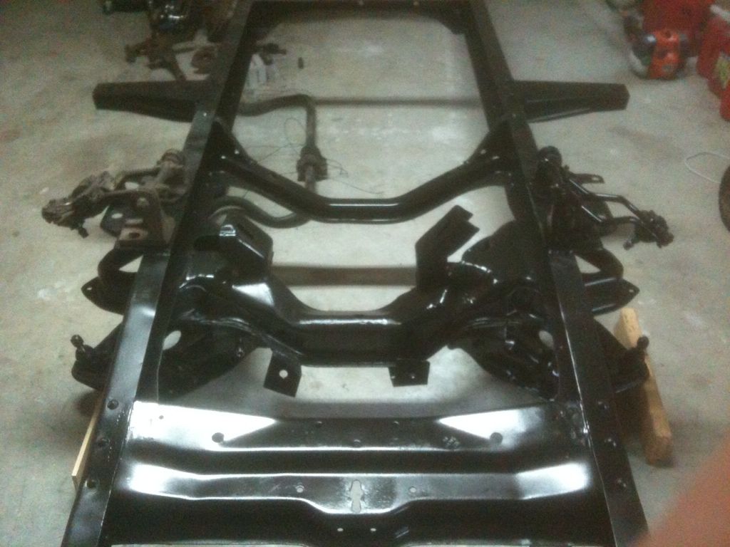

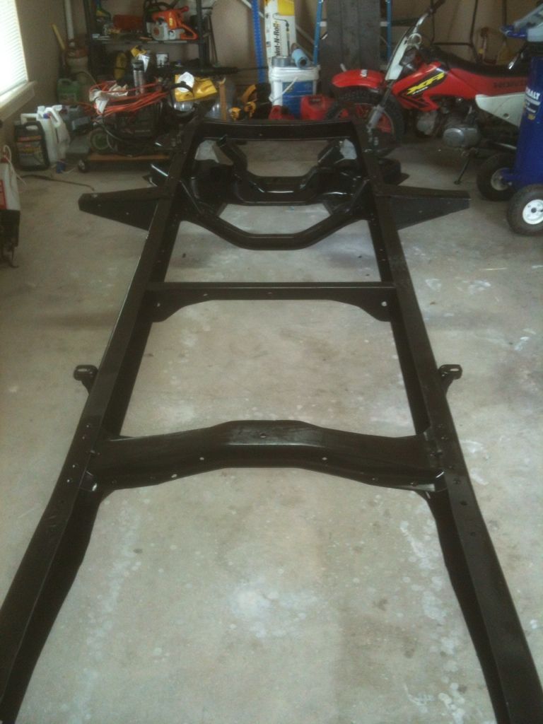

This weekend I painted the frame (POR-15, sprayed):

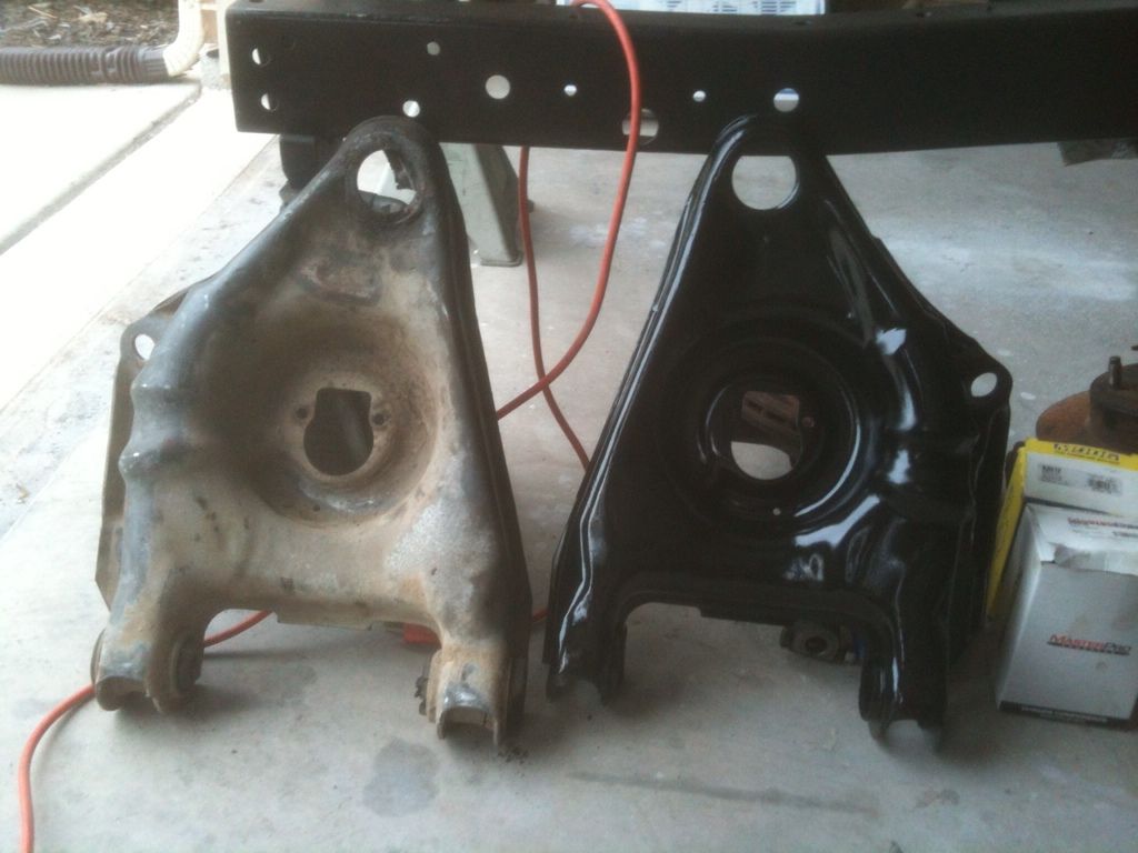

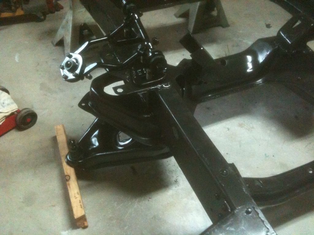

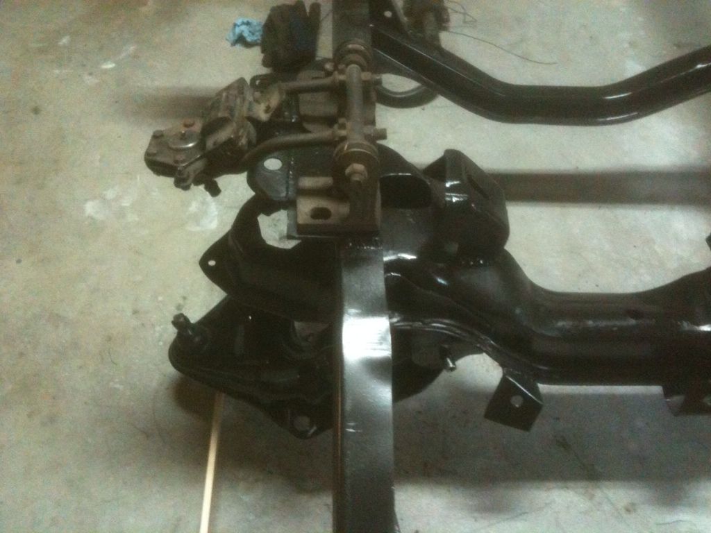

The last two nights after work I have been concentrating on the lower A/control arm. I purchased balljoints and bushings for both sides. I rented a ball joint tool from the auto parts store and pressed out the ball joints. For the bushings on the drivers side, I had to drill on the rubber and cut though the sleeve then cleaned and painted. I may need to repaint if the press scratches the paint so on the passenger arm I may just clean, press in the joint and bushings, tape up for painting, and paint.

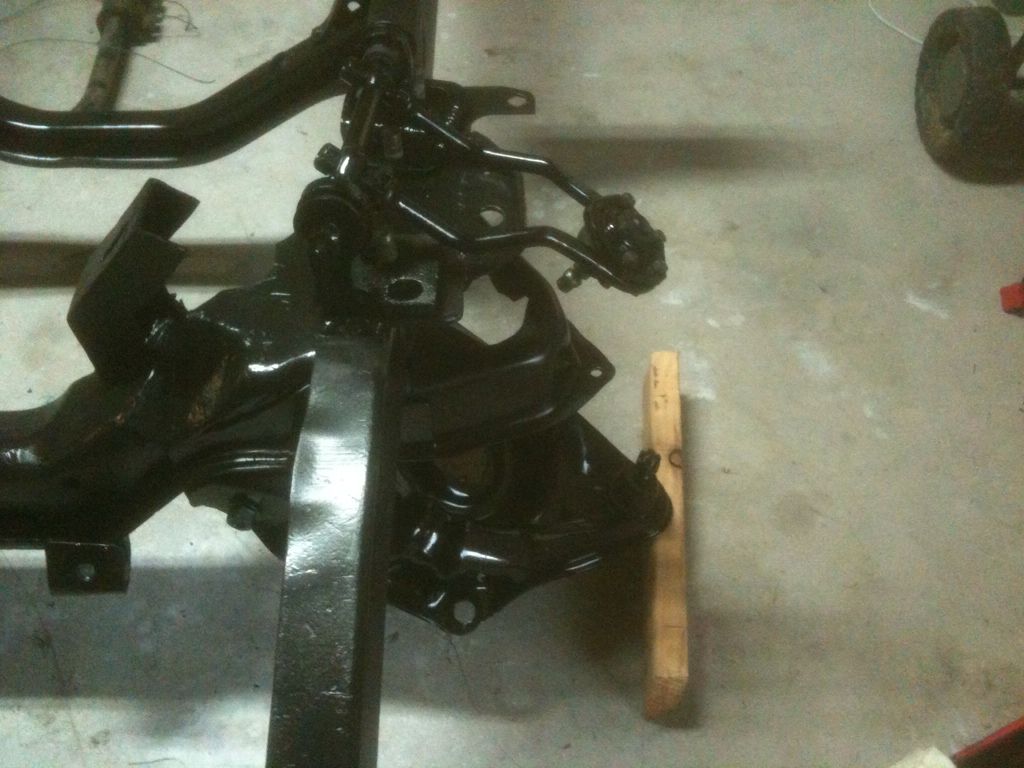

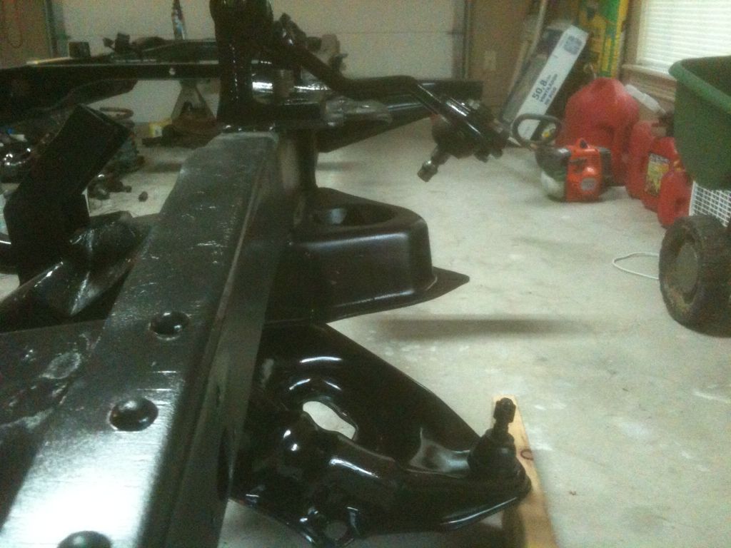

Front End
Did some front end this weekend. Pressed in the lower A-arm ball joints. I rented a tool from O'Reilly's. It was basically a large C-clamp. Worked pretty good to remove and install the ball joints, and bushings. I cleaned and painted everything and started putting everything back together. Also worked on the driver's side upper A-arm. The upper A-arm bushings are easier than the lower. I just used my vice to press them in (hammer and socket to push them out. Once I finish up the passenger upper A-arm I will move on to the spindles. I will need to buy new rotors and brake calipers.
