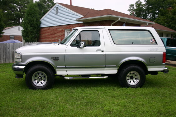

Alright so in about 2 weeks I'll be ready to order a lift kit. I've been looking around and I like the 2.5" rough country lift. For about 369$ it comes with shocks, springs, blocks, I beam drop bracket, radius arm drop brackets, and U-Bolts. I dont like the idea of blocks, so I was thinking just getting add a-leaf instead.
I was looking around and I like how 94 XLT White/ Silver 302's bronco looks. I think I will stuff some 33's under it and put some 4.10's in.
Also I'm going to make this my build thread to so its not as much spam lol.
So before I do order it (About 2-3 weeks) Is there anything I should know/be aware of?
Quote:
Originally Posted by 94 XLT White/ Silver 302 View Post
I was surprised when I installed a 2 1/2" RC lift. I got a lot more lift than I expected. The only problem with the 2 1/2" lift is 33's are the max. tire. With 32's stock gears were ok. When I went to 33's I couldn't stand it, I ordered gears within a week, it pulls good with the 4:10's. When I bought the Bronco it got 13.5 mpg. average, with the lift and 33's and 4:10's the average is now 12.5
Kenny
stock height, with 15x8 wheels and 32's
2 1/2" lift, the same wheels and tires.
2 1/2" lift, with 15x10 wheels and 33's

if 33's is as tall as your wanting to go than 2.5" lift should be fine. i would look up a gear ratio calculator before you buy new gears to be sure the 4.10's are what will work for you, it sounds about right but i dont know your factory tire and gear combo or the trans final ratio.

4.10's with 33's is accurate. Any bigger on the tires and consider going taller gearing. Avoid blocks in the suspension at all cost. The only thing they are good at is shortening the life of the springs they are mounted under.

you dont need a lift to fit 33's. just a little fender triming and spacing the front bumper out a bit and run some good quality shocks.
...If you really want to start cutting up the body of your truck. Fender trimming leads to flare-needing or refinishing/painting, sealing at the very least. Not sure everyone likes the idea of all that work for a couple inches of clearance that could still be an issue at full compression of the suspension anyway.
I personally like the body lines with the entire fender intact. If you have the chrome fender welt, you lose that as well.
Just another opinion.
The way to be certain you have the right axle gearing is to calculate what you have with the stock setup and then keep the numbers as close as you can after the gear and tire swap.
For example, your '94 with 3.55:1 axles and stock tires has your 302 spinning at about 1722 rpm at 60 mph.
To keep as close to those rpm's at that speed with 33's, you will need to run 4.11's. This will put your rpm's @ 60 mph at 1799 which is about as close as you are going to get.
If you do 3.73's (1632 rpm) or 4.56's (1996 rpm) you will be way under or way over the stock rpm's and it will throw your shift parameters off especially in the E4OD that relies heavily on VSS information to determine shift points. This pushes the engine out of its power band when it really needs to be within it. It also causes automatics to "hunt" gears or "stutter" as some refer to it.
The formula is simple: MPH (gotta be a speed that ensures you are in the highest gear of the transmission so 60 mph is typical) X axle gear ratio X 0.71 (E4OD overdrive gear ratio - don't skip this one) X 336 (constant "it NEVER changes") / 32.7 (actual tire diameter not nominal diameter). Or 60 X 4.11 X 0.71 X 336 / 32.7 = 1799.04881 rpm
33's are actually between 32.3" and 32.7" diameter depending upon manufacturer and inflation pressures.

I fit 33's on stock suspension, and it only rubbed slightly full lock to lock...didn't cut anything.....my previous bronco
this is my current bronco...4" or 6" in my opinion...I personally wouldn't bother with the 2.5"...you won't have enough clearance for offroading....This is a 4" with 33's, and I still smack my rear bumper on rocks all the time...
