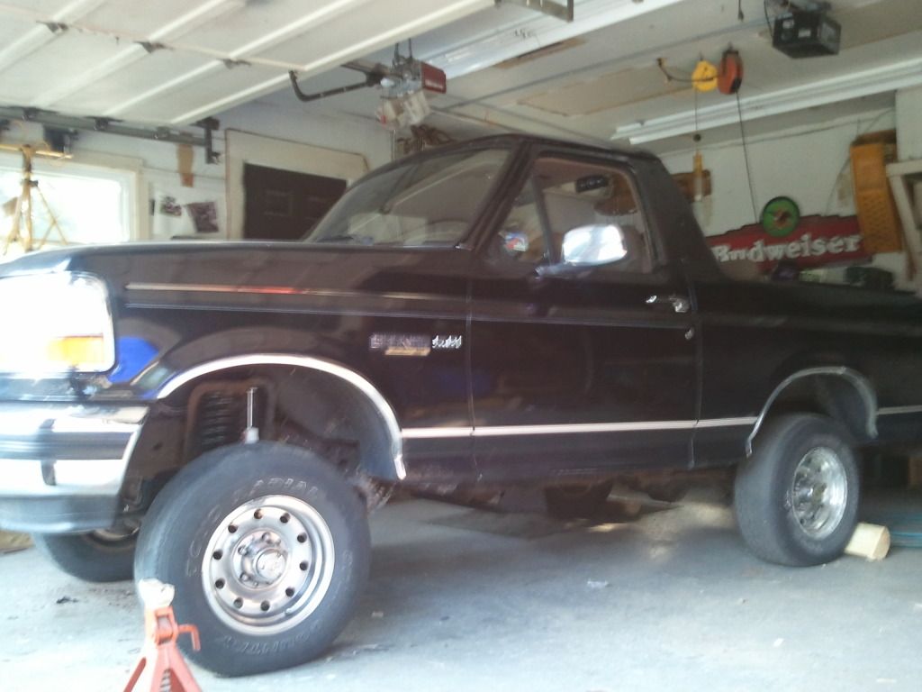

Alright folks, I can finally say I officially have a lifted baddass Bronco!
Total of 13hours of work,(some may say wow your slow, but this was the first time doing this), Surprising no one was hurt to bad, little blood from the knuckles but not to bad at all... I will say I am very very very shocked in how much lift I got out of this, It looks cool even on stock tires but I got a good deal on new 31"s that ill use for now....
Only thing now is that I ended up stripping a wheel stud and snapping another Of course right when you finish right lol, oh well thatll be another project this week. Anyways heres some pics. I ended up having an old coil spring that had a large piece snapped and was wedged in the top, so this new suspension was much needed.

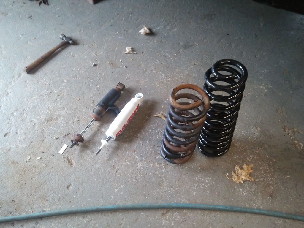

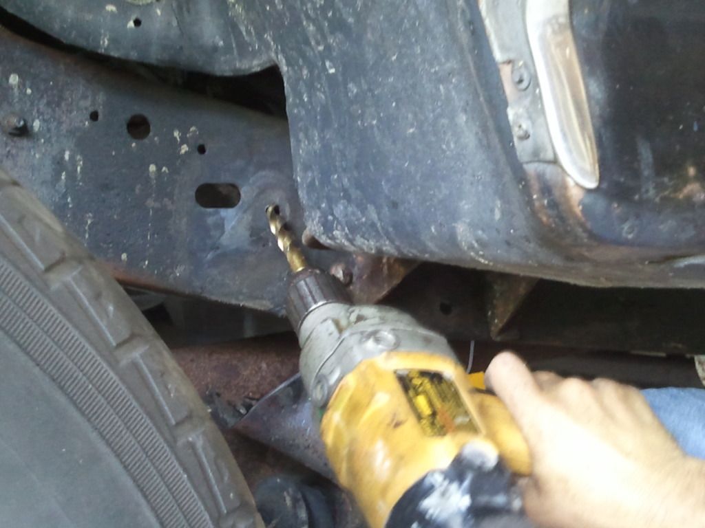

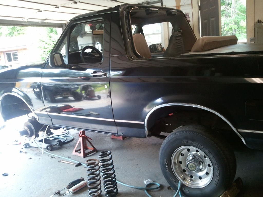

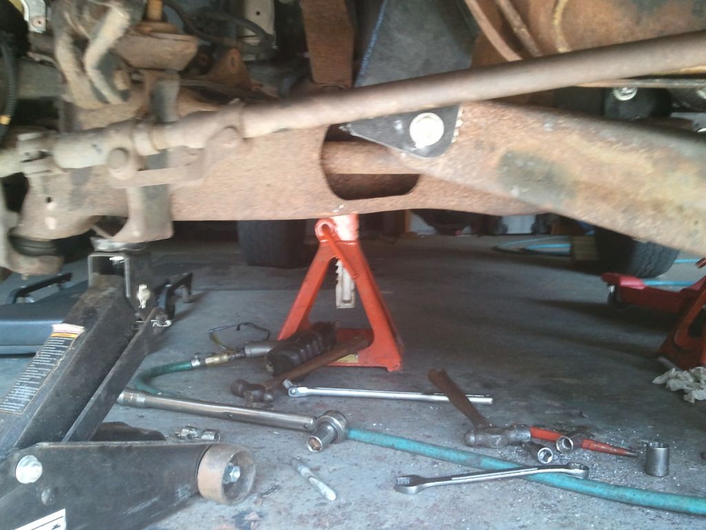

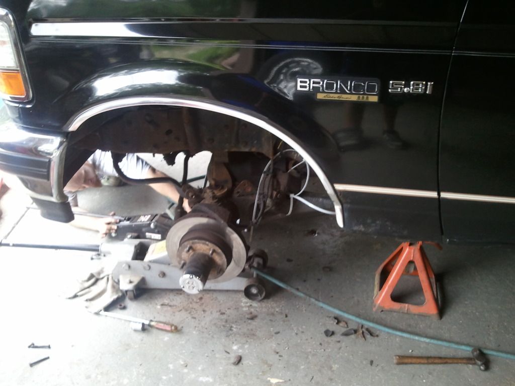

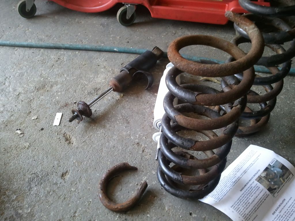

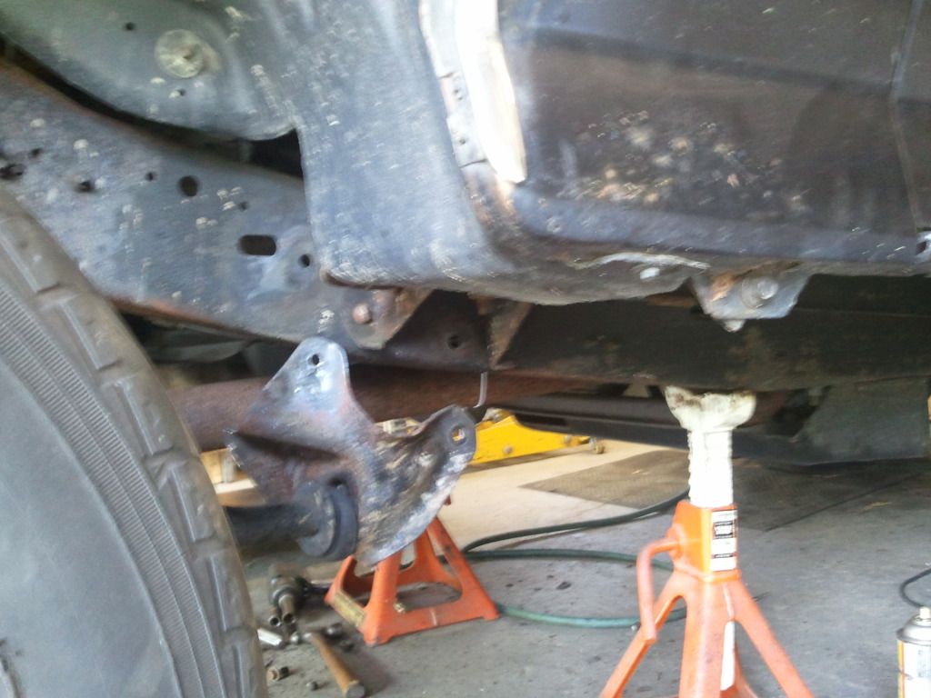

So here we go, going topless with the new lift. Rough Country 2.5" suspension lift. I will say pics dont do justice it looks much larger in person.
unbolted and punched out the rivets of the bracket
Heres the broken piece from the old coil
New pivot arm bracket installed and bolted up
Drilling out the holes to 1/2" for the new bolts

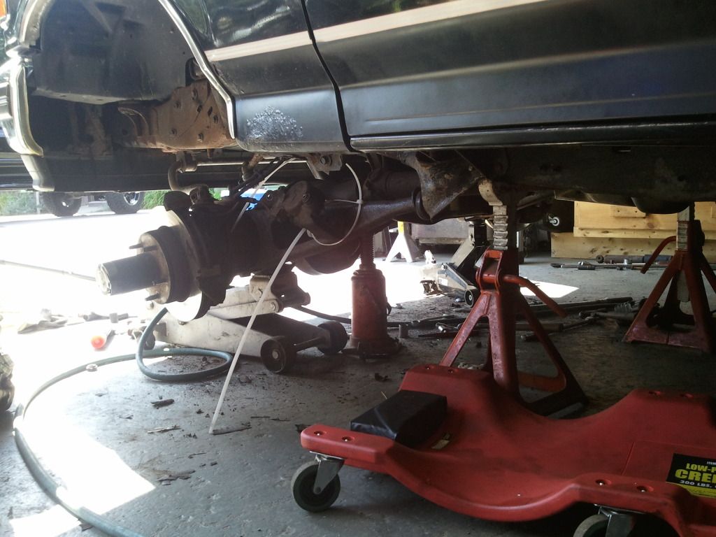

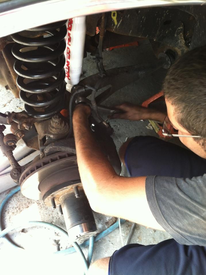

Front end torn apart, pivot arm brackets done and ready for coils and shocks
Front end complete rear end is next, Unfortunately I didnt take pics of the block install, this was the quickest process so it went so fast
Old and new
Tightening up the brake caliper
