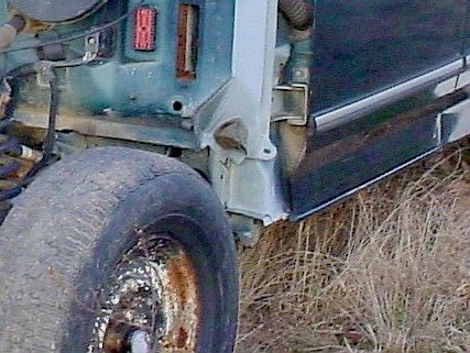

He got in thru the cowl drain hole. Worked his way up in the cowl. Thru the heater box and into the cab
The drain is a Little rubber boot. There is one on either side. The boots fall apart, get wedged open by debis, etc
here is one of the drivers side on.(fender is off in pic)

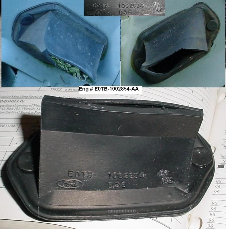

Not being able to come up with a part number got the best of me so I pulled one off.
Engineering number E0TZ1002854AA. I think the part number is E0TZ1002207A "Tube Cowl Side Vent Drain" but cannot confirm that.
