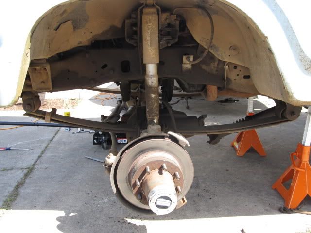

Well I managed to have a pretty successful string of three days on the trucks, despite a few things taking longer than anticipated. First and foremost, project TTB F350 is done! Oh wait, I was supposed to be doing project Dana 60 F250....? Day one started Thursday with both trucks sitting completely untouched as far as the swaps were concerned. I started in on my Cummins F250 first, getting the TTB and all associated parts removed in the 3.5 hours I had available to me.
The TTB preparing to find a new home:
Despite all the negative feelings towards the TTB front ends, I have to say that these things will hold up great with proper care. This TTB has seen 197,000 miles, the first 80,000 as a ranch truck, the next 110,000 hauling a camper, boat, hay, 11,000# trailer, firewood trails, christmas tree trails etc. Running my 33" tires it has not eaten tires at all.
Dropping the passenger side:
I started running short on time, so pictures took a back seat. I dropped the driver's side from the spring just the same as the passenger side, leaving the center brackets connected. Then I supported the center with the floor jack and carefully disconnected the center mounts from the axle. Once on the ground it was just a strong back exercise getting it out of the way. The flexing principle of the TTB makes it nearly impossible to move with a floor jack.
After getting the TTB out of the way, I set in to remove the springs and the TTB axle mounts from the crossmember.

Despite everything I have heard, I found getting the TTB frame mounts out to be pretty easy. As memory serves me, all it takes is a 15mm for the bolt heads below the oil pan and a 13/16" (possibly 7/8" can't remember off hand writing this) on the impact gun underneath. At first I thought I just got lucky and had more clearance because of the Cummins swap, but I found reinstalling them on the F350 with the 460 in place was just as easy?
Day two started with my F250 stripped and the F350 complete still. The first order of business was getting the F350 supported on stands and getting the tires out of the way.
Although I am replacing all the tie rods and bushings I decided to pull the pitman arm off still connected to the tie rods as I figured it would be easier to reinstall. I am waiting on my tie rod crossover to come in, so I'm swapping the old tie rods for now until the last piece gets here next week.
I then dropped the trac bar from the axle, but left the frame end and frame mount connected until the axle and springs were out of the way.
Then I dropped the driveline, as I pulled the springs and axle as one.
Next I dropped the passenger side springs and axle.
Followed by the driver's side and she's out:
I should have mentioned on both trucks, driving the caliper pins out and fitting them in between the frame and shock mount for safe keeping.
I then set out to remove the bushings from the F350 springs and from my F250 shackles.
I figured that my air hammer would do the trick. That's when the feeling of punishment for doing stuff the right way set in. I've read and talked to so many people that say how quick this swap is. Well, if you are simply swapping but not replacing that may be the case. I quickly realized that an air hammer wasn't going to touch the rubber bushings, as it counteracts all the hammer action. I realized that the only tool for the job was going to be the 15 ton press, which was 20 miles away at my shop. With that realization, I decided that day 2 was best spent finishing up TTB F350. All in all, I guess stripping the F350 of its Dana 60 AND getting the TTB D50 back in was a good accomplishment for day 2.
