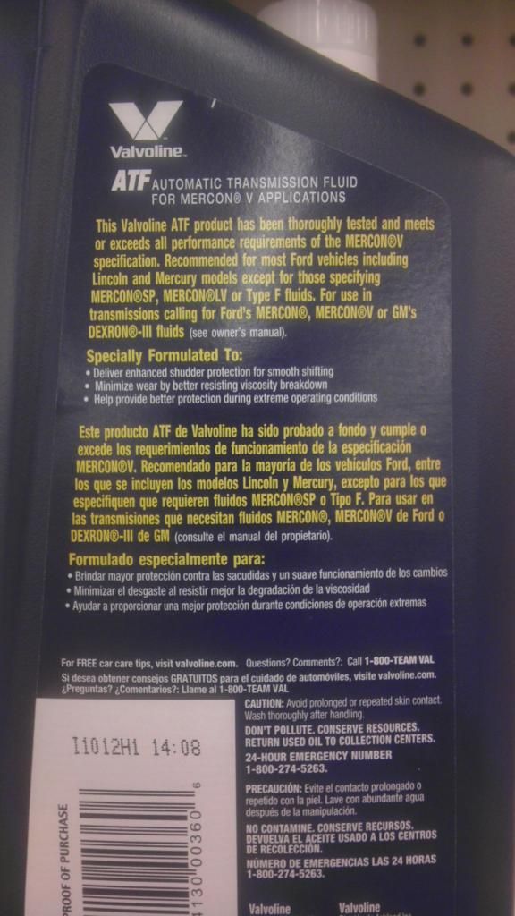

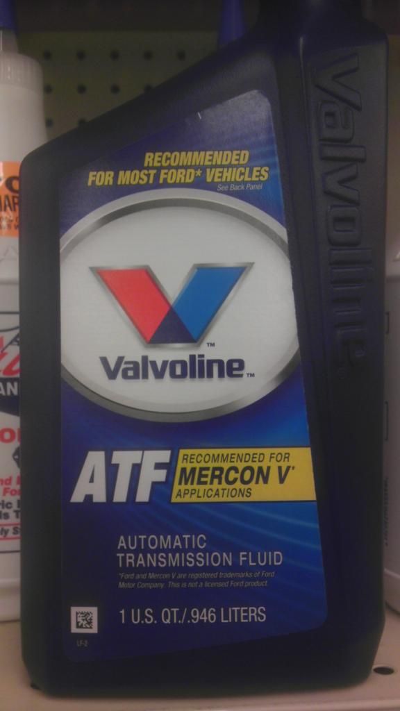

Mercon V
Bismic I just had the tranny fluid and filter exchanged with Mercon V . I put about 500 miles on it already...did I screw up? what should I use instead. Thanks.

Do NOT use Mercon V. Get the Mercon V fluid out of there as soon as possible. Have a "heated flush" done to get the fluid out of the Torque Converter (don't just drain and refill)
Use Mercon SP or Mercon LV

Bismic.
This is what it was put on the transmission. Should I take the truck to the dealer to do the hot flush and replaced the fluid ASAP (with what they recomend?) . I hope it is not to late. Also, I have a little over 1k miles already on it...not 500 like i stated before. Thank you all for the advice.

Wrong stuff - it said not to use it in vehicles that use Mercon SP.
Flush it out quickly.
