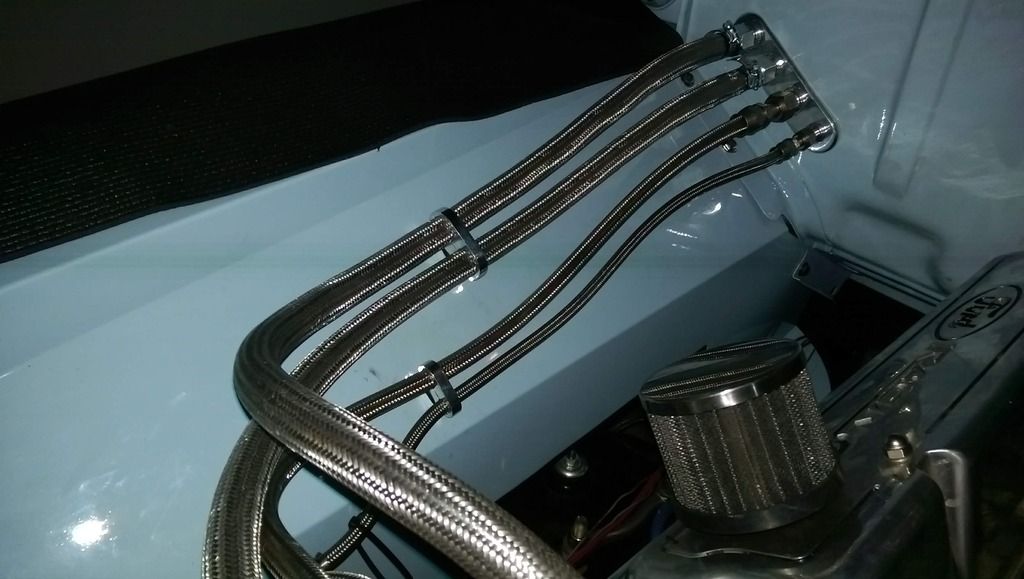

Where did you get those AC and heater lines, and brackets at?

The AC lines are Aeroquip. They are pricey but can be assembled with no special tools. The local rubber shop wouldn't press fittings onto braided line so this was the only way to go. The heater hose is standard braided line. I made all the hose myself. Inside the cab I used another one of their hoses but it uses a clip system. Both are made by the same parent company, Eaton. I used a vacuum pump from harbor freight for 30 minutes before filling. 2 years later I still have cold air.
The hose brackets are something i found on summit they are labeled as tubing clamps and are made of two billet pieces with a bolt the threads them together. I run the bolt through the inner fender and it keeps the hoses from chafing.
