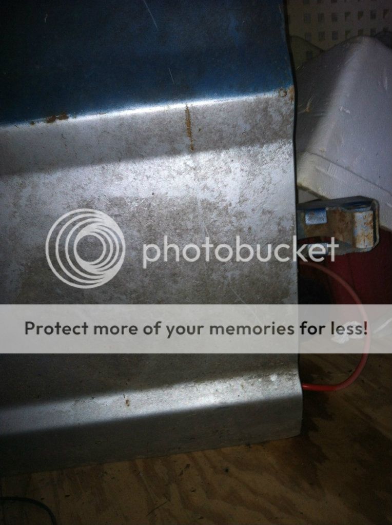

I picked up two doors and a hood today for 100 bucks. The doors were missing the hardware, but mine will switch over. There was only a little surface rust on them. They are perfect. All of the corners are good. I want to clean them up, prime them and put some sound deadening in the doors. All that i can get away with without causing problems. I've go to get the "anti-rattle" kits from LMC. I read a post or two this week ******* the LMC felt. They were saying it only held up a couple of years and started to crack up.'
Anybody got suggestions on that? (anybody know why iphone pics rotate on this forum)
My hood is solid, but has a dent or two. I failed to take pictures of it. I've got stuff going on my 03 project right now, but i did get some air-craft type stripper (lowes brand) to clean the hood and doors up for priming. My rotater cuff in my left shoulder is injured for now and i can't do much all gimped up.
