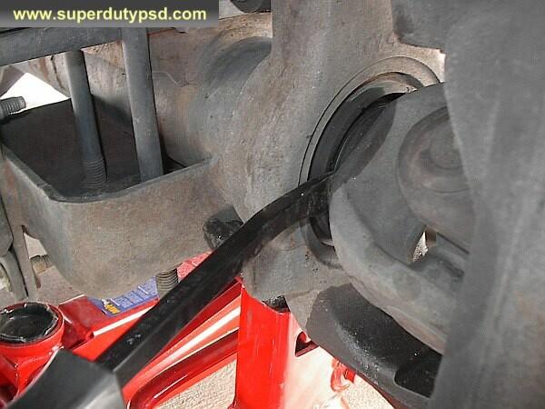

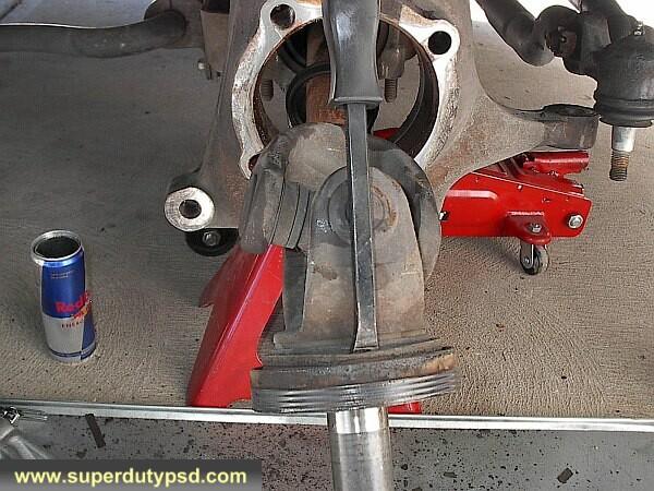

Absolutely everything was down to the last step (step 1 in the pic below) - simply "slide" the axle shaft out of the hub/knuckle so you can undo the two nuts holding the ball joints to the axle housing.
Well, the axle is free and slides out about 1/2", then stops. I "lightly" tapped it with my brass hammer - for about 20 minutes. Then I abruptly beat on it. Then I had to get out my 4lb hammer. Absolutely nothing will help me slide it out. Eventually I just removed the 2 balljoint nuts and the knucke is free but still can't remove because the axle will not come out.
Can anybody clue me in what I'm doing wrong here? Please help me get back on the road!!!
(Going to take actual pics, will post shortly, in the meantime here are some to help explain)
got to this step [1]:
Axle only slid 1/2" to here:
cannot get to step [2] here:
Here is how she sits:

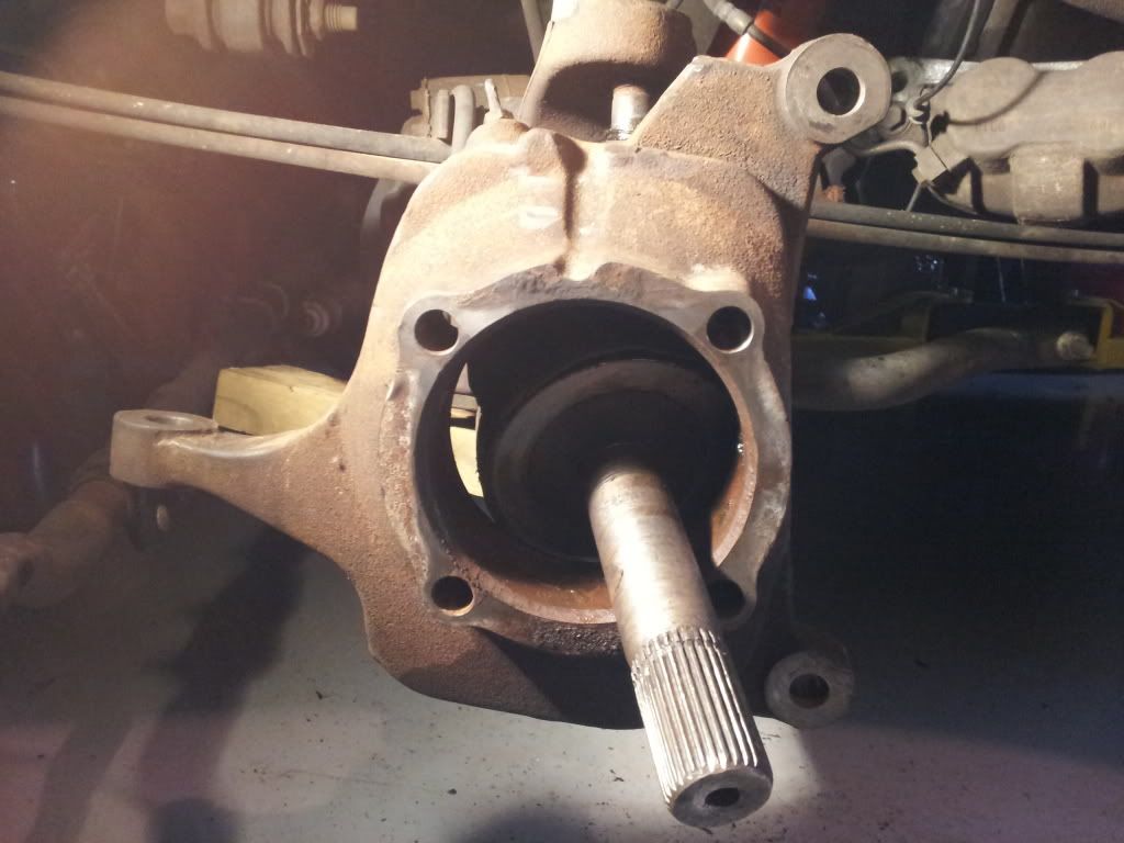

Tried every way to force it out, eventually the balljoints gave enough that the axle slid out BEHIND the knucle. Balljoint nuts are free and the knuckle will almost slide out - but axle is keeping it stuck in place.v

Well, I got it. Hopefully this thread helps somebody else in the future - my axle seal retaining ring was caught on a "lip" of corrosion (the only explaination I can offer) so it wouldn't slide out, only in. This made removing the knuckle with the axle in impossible with the balljoints in the way. I cut the top of the upper ball joint off, was able to remove the knuckle, then the axle slid out like butter.
I dont know any other way to do it than to cut off the balljoint, made it easy. What a PITA for a stupid little problem :/

aaaa isnt there a axel seal about 8 or 10 inches or some thing like that,,,, my bud at the front end clinic made then bought a seal puller cause one of his mech thought,,, axel was just stuck,,,,i see them use that puller on all solid axels now ( when they need seals)

Usually you have to ruin that big seal from the axle side by hitting it with a screw driver and hammer if the seal has been in there for more than 6 years...You need a new seal..

Sorry for the necropost but dealt with this today....
Quik trick- take a ball joint c clamp and press it out from the back-
Worked for me

Ya you just push the seal out from the rear with a bfscredriver. no way to save the seal..they get stuck in there after a month or so.
