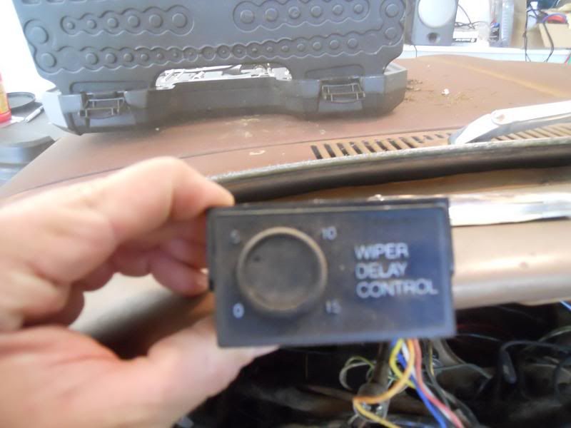

And the PO also added this, i plan on taking it out. Kind of scabbed in the harness. That will come later..

Keith, those holes in the floor arent too bad. I dont think I would bother with buying replacements of hunting some up in a yard. Just a couple of pieces of 18 or 20g mild steel with fix you up easily. Cut, patch, weld.
Looks like you need to get replacement center cab mounts, fix the running board/step area, and piece in a small piece of the floor with a piece of 18 or 20g. I have a few pics here of how I fixxed mine: https://picasaweb.google.com/1081911...17656077309202 Theres a few pics there of what I did.
Hows your front cab mounts look? If they are shot, avoid the the single piece stamped steel ones. Im still fighting with mine. Get the 2 piece version that used from the factory.
Of course alot of this depends on how handy you are with a welder, and sheetmetal.
