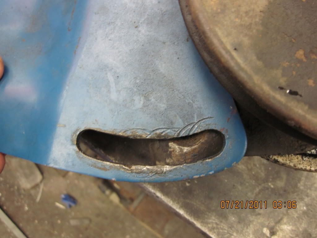

I checked my parts today heres what I found. This is the setup as it came on my 72 302 with metal resivior.
Here is the 302 engine bracket over top the saginaw pwr stereing pump and bracket off the 460. Sorry no go its a whole hole off
since the arc on the slot goes off the pivot hole the slot would probably not work it would get tight when you tru to adjust it. Sorry guys keep looking.
