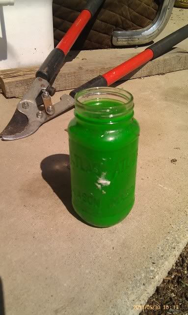

I recently put a different engine in my truck since the previous one shelled out two rods. The other day I noticed my coolant was a little low and as I was adding more I realized there was some oil in the overflow tank.
I checked my dipstick and didn't really notice much the oil was a little off colored but nothing terrible. So I let the truck sit for three days and pulled the drain plug this morning and out came 2-3 quarts of pure green coolant, then finally some mixed oil and coolant.
Here is a pic. Seriously this came from my drain plug!
So I pulled the oil cooler off and found a large flat spot on one of the o-rings. I had replaced them while the engine was out but re-used an old o-ring when I broke one of the new ones. So I think I'm going to order another complete kit and start over.
I'm hoping this will solve my problem, but is there anything else I should check?

Sounds like your on the right track.Never reuse old o-rings.At least you were paying attention and found the problem before you lost another engine.

Ethylene glycol is really hard on bearings. Really hard.
Good thing you caught this when you did.
