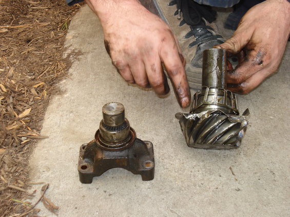

The TTB has its purpose but also its limitations. It allows for better road manners and for better offroading at higher speeds with the correct modifications. Its great for stock or mild applications. But once you start adding larger meats and higher gears you will run into problems. Its more complicated to lift a TTB truck than a SA truck, and the additional drop brackets required will put more stress on your frame.
There is no way a TTB will be comparable in strength to a D60 without a lot of money going into it.
Another thing with the SA is forced articulation. If one tire goes up the other is going down. Not so with the TTB so it wont flex as well.
Broken TTB pinion. 33s with stock gears.

Yeah, seriously, and what's the point of showing us tore up D44 gears? 78 Solid Axle or 1990 TTB, they're still both Dana44s and if I'm not mistaken have the exact same gears.
I also think people understate the strength of the D44 though, Jeep, Toyota and small SUV people swap D44s in to run 35s and 38s in rock crawlers all the time.. I've seen plenty of solid 44 housings break apart from jumping with 35'' tires, so I'm not sure that housing supporting all that weight is much better than a frame section in my Bronco (though I would love to reinforce mine), another bonus, we have huge TTB arms supporting the weight and the center pivot point is super strong, with the point in the frame being a cross-section that's easily reinforced.
I'd jump a TTB Dana44 long before I'd jump a solid axle 44.
if we're talking plowing through mud with 44'' gumbos and welded gears, no Dana44 is going to hold up to that, ever.
