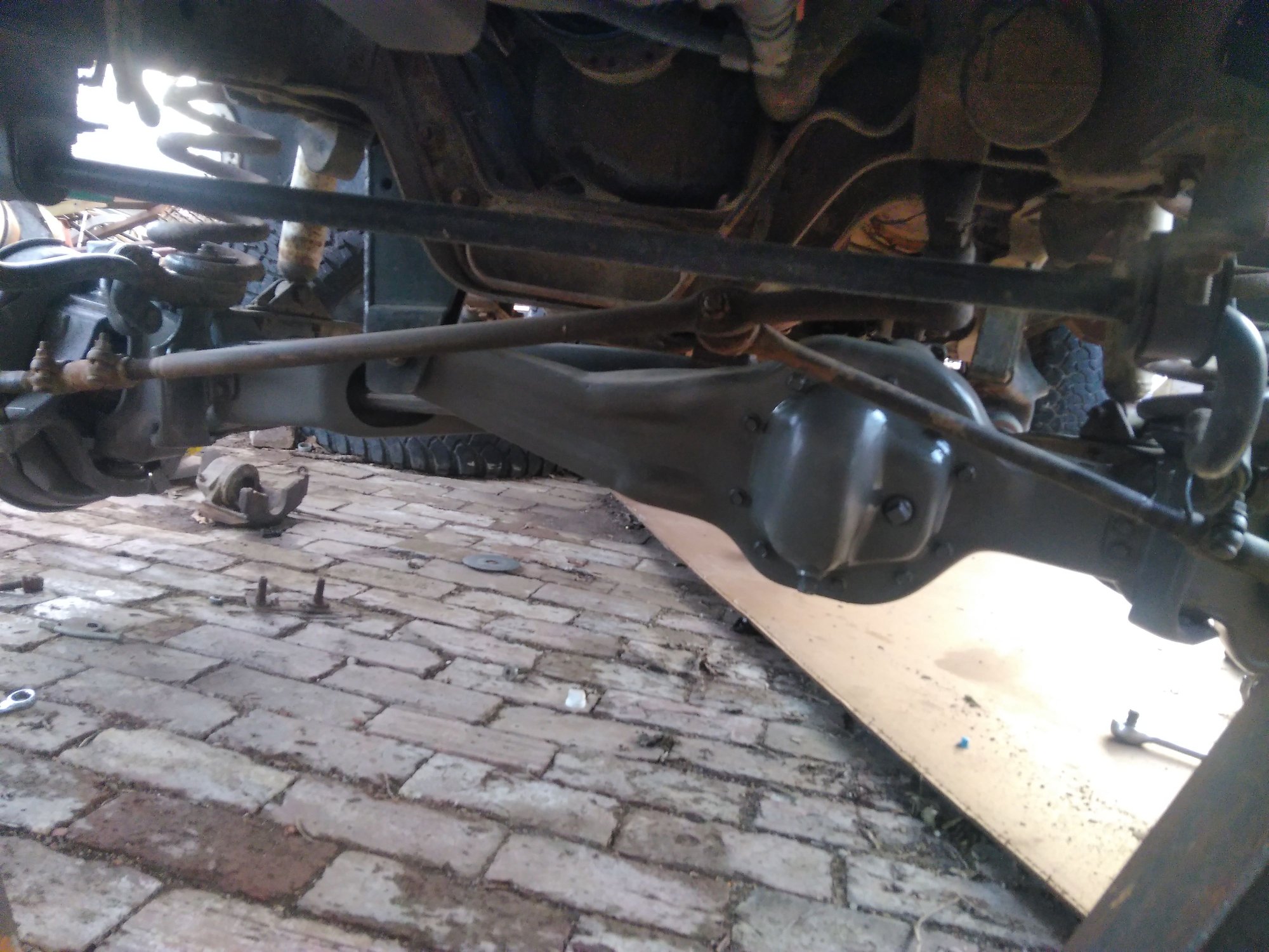

The D50 TTB modification really isn't to difficult! I have finally gotten my 91 silver ann back on the road after working on it on and off for 5 years. I went with the coils instead of leaf springs. Had to weld in the threaded holes for the radius arms and the drivers side half is something like 3-4 inches shorter than the D44. Currently have the D50 TTB front, 10.25 rear, 4.56 gearing, ARB locker in front and Yukon zip locker rear, 315-60-R16 tires. 94 5.8L, ZF 5 speed, NP205 with twin stick to round it out. Can't wait for the first blizzard to go plow some snowdrifts with it. I do know it will crawl up a rutted out MM road that a stocker wouldn't even try!

so you went with this route to get 8 lug front end?

I went this route for 8 lug front because I have the parts and the skills. Everything is from a stock 92 f250 so parts are easier to get.

I may have pictures of the modifications I did. I know I had a friend thread 4- x3x3 plates with a coarse thread. I then measured from the d44 to locate where to center the holes. Had to clearance the pads for the outer u-joints. The ring and pinion, and the axle shafts are beefier than the 44, and the disk brakes are larger to help stop the larger tires.

Originally Posted by greystreak92 View Post
Kem, 37-38's won't be good for any 1/2 ton axle. I personally understand the desire to have something stronger than a 1/2 ton axle under the truck. However, modification would be necessary even if the Bronco still had a solid D44 under it with that kind of unsprung weight.
Now if converting the F-250 TTB D50 to coil springs could be achieved cleanly and reasonably, that would be a viable option. I've never seen it done and a leaf sprung TTB setup is just beyond silly to me so I'm going to say I bet its cost prohibitive.
It can be done, really wasn't that difficult. I spent more on the locker and new gears.
