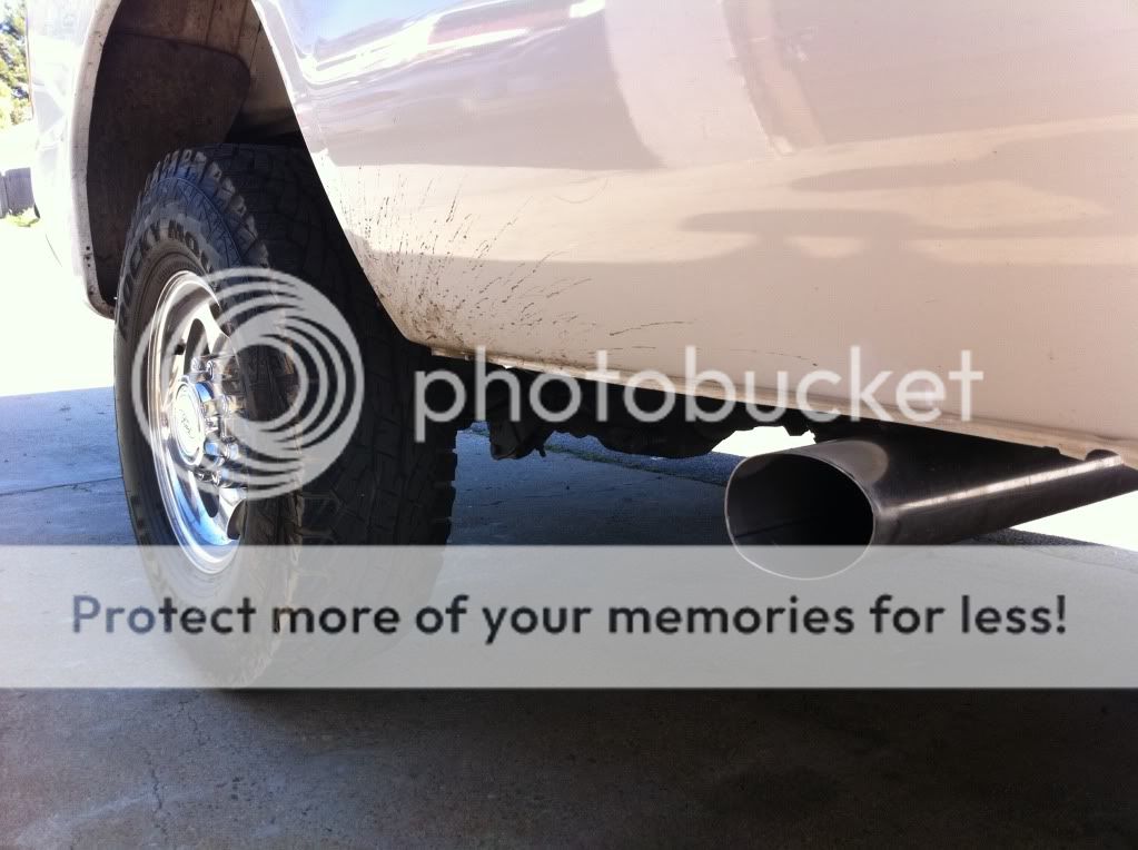

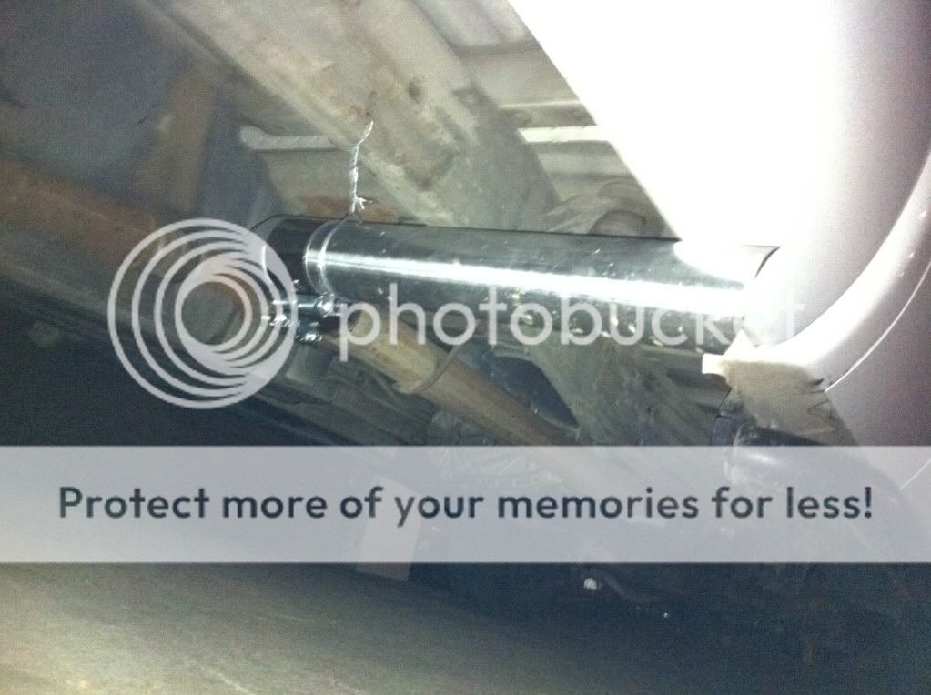

It started out as a way to potentially see some more MPG's with these horrible diesel prices and turned into a fun little project. It's a completely bolt on setup so that I can put the muffler on ever 2 years for kalifornia smog. I just ran an elbow/straight shot out in front of the rear tire.
My truck doesn't have catylitic converters from the factory and I have a 6637 intake so that helps the sound too. Other than that, it's all stock. I'll report back on MPG's but any improvement will be killed by the constant acceleration and wow effect at the exhaust symphony.
It's pretty loud with the windows down but it's not too droney on they highway when the windows are rolled up. If you've considered this cheap mod, I would highly recommend it!

My attempt at a stockish looking tip:
I didnt want to cut into my stock system so I just took everything that was welded after the clamp off. I did need to remove the spare tire and jack up the truck to get out this curved section/muffler over the axle all in one piece. This way I could simply put the new 90 degree elbow and new straight section on and reattach the stock section when it comes time to smog. I attached everything with strap clamps and a ghetto hanger I made of twisted wire.
I actually made the tip myself in about 10 minutes. I sawzalled about 2/3 of the pipe at a 45 degree angle and left part of it, just like the stock tip. I cleaned it up with an angle grinder.

I have an early 99 I gutted the cat on my own and took it to a shop and they charged me $40 to cut the muffler out, I left the stock tail pipe & exit. Definitely a power and mileage improvement not to mention it just sounds better. I seem to be riding around with the windows down whenever its nice out just to hear it.

I liked the straight pipe, for a couple months. Then it started to drive me nuts. Howling through camp grounds and the turbo whistle was insane. It didn't tickle my fancy and i thought it made it sound kinda of junky.
I put on one of these. Pass through, No restriction. The noise level is somplace in between stock and straight piped. With this on yours it would push your tail pipe closer to the rear wheel. If the noise level starts to bug you, Here is an option that looks like it could fit in with your setup. Dynomax Performance 24216 - Dynomax Race Bullet Mufflers - Overview - SummitRacing.com
Now, Stacks, they sound sweet !.
I just might do this. There are certainly a number of situations when this setup is just too loud. Thanks for the link - looks like a great middle ground and is very affordable.
I also see you have a toyo land cruiser. Just sold my 1991 FJ80 with 301k on the clock. running strong!
I have 4" turbo back with a magna flow and it sounds good. I thought about straight pipe but am leaning torwards keeping it on now. I too think it would get old after a while, but sound great at first. I'm 42 so i'm kinda old too though If I was 22 I would have that thing ripped off so fast your head would spin!
