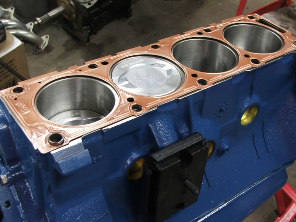

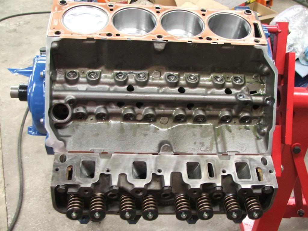

Hey guys, got my 428 all togther now. But having issues.
I used the Mr. Gasket MRG-1132G metal gaskets. I sprayed liberally with copper spray and torqued and sequenced and numbered according to Steve Christ FE book. 1st pass 70lbs, 2nd 80lbs, then final 90lbs with time in between. THey are thin at .020". Blocked decked .007. Heads milled .005 or better. Now the intake doesn't line up flush.
Install went real smooth until I was breaking in the cam and noticed a nice steady stream of oil coming out of head on drivers side. Appears to be the headgasket not sealing the oil passages!!! I checked the torque and it was down to 80lbs on a few of them. I doubt it's stretching. The intake doesn't meet with the heads flush anymore. It's gotta be an intake-to-block-to head oil leak..

It sounds to me like the re-use of the head bolts could be the problem. With the thinner head gasket everything has to be more precise since you don't have as much crush in the gasket to take up the slop. 10 ftp doesn't sound like a lot but it could be just enough. I have always been told that any time the head comes off the head gasket and bolts must be replaced. Unfortunately replacing the bolts you may also have to replace the head gasket since they have already been crushed. I know, more money and a pain in the ***, but it would be cheaper than re-using the ones you have and just finding that you have another leak because of it and then having to buy another set of gasket and another set of arp bolts. That's just my 2 cents anyways. By the way, give looking motor, I want one I like what you did with the stainless braided fuel line, very clean looking.

Well, I for one, am really getting sick of this hobby. I have had so many issues with FE's over any other engine. I have got to figure out what in the flying $%& is the matter. My time and money is on this planet is getting worn thin. I've really just about had it with it all.
Confirmed it's the headgasket leaking OIL. How in the HELL IS THAT POSSIBLE?! I made a video so all can see and believe. It's leaking in two spots directly from the the head gasket.
I retorqued the headbolts. They were down 10-20lbs after the heat cycle. Keep in mind this 428 only has about 25mins of runtime on it now.
And ANOTHER g-damn issue is I keep getting loose rockers! I dunno if the lifters are dying from lack of oil or what. The only carry over parts from my 390 are the heads, intake, and adjustable rockers which have about 10k of use on them. I swear on everything thats holy these heads are cursed. I'm about ready to drop the $2000 bomb and have rob (blue oval) build me some alum edelbrocks if I can't get this problem fixed soon. I had the same noises with my 390 all those years. It's gotta be these heads are the problem..
Check out the video and please tell me what you guys think.
YouTube - TuxIssues

Damn man, that sucks, I feel for ya, I know how it is to have an issue and not be able to figure out what's wrong. But its such a good feeling when you finally get it. I know its basic and not trying to insult your intelligence, but did you check the block and head mating surfaces for flat before installing? I know its basic but I have forgotten simple stuff like that in the past and just about pulled my hair out because of it. As far as the sound and rockers not holding torque, I have no idea. I watched your video and I could be wrong But it sounded like only a couple rocker arms where loose. Any chance the adjusting bolt on those ones are loosening up? Hopefully this helps with one of those little light bulb over the head moments

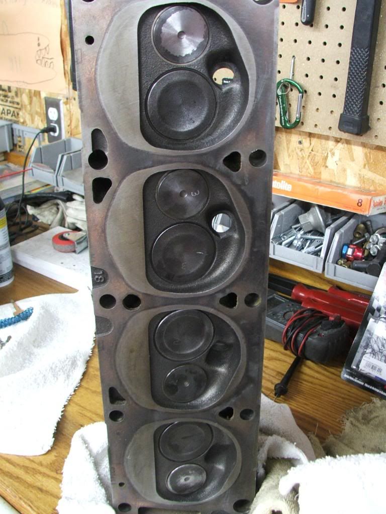

Does the gasket oil hole line up with the block and head?
Was the deck/heads resurfaced for the type of head gasket you are using? MLS gaskets are a bit more specific on how flat things are.
You have the rocker bolts in the right place, yes?
You have hydraulic lifters yes? they could just be bleeding back.
good luck, don't loose the faith, and FE's aren't any easier or harder than any other engine.

Block was fresh decked. Heads milled 20k miles ago. Rob checked flatness of heads when he assembled, said they were fine. Not sure if oil holes lined up or not. Can't see in picture.
Yes rocker bolts in right spot. Necked bolt on oil passage 2nd from front (LH) and second from rear (RH). Oil holes on bottom of shaft. I've tried with or without holley jet restrictor.
So far these headgaskets are the biggest piece of #$$% I've ever wasted my time and money on.
