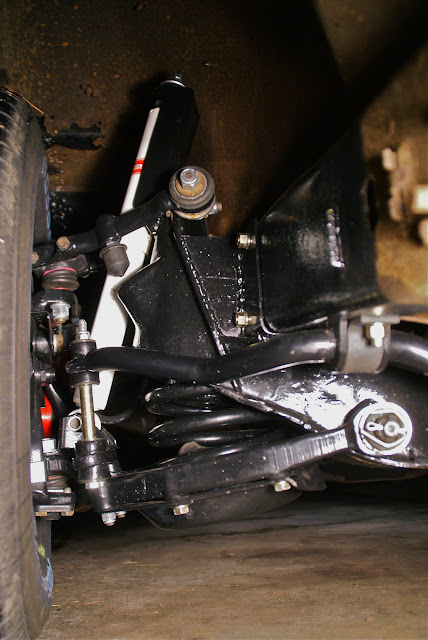

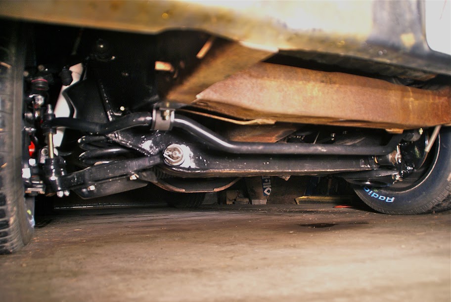

I finished a Jag XJ6 swap into my truck a few months ago. I can tell you that its an incredible front suspension. Very tight handling and road feel, and plenty strong unlike some of the MII setups...
It also looks fantastic. The fenders hug the wheels just right now. I am 100% satisfied.

Old Jan 18, 2011 | 02:07 PM
matt2491's Avatar
matt2491
Joined: Oct 2007
Posts: 773
Here's a couple..

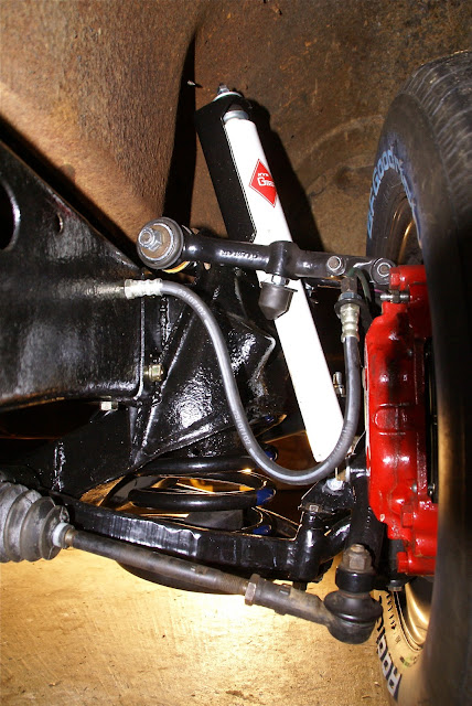

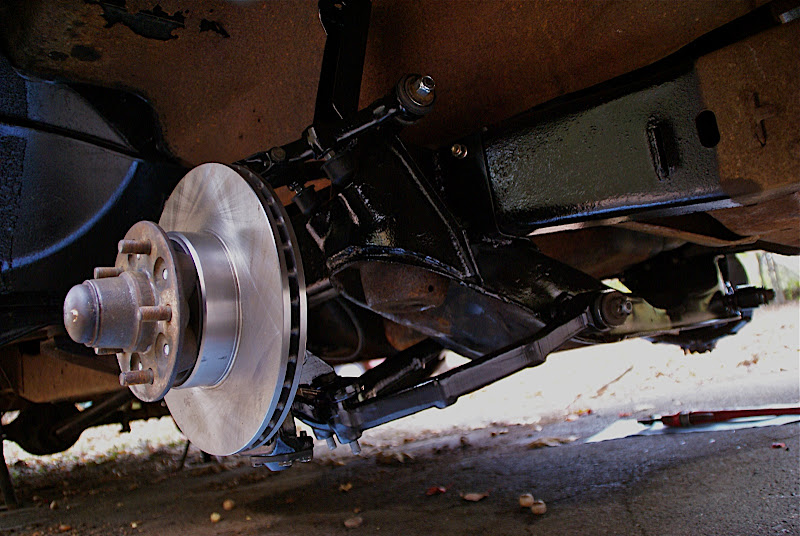

Old Jan 18, 2011 | 05:01 PM
matt2491's Avatar
matt2491
Joined: Oct 2007
Posts: 773
Okay, a few more shots.
I have a lot of information on this swap for those interested.
