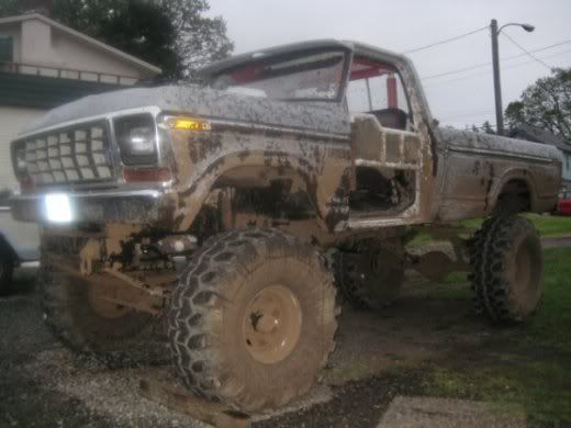

[quote=Ronzi;9592491]You will deffinitly need more than 6 inches.
This is my 79 F350 with 6 inch lift and it barely fits the 39.5's
Did you have to do anything with the drive shafts?

[quote=1979F350/460;9593235]
Quote:
Yes, I had to have longer shafts made.

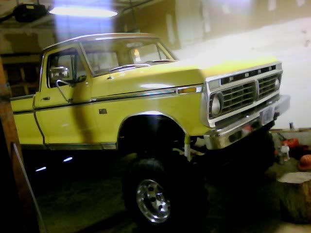

VERY NICE! AS FAR AS GOING OVER 9 INCHES OF LIFT? I HOPE ITS NOT YOUR DAILY DRIVER. I HAD A 1 TON WITH 44'S AND 5.38 GEARS. AND NOT NEARLY ENOUGH MOTOR TO MAKE IT ALL WORK.
Why couldnt it be your daily driver!!??
Mine was when it was last on the road before I tore the 390 FE out to be replaced with a 428 cj but it still wasnt way underpowered it was fine. What were you running a 351 or 360??
This is when I had it on the road last about 8 months ago
This is how it currently sits with new body and doors this time. Definetely streetable and drives like a dream with the hydro assist steering,4 wheeld discs with a 2000 superduty hydroboost setup for ultimate braking. I would drive it an hour on the highway, wheel it hard all day long then drive it home that night most times I took it wheeling. You just gotta have it built right.
