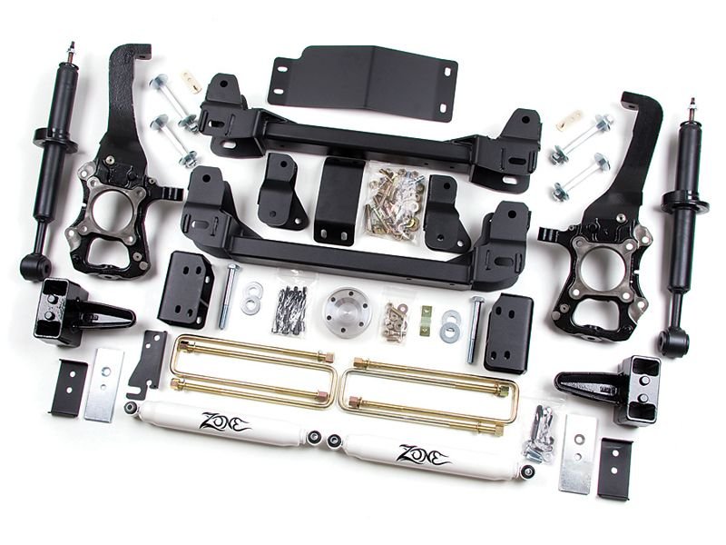

Zone Offroad
Price: $1,549
Front Lift: Replacement struts, OEM coil
Rear Lift: Suspension blocks
Warranty: Limited lifetime warranty
Zone may be one of the newest, but by forum response it looks like they’re the up and coming underdog. Their lifts are affordable and of good quality. These kits use a tapered block to help re-center the rear wheel into the wheel well. They also use a full replacement strut that reuses the OEM coil, so no spacer up front. Unlike the Skyjacker kit, your truck will retain the factory angles, which allows you to add a small spacer up front to go higher if desired. Unfortunately, Zone offers no warranty on the kit. Recommended if you don't want to spend extra on a lift kit just for the warranty.
