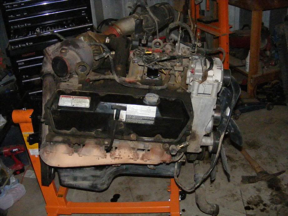

Hopefully I am posting in the right spot, but I wanted to share pics of the swap I am starting! I found a donor truck (97 F-250 7.3 DI) to swap out the engine and everything else into my 94 F-350 (5.8). My truck just doesnt have the power and economy that it needs to have for the work I do! LOL! As a person can tell, I am working on it one piece at a time!
I originally picked up mine for a steal, but it had some issues. Low mileage, 120,000, e4od, and so on, but its an XL, and has no options. The fenders were cracked, then they got finished off by my horses eating what was left, LOL! It didnt come with bumpers, and had been "used". So a part here, a part there.. its coming along!
The donor truck, has the 7.3 DI and auto trans, 4 wheel drive, AC, PW, PD, Tilt, Cruise and so on.. So all thats coming off of it and going on mine!
Enjoy the pics, more to come!
The donor truck and motor..
The engine before I started this morning..
And after a couple hours..
The garage filled up quick with all the parts so far that I will need to do the swap! Cool thing, I have a Catapillar Mechanic coming over to replace all the seals and O-Rings in the engine before I drop it into mine. We will be replacing all the seals and all that good noise prior to install. What was nice, was the donor truck hit pretty hard, had three flats, and the rear drive line was disconnected, but she made it in on her own steam to the garage! I did replace the GPR as the plunger wasnt dropping in it, I have an idea i will have to replace the CPS as well, since its a huge PIA to get started. But it never smokes!
I will keep updating pics as I go!

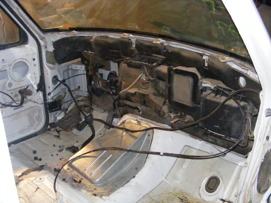

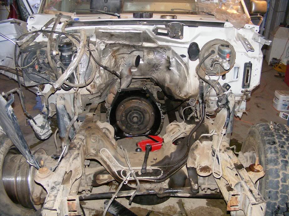

UPDATE...
Well, I finally got another minute from the working world to escape into the garage! I got back to working on the removal of all the goodies! I also picked up one of those cool little fuel line tools.... WORTH every penny spent! Came of quickly!
But here's where I am at now..
I finally got it out!
Also got started in the cab for the electrical swap (power windows, door locks, so on) and the HVAC system. I am sure that you noticed that the evaporater and condenser are still attached to the heater assembly, with the engine gone. I wanted to see if it could be done, this way I dont have to recharge the system. So far so good!
The ductwork for the heater assembly was a PIA! And the dash itself.. there were two bolts, one on each end, tucked up and away next to the door frame, that you have to wrench out a little at a time!
And finally.. The gold!
Wooo, I have been dying to get this thing out so i can start working on it!
Something else I learned today: I found on the internet that the 7.3 weighs in at 944lbs wet. I am not sure if there were things that were not accounted for, but I picked up a 1000lb engine stand, figuring that might do the trick. Its holding, but boy, you can see that the weight is pushing limits!
The To-Do list now: Finish getting the transmission and transfer case out, mounts and remainder of the items I need to complete the swap. Thats a long list! I also ordered up the master 0-Ring kit to replace all of the 0-rings on the engine, that will need to be done. I already started cleaning up parts, so it should not only be clean but leak free! Whats amazing, is when I first started this project, I thought it was going to take quite some time with everything I want to use for the swaps. Surprisingly enough.. its really pretty quick and fairly easy. I didnt clip a single wire, strip a bolt, or bust any plastics! These things are a dream to work on!
