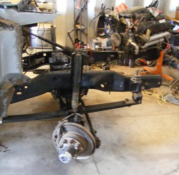

The 4-wheel drive is about finished. I had some fun with drilling the crossmember holes for the D-50, went through some bits, but finally getting the last of the holes drilled. I did bolt up the passenger side of the axle, as the mounts are all bolted on. Where they were originally held on by slugs, I replaced with grade 8 bolts all the way around. Once the axle is on, I can drop the truck finally, and get the trans mounted, along with the engine. I didnt want to put the tranny on yet, because of the 4-wheel drive install and working all around the frame, and the weight of the truck once I drop the engine and trans would also make things a little more difficult.

Good News: The D-50 swap is about finished...
I have the D-60 hubs in the mail coming, then I can get them put on, driver side shock mount to finish, front drive line, and brake lines to attach up. Thats it! The axle has been bolted up and is ready! Now I can move forward with the rest of the project! Yay!

Yup, its actual D-60 Dually hubs.. Which just to mention.. Are a true PIA to find! Fortunately someone here had some sitting around and sold them to me! Whew! LOL! From everything I found and researched, I can swap out hubs on the D-50, with D-60 hubs, then later on when I find a good deal on a D-60 axle, I can swap the hubs again, because chances are I wont find a dually D-60.
