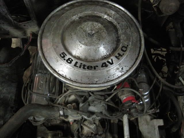

5.8L 4V H.O. huh?
Well good to see progress on the truck, its coming together nicely!

Yep, traded my buddy for the stock one off of my air cleaner a while back, he needed the flat 70's one for hood clearance in his Heep... LOL
You'd be suprised how many people see that and ask "so that's a 351 in there huh?" LOL
