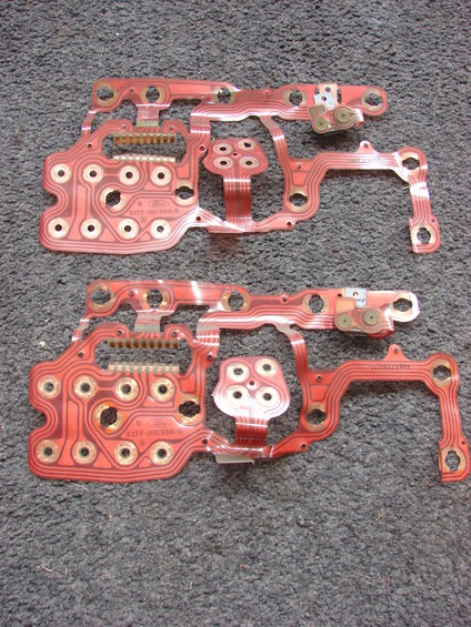

hey, if my truck came out of the factory without a tach, did they leave the wires in for it?
or would I need to wire that...

just put it in it will work. you may have to ground it for a V8 though.

You need to change the circuit film on the back of the cluster too.

I could prolly send ya one of those circuit films, I'll hafta check in the garage after
work tonight.

Circuit Film?

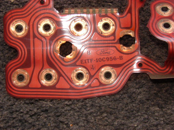

One of these:
Your existing film will not have the section in the middle with the 4 contacts for the tach.

oh.
Ok.
Looks like fun haha
